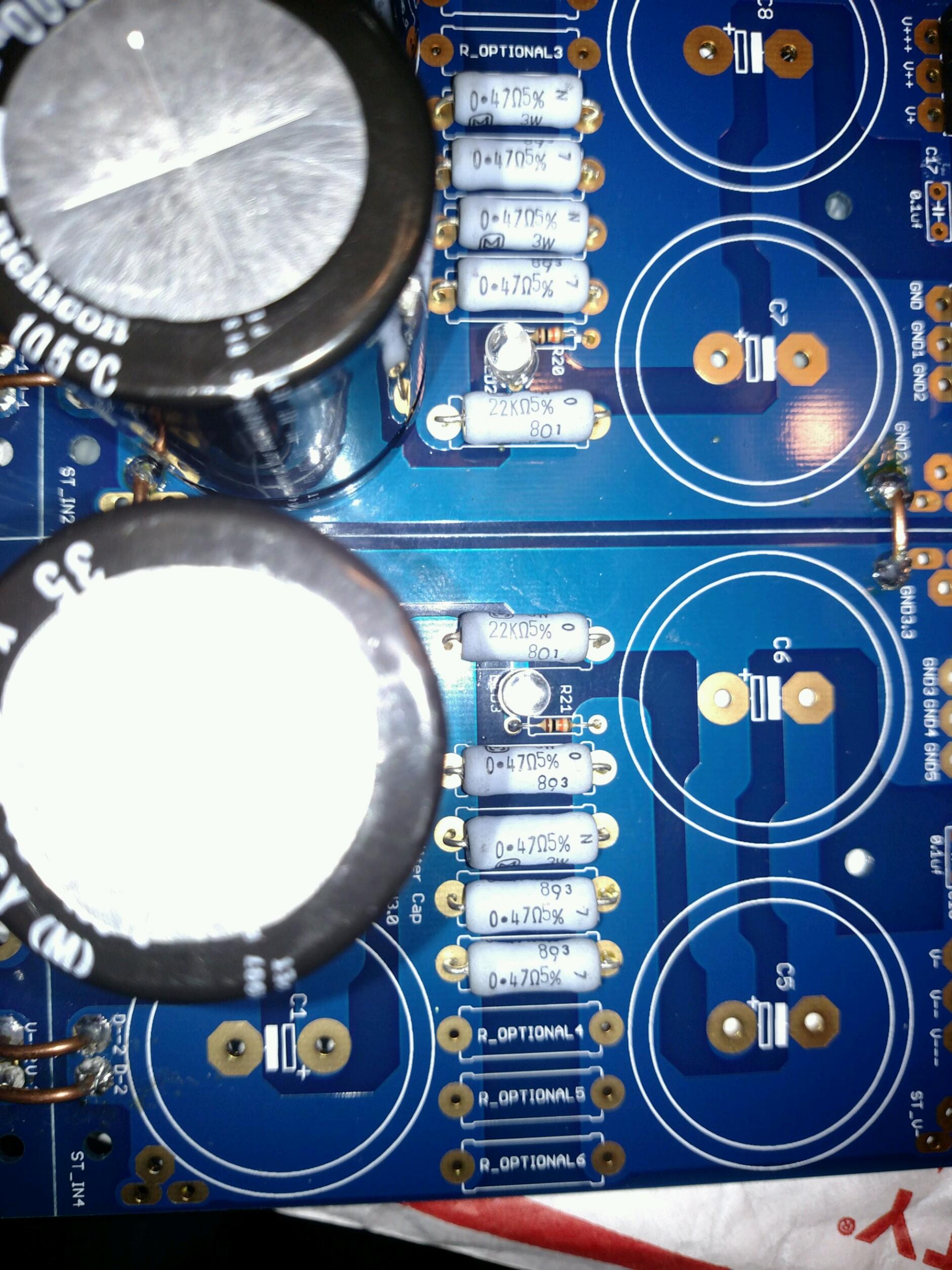

After soldering the output boards and then, doing further research, I have saw posts that keep the 3 watt resistors off the board.
Unfortunately, I did not do that.
Parts of the resistors touch the board.
Will I be ok running it like this or would it better to order new resistors and doing some desoldering.
Should clarify R7 and R8 on the F5 boards, I am going to run them the way they are, might not be optimal, oh well.

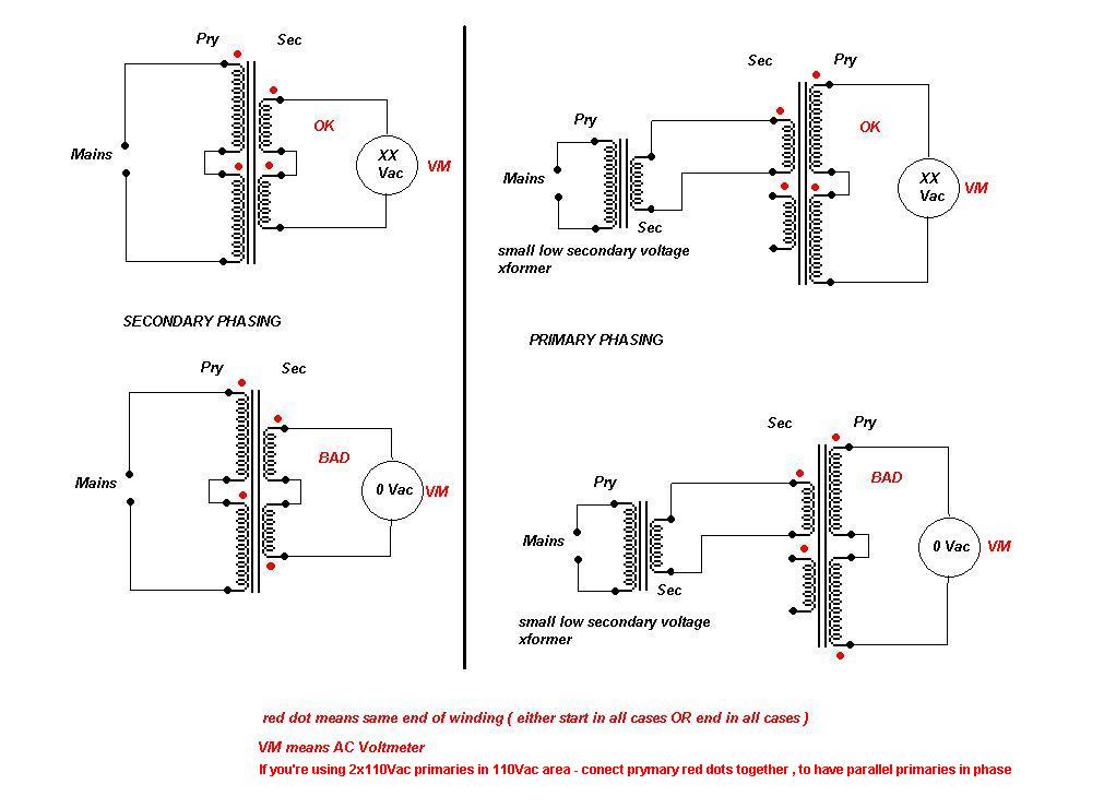

Things progress, I recieved the transformer but I am a bit puzzled.
The 4 secondaries are 2 blue and 2 red. I tested between blue and blue as suggested by the sticker on the transformer , I found the proper voltage 18v ; but I found a similar reading between red and blue !!
I will go as per the sticker, blue for one channel, red for the other but I wonder why I get a reading between red and blue.

What is manufacturer of transformer. Do you have a link or can you post a photo of the sticker?

I redo my testing just now.
Between blue >18v
Between red > 18v
Now there is 4 possibilities between red and blue, two are 18v and two are virtually zéro.
I guess it is normal.
Between blue >18v
Between red > 18v
The blue is one pair, the red is the other pair.

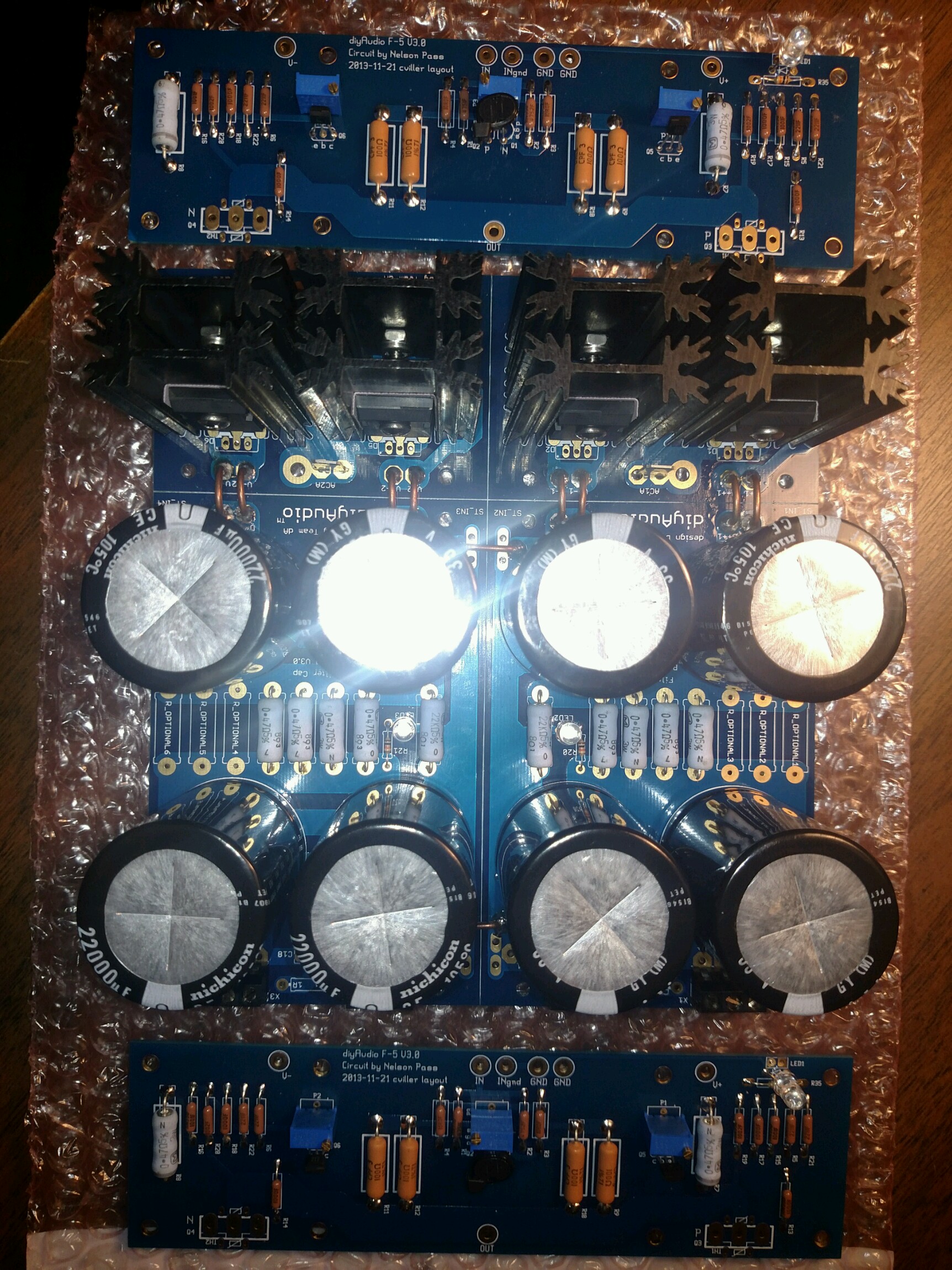

Got all of my boards soldered together to the point of needing a chassis anyway.
Had a surprise when loading the caps on the PSU board, one of the LEDs lit up and burned for around 30 seconds or so, hope that is a good Oman.
All I need to do now is money up for a chassis.
