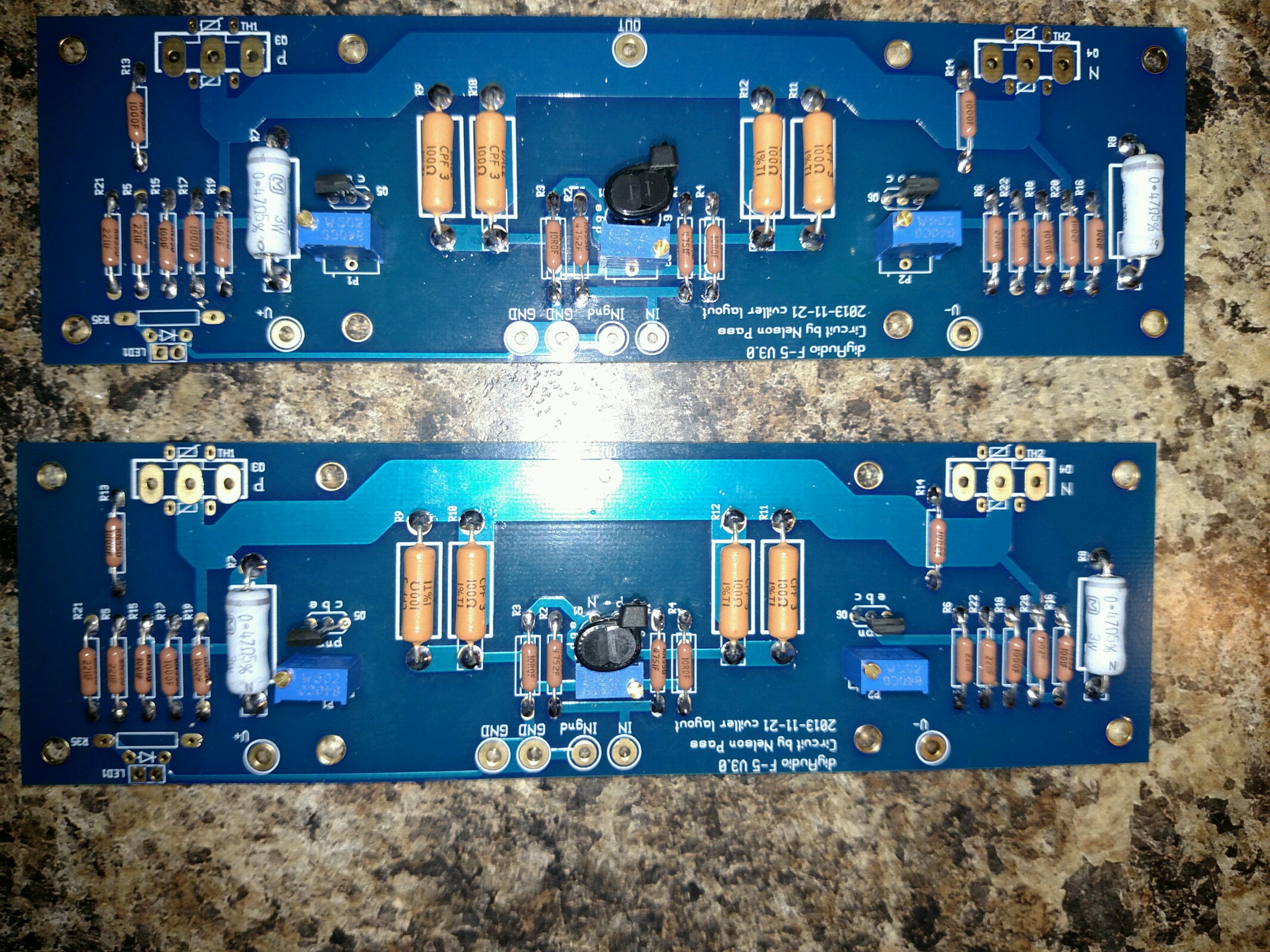

Had a little free time today so I managed to get most of the Dale resistors mounted.
I would like to thank 6L6 for his pictorial guide, that was a big help, hats off to you sir.
Had to use my readers and a magnifying glass to read the values.
Verify, verify, verify, install.
So I can officially say I have started anyway.
I can not wait to hear this amp, already have a whole bunch of albums lined up.
Thanks to all of you guys who have given me guidance
Managed to get the two channel boards almost finished, save the thermal resistors ,the LED and its resistor.
So now onto the PSU, I have both Nichicon and Vishay 22000UF caps.
493-8646-ND Nichicon rated at 5000 hrs or 4645PHBK-ND Vishay rated at 2000 hrs.
Just wondering from anyone who has ventured down this path before me.
Thanks, Greg

Just to be clear, I meant the 2 single channel boards.
