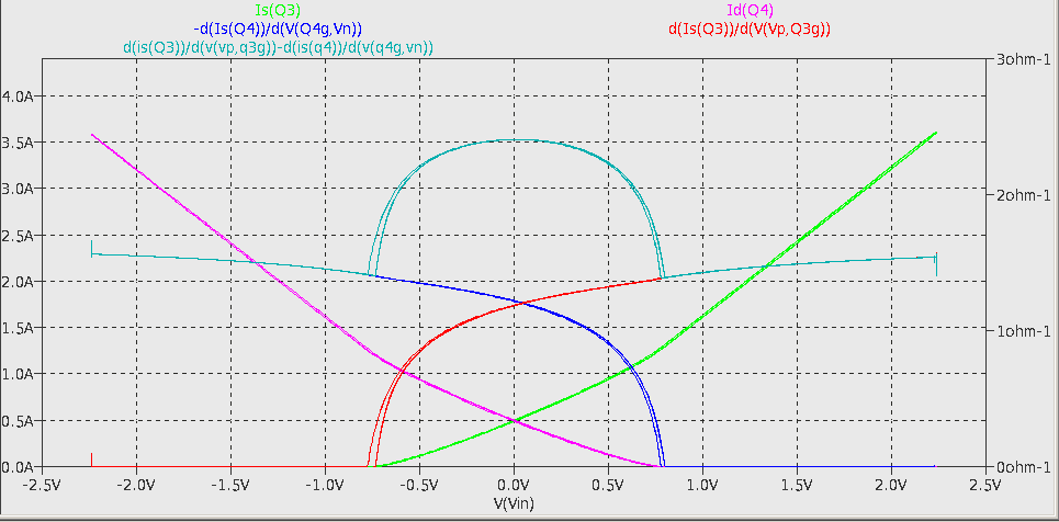

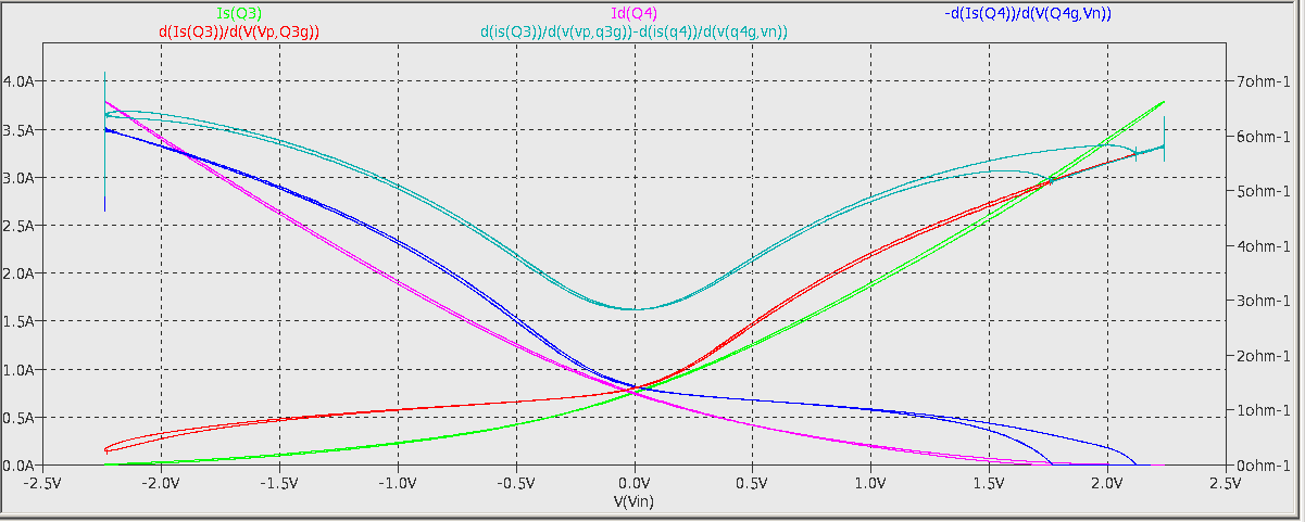

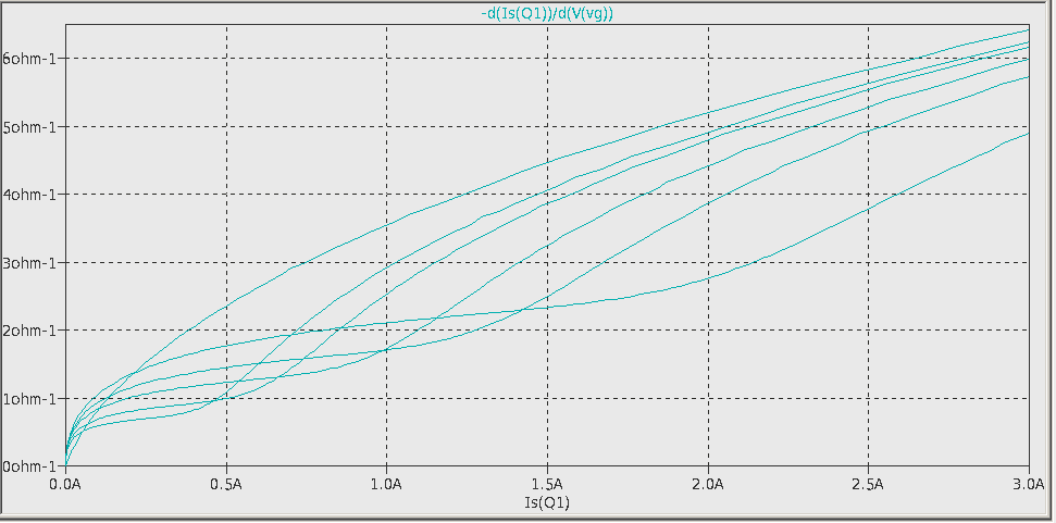

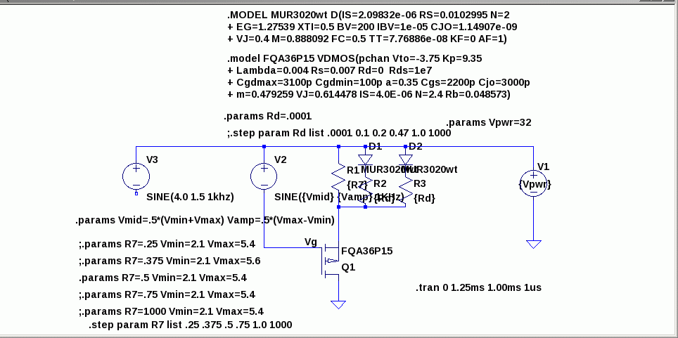

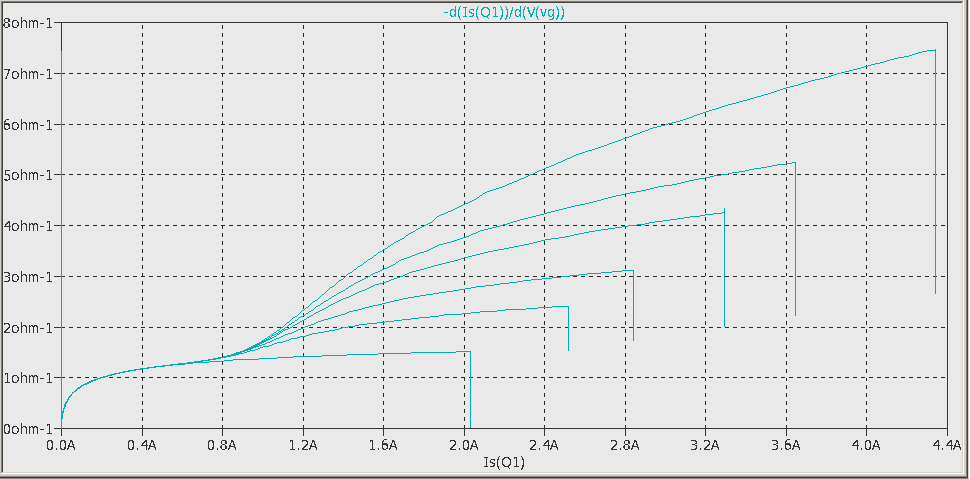

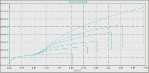

More transconductance plots
Here are some more transconductance plots.
First is the LTSpice Circuit.
Second is an plot of output stage transconductance vs. drain current for a variety of values of the source resistor R7. From top to bottom on the right side of the plot the R7 values are: 1000, 1.0, 0.75, 0.5, 0.375, 0.25 ohms.
Third is a plot output stage transconductance vs. drain current for R7 = .5 ohms and a variety of resistance values Rd in series with the diodes. From top to bottom the values are: 0.0001, 0.1, 0.2, 0.47, 1.0, 1000 ohms.

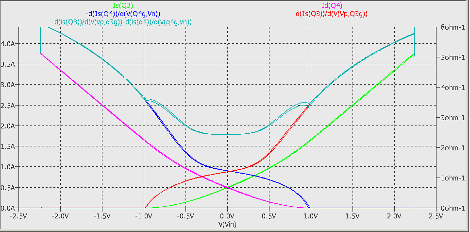

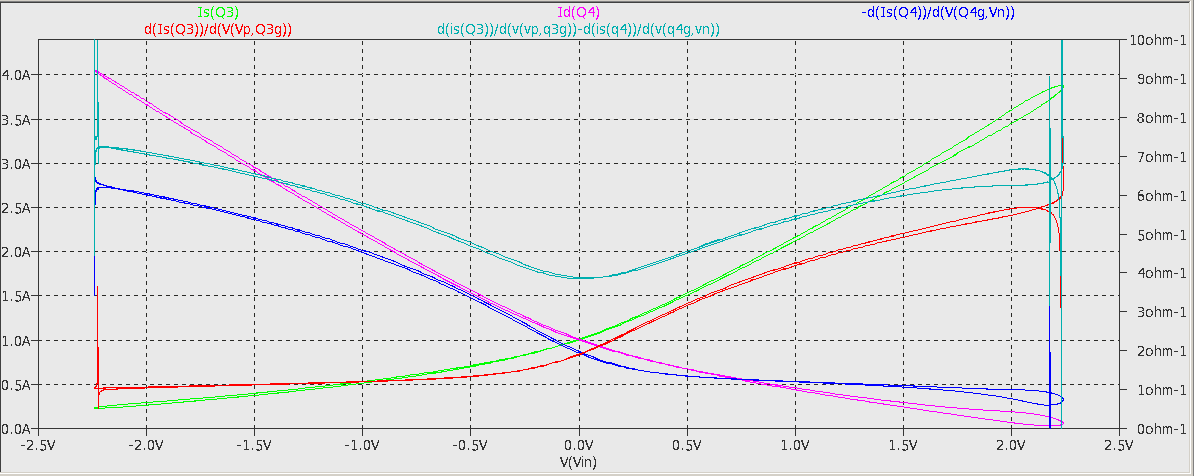

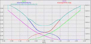

More curves
In a push-pull output stage, it is important to look at the combined transconductances of the P-fets and N-fets. I have generated such plots which I present here.
Each graph contains 5 curves:
Green and violet are the P-ch and N-ch device currents respectively.
Red and Blue are the P-ch and N-ch device transconductances resp.
Cyan is the sum of the device transconductances.
Multiply all of these curves by the number of MOSFETs on each rail.
The 1st curve is the F5 Turbo V2 at 0.5 amp bias per MOSFET.
The 2nd curve is the F5 Turbo V2 at 0.75 amp bias per MOSFET.
The 3rd curve is the F5 Turbo V2 at 1.0 amp bias per MOSFET.
The 4th curve is an F5 without the Turbo diodes at 0.5 amp bias per MOSFET.
The combined transconductance curve (Cyan) obviously benefits from higher bias.
The 4th curve clearly shows the "clunk" that occurs when the amp leaves class-A.

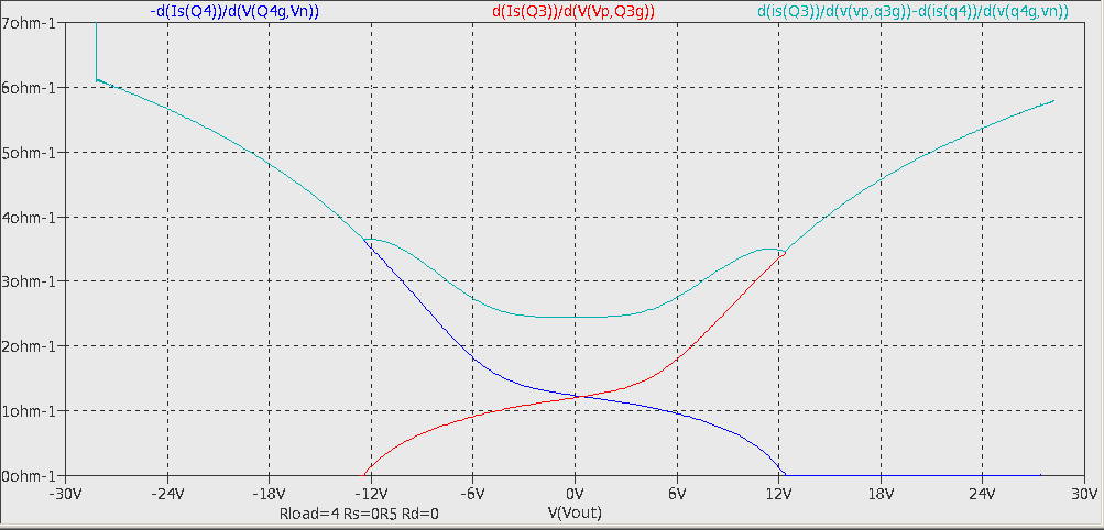

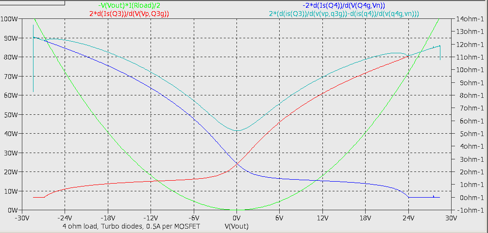

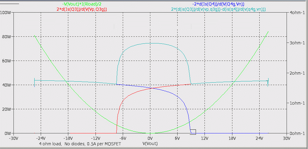

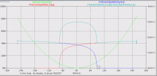

Which Klunk-Klunk is better?
The second plot shows the output stage transconductances of a F5 Turbo V2 (With diodes) at low bias of 0.5A per MOSFET into a 4 ohm load. The transconductance increase smoothly up to about 70 watts where the opposite rail MOSFET turns off, creating a dip.
Of course the Turbo V1 bias could be increased to 1.5 amps per MOSFET in order to have 70 watts class-A but that would dissipate about 200 watts at idle.
The bottom line is
pure class-A no Klunk-Klunk, but power hungry
Class-B bad Klunk-klunk, less power
Turbo V2 no Klunk-Klunk if properly biased, less power
The first plot shows the output stage transconductances of a F5 Turbo V1 (No diodes) at low bias of 0.5A per MOSFET into a 4 ohm load. It is only capable of about 8 watts class-A.KLUNK!-!KNULK
The bottom line is

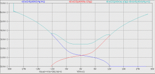

Just for my curiosity, reduce Rs to 0r22 and keep Vbias at 250mVdc.
How do the curves compare like that? with and without the diodes?
I forgot to mention, that the previous curves are with 1R0 source resistors (not 0R5) with MOSFET bias of 0.5A.Just for my curiosity, reduce Rs to 0r22 and keep Vbias at 250mVdc.

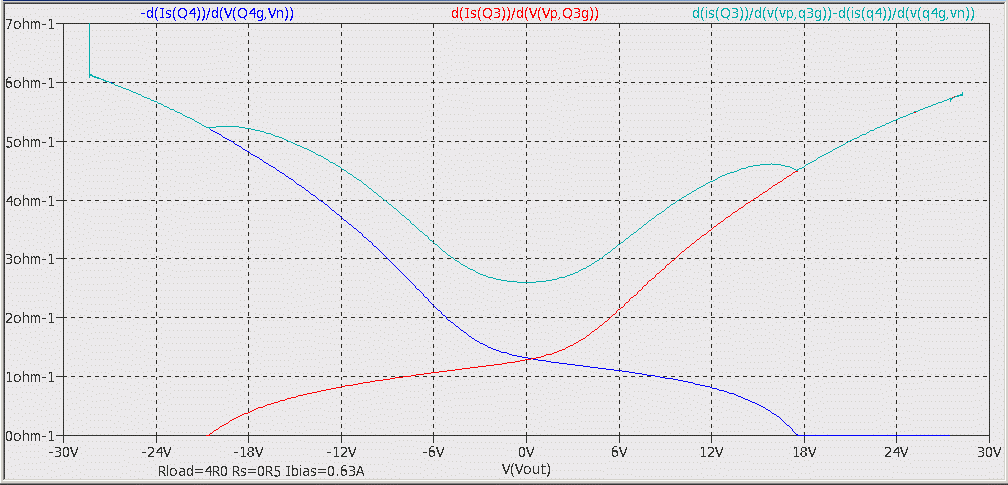

With the 0R5 source resistor it requires a lot more bias to get the kink out of the transconductance curve at low power levels.
Here is what the curve looks like with Rs=0R5 at 0.5A bias:
It is the same as the first plot in post 542.Is this the same as post542?

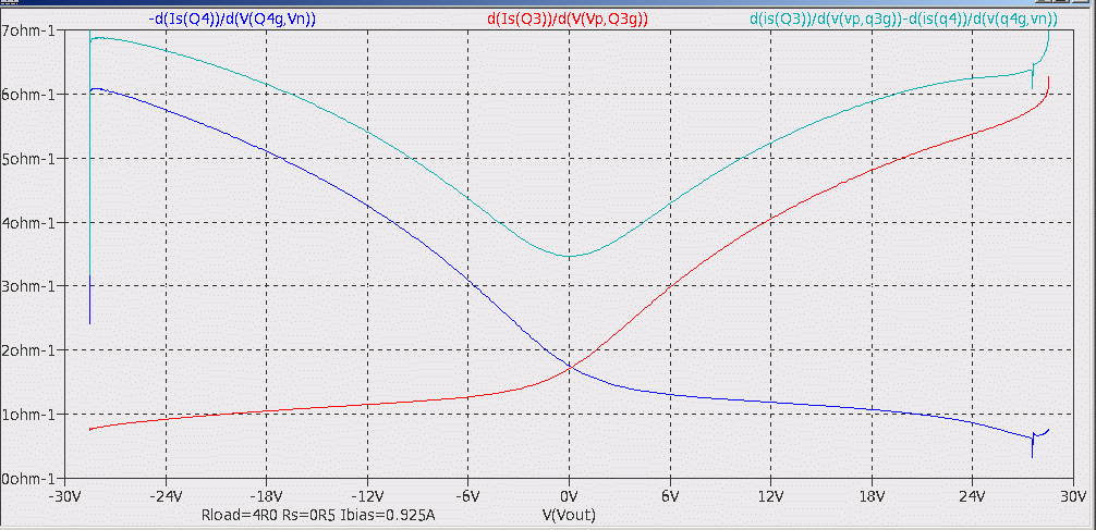

Here are plots of transconductance with Rload=4R0 Rs=0R5. From left to right the bias currents per MOSFET are 0.5A, 0.63A and 0.925A.
