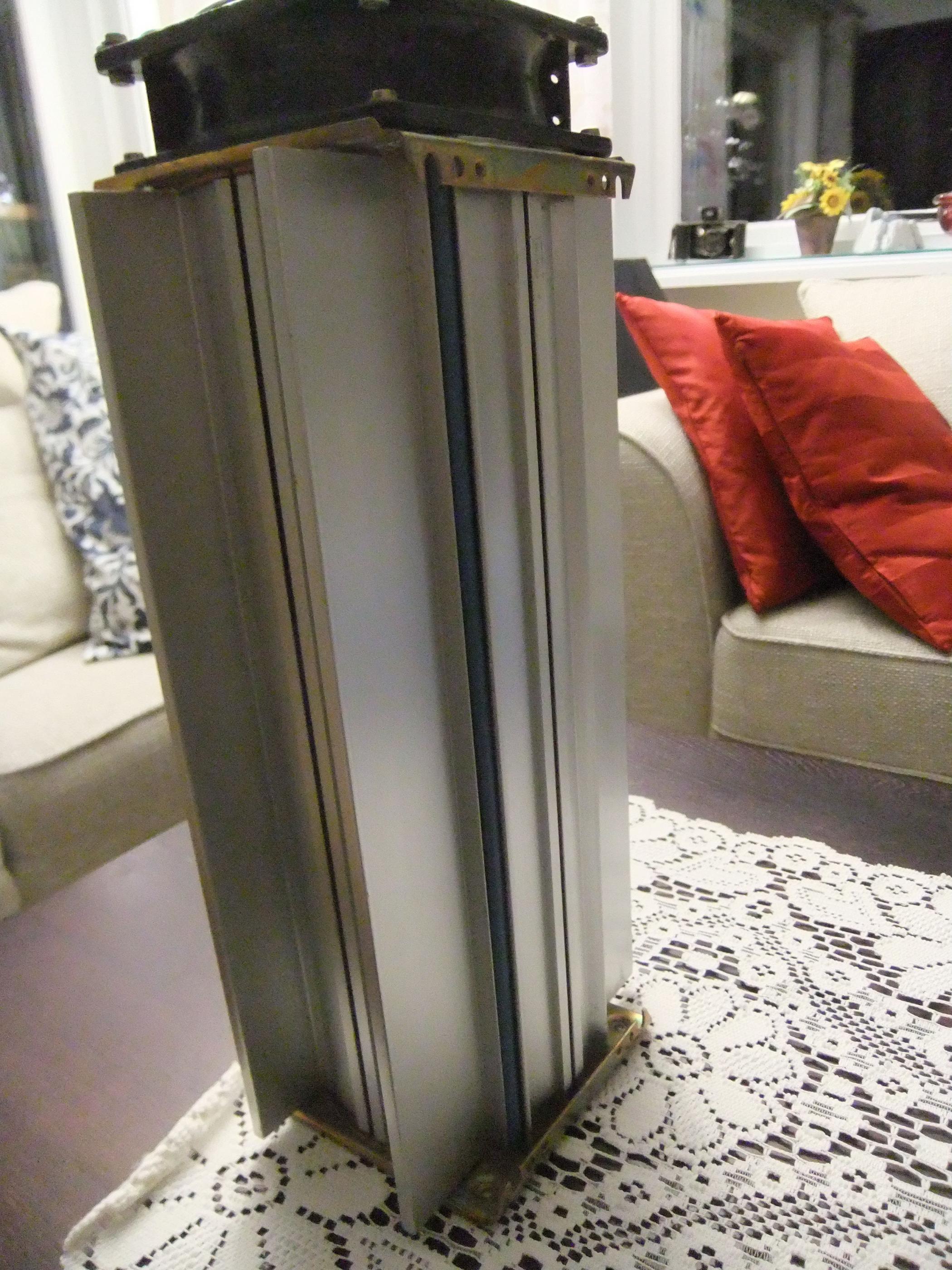

My starting point is the following: I have previously built F5 turbo V3 with cviller PCB. These PCB are no longer available, so I have chosen the only available option from Jims Audio: F5Mosfet pure class A thick turbo V3 turbo
With these PCB I want to build an F5 turbo where the purpose is to extract the maximum Class A power. I have the following “base” which in this thread will determine how far it is possible to satisfy my original desire: Maximum class A output.
I have acquired the following to add the above PCB:
Transformers: Two 500VA with secondary windings 2x25V AC.
Heatsinks: A massive cooling tunnel with fan (3350 mm long,unfortunately I have no other data to show, but see attached photos). Both the MOSFET and MUR 3020 will be mounted on this heatsink. MOSFET are IRFP

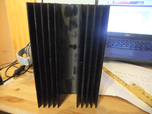

I'm a little surprised at the statement that the air-cooled tunnel will give uneven cooling of the different output transistors, but I have no practical experience with such a solution. Can you give a more detailed explanation of what happens? Is this problem so great that it should be discouraged?? I also mentioned that I had planned that also MUR 3020 to be placed on the same cooling profile.
I also have the ability to use passive cooling. I have four pieces 1000 mm long profiles. They are 120 mm wide, the fins are 42 mm. See attached pictures. I imagine that a possible solution could be to connect three or four profiles together. Interconnection can be done by fasten yhem on a 3 mm aluminum plate. Does anyone have suggestions for such a passive solution adapted to a 70 W class A F5 turbo as I have described in my earlier post. I imagine 2x mono build and that such a cooling plate must necessarily have some and perhaps considerable height.

The "problem" if it exists, is that the air is heated at the beginning of the tunnel.
The slightly warmed air is heated again as it passes through the middle of the tunnel
The thoroughly warmed air is heated even more as it passes the far end of the tunnel.
The slower the air flow the worse the problem.
The "problem" virtually disappears with fast air speed. (= efficient blowing with no leaks and lots of noise)
You can help by changing the spacing of the devices along the tunnel.
Where the cooling air is still cold the devices can be slightly closer together.
Where the cooling air is very warm the devices can be spaced much further apart.
YOU the builder needs to DESIGN the heatsinking.
It is not just a drill and fix job.
The SAME design procedure applies to passive heatsink.
The devices at the top NEED to be farther apart due to the warmer air passing over that part of the sink.
This is all explained by the better manufacturers in their data sheets and application notes.
You need to look and read = research.

with that Krell-like heatsink - lazy 12cm fan (cruising at anywhere between 5 and 8V) will give you what you need
do not worry too much for temp spreading
You could blow the fan at slow speed right at the center of that sink so the air splits and goes out both ends.
That effectively splits the sink in half. Has a somewhat same effect as cutting it in half.
The goal is even temps across all outputs as best you can.
Without any fan cooling you will get proper heat distribution, but will your final temp be in the proper range?
If you could place all outputs on thick copper bars and then bolt that to the heat sink, you get more options on placement and size.
Just as too much horsepower is almost enough...
To much heat sink is almost enough, meaning you can never get enough of it.

Build it, the aluminium will conduct the heat and equal things out quite a bit. It will be what it is and the devises will work as long as the temperature isn't over the limit.
