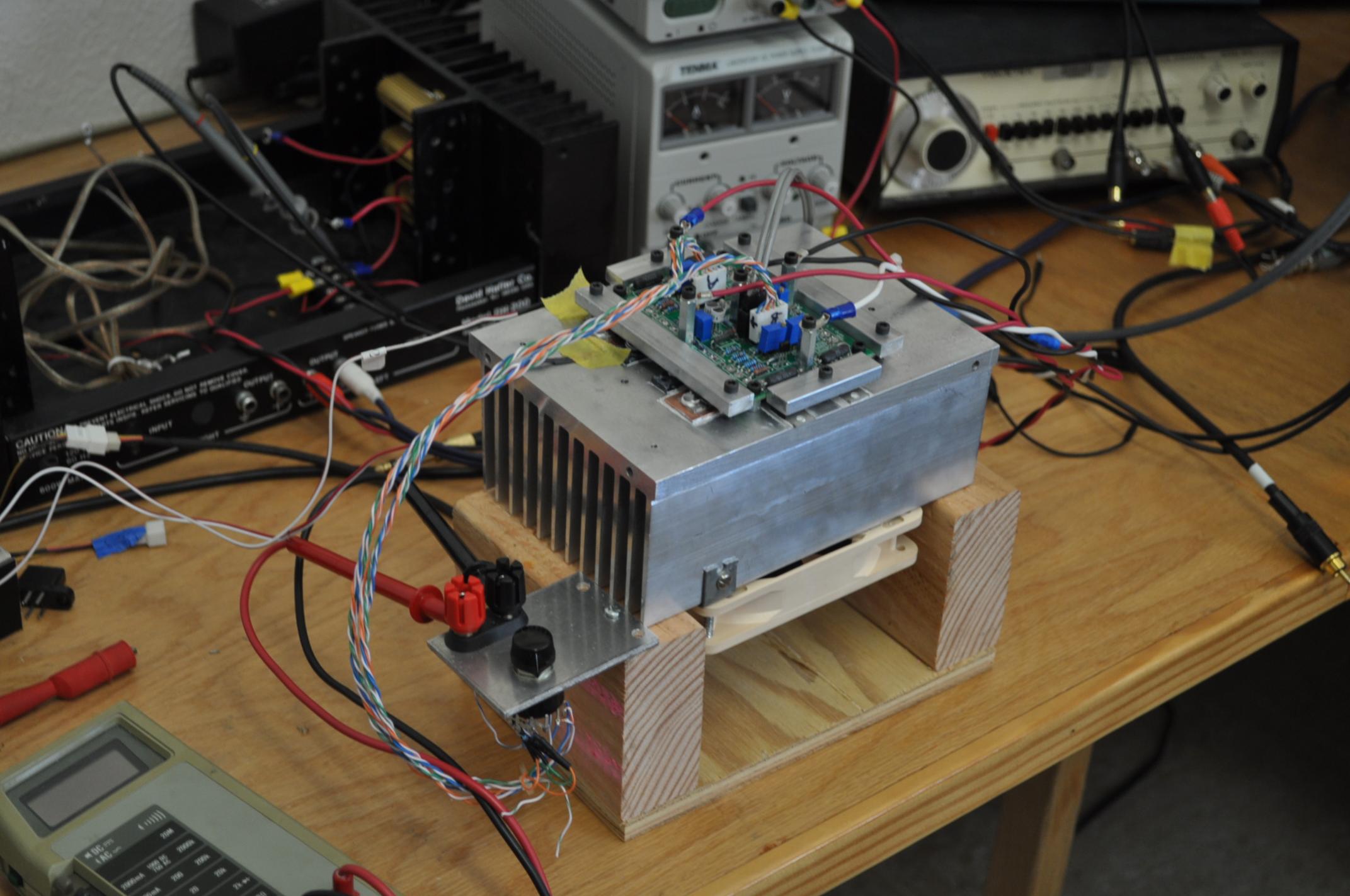

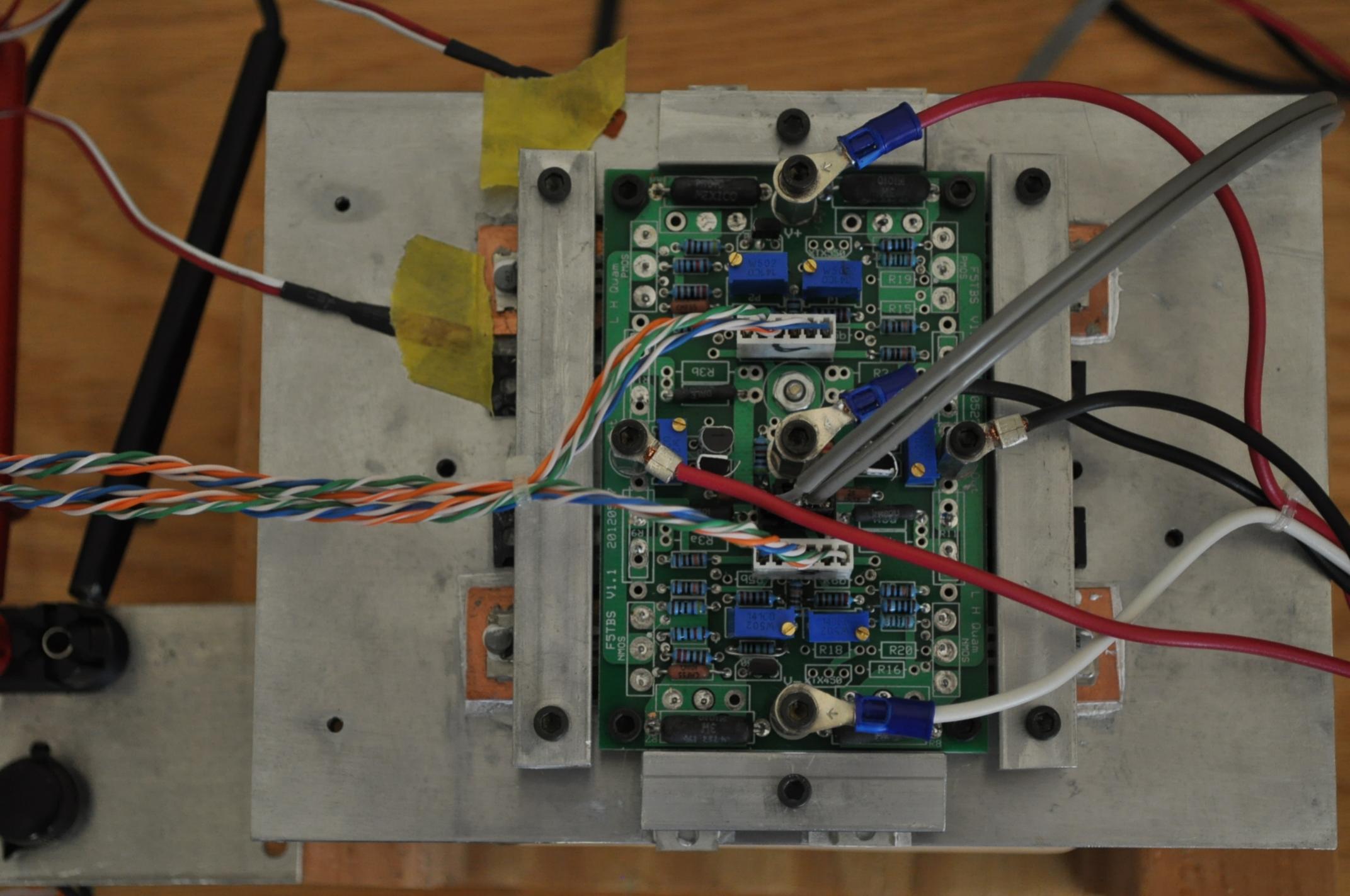

I am making live measurements of a balanced 1/2 Turbo. By 1/2 Turbo I mean it has one MOSFET per rail and one MUR1510 diode per FET. Here is an image of the board and is attachment to 1/2 of a HeatsinkUSA 10.08" x 7" heatsink:

Very nice. How do the measured numbers compare to simulated ones?
Overall there is decent agreement between the simulation and the actual circuit, but I am not sure I have enough experience with this circuit to answer the question definitively. I have some doubts about the accuracy of the MOSFET and MUR diode models. There are some issues with the LTSpice results I haven't figured out. Perhaps there are LTSpice convergence parameters that need tweaks.
One thing that both the simulation and the actual circuit show is that reasonably high bias (> 1A) is needed to get THD below .005%. Both show that the Turbo diodes greatly reduce THD at high power levels versus the non-Turbo at the same bias.
I have not yet done any listening tests of the version with diodes. I have been listening for more than a month to a nearly identical balanced F5 pair without the diodes. It sounds very good.
