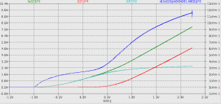

As Jacco said OR with a Macbook you can zoom in with 2 fingers on the track pad as large as you want (it does get blurry if you go too large), I am speaking about post 512 pic. Very handy.
The smaller image that Jacco posted I can read without zooming in.

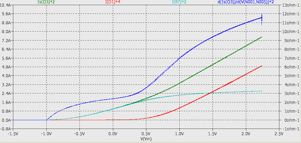

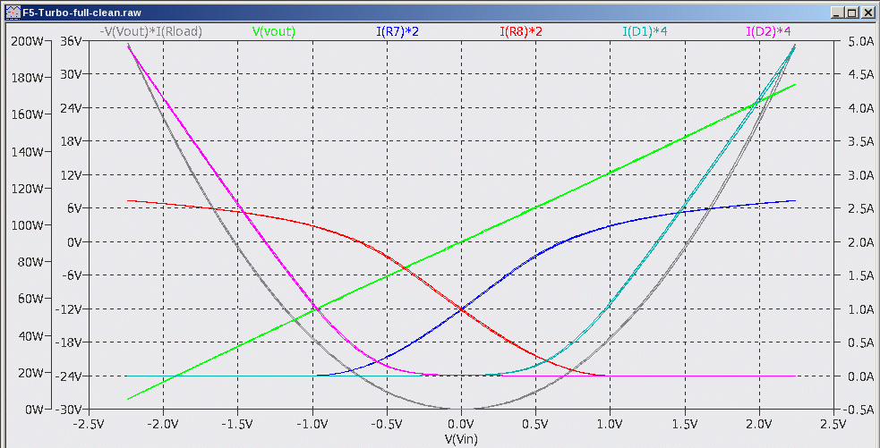

Here is the plot with grid lines and the .asc file:

CNTRL+Scroll works and importing into Irfanview & + also works.
But although I can now read 0r5, it is more than a bit fuzzy. I'm not going to blame my eyes. They get a health check at least every two years and sometimes more often.

I did a check on the numbers being presented in the plot.
@ Vin=0.5V
Vout=6V
V*I=10W
IR7*2=1.8A, IR7 = 900mA
IR8*2=0.3A, IR7 = 150mA
Id1*4=0.16A, ID4 = 40mA
Id2=N/A
From these I can calculate that Iout = IR7*2 + Id1*4 - IR8*2 = 1.66A
Gain = Vout / Vin = 12 (this seems very high !)
Peak instantaneous Power = 6V * 1.66A = 10Wpk
Vrs = 450mV
ID4 = 40mA @ 450mVf
These (except for gain) seem to make much sense.
They indicate that when at quiescent bias, the diodes are effectively OFF.
When the output current has risen to twice the bias current, i.e. maximum ClassA output current of 1Apk, the diodes have a fairly low current contribution.
When the amplifier has transitioned into ClassAB operation the diodes begin to make a significant output current contribution.
Other than the odd gain, this is the information I have been looking for.
Can we compare a high Vrs quiescent setting and how the diode current contribute to the output current for this?
I'll be rash and make a prediction.
If Ibias requires a voltage across the diodes that turns the Diodes ON, then we will see that "kink" in the plots. Can we do a differentiation of the current slope to show up the kink more easily?

The gain is correct. Look at Nelson's F5 Turbo V2 schematic. The feedback network has 2 x 220 ohm resistors in parallel (110 ohms) and 10 ohms to ground. That is a 12:1 divider.
I will work up a different presentation show output stage open-loop transconductance vs output current.
