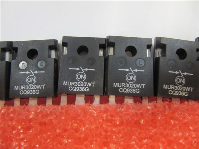

Amazing what you find when you have a look.

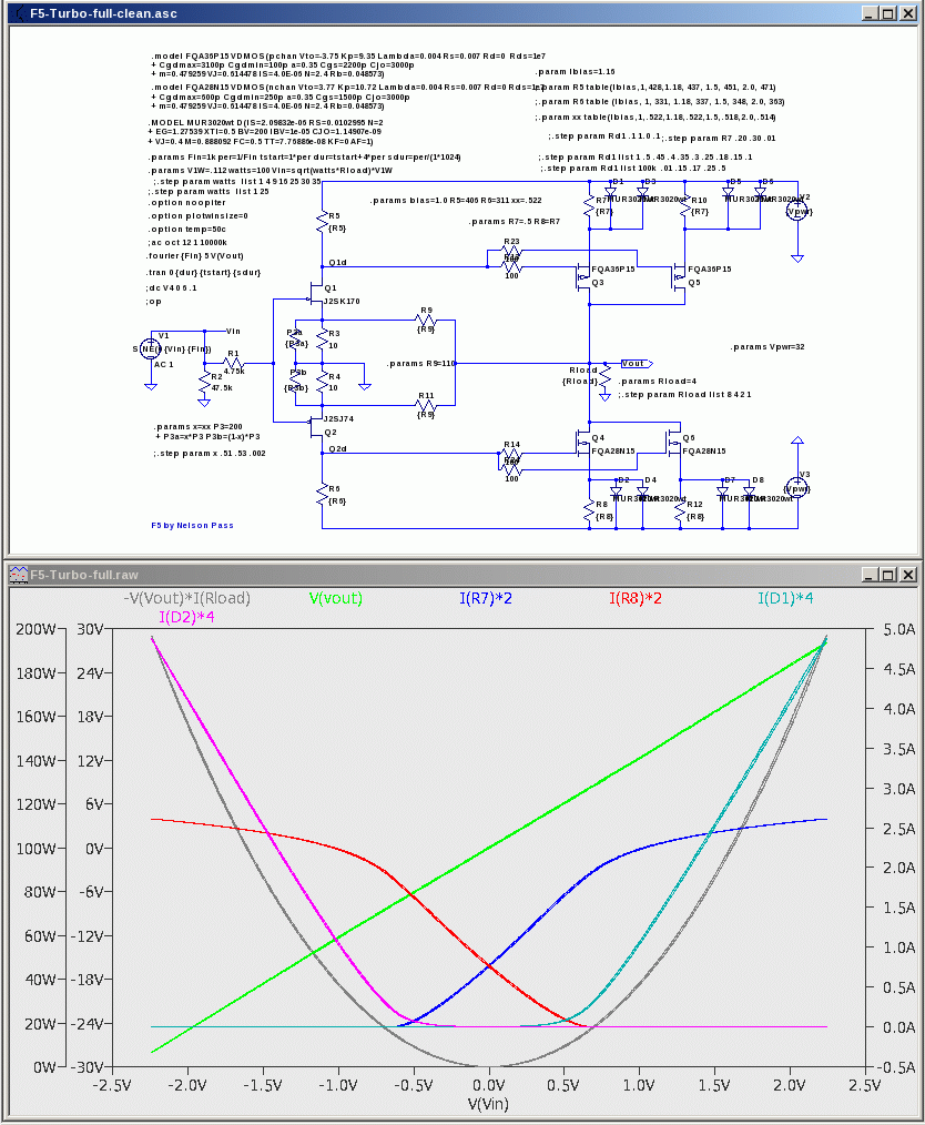

Turbo current plots
Here is an LTSpice simulation of the F5 Turbo V1.2.
32 volt rails
1 amp total bias (.5 A per MOSFET)
4 ohm load
100 watts output
As you can see, the current thru the diodes "kicks in" smoothly.
Ih,
I can't see a value for Rs (R7etc) for the output mosFETs.
Can you state Rs & the quiescent Vrs for your Ib=500mA/device?
Can you also add a cursor @ Vin=+0.5V (instantaneous value, not AC & not DC)?
Then read off the values of the various plots at that cursor?
