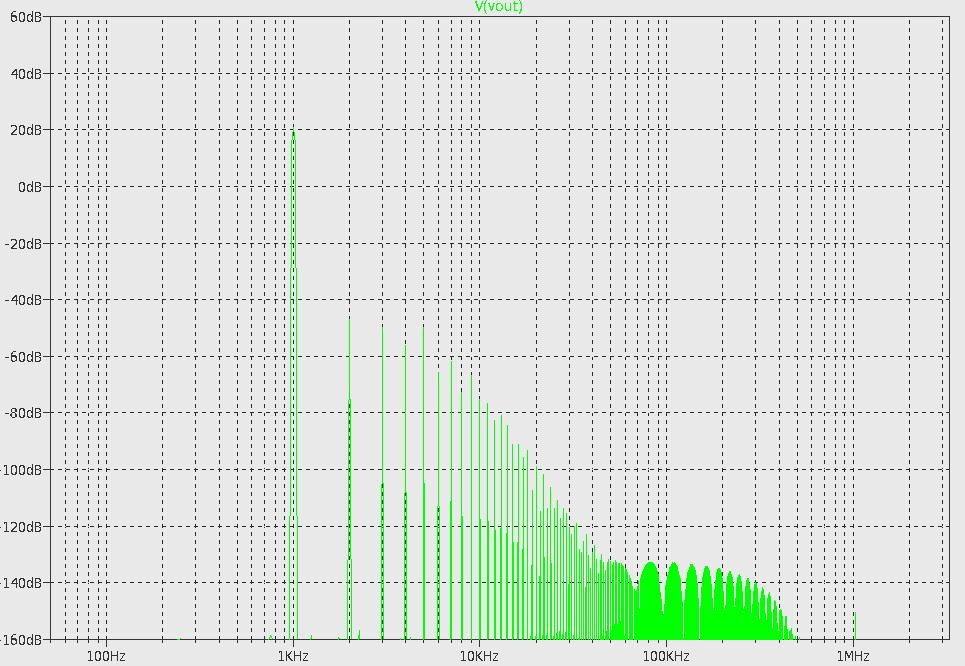

Thanks for the Spice model. I now get THD plots very similar to yours. The main difference is that my 2nd harmonic is higher than yours in both cases. Could be due to differences in Spice models for the IRFP240/IRFP9240 MOSFETs, or slight differences in biasing. My biasing looks good: it required careful adjustment to get 15 V peak without leaving class-A.

Something just occurred to me about the circuit.
I think it is capable of even better performance, just need to wait till tomorrow to confirm it.
Before I saw your non-Turbo/Turbo THD plots and did some simulations, I was not convinced about the Turbo. EUVL has proposed an alternative based on reducing the source resistors to near zero, which helps, but increases the problem of bias current vs. temperature.
I am now a believer in the Turbo.

Simply adding in a parallel diode to the source resistor is not advised.
I have asked a few times what is the set up procedure to give the diode version of the F5 a real chance to perform well. To date I seem to be the only one answering myself.
