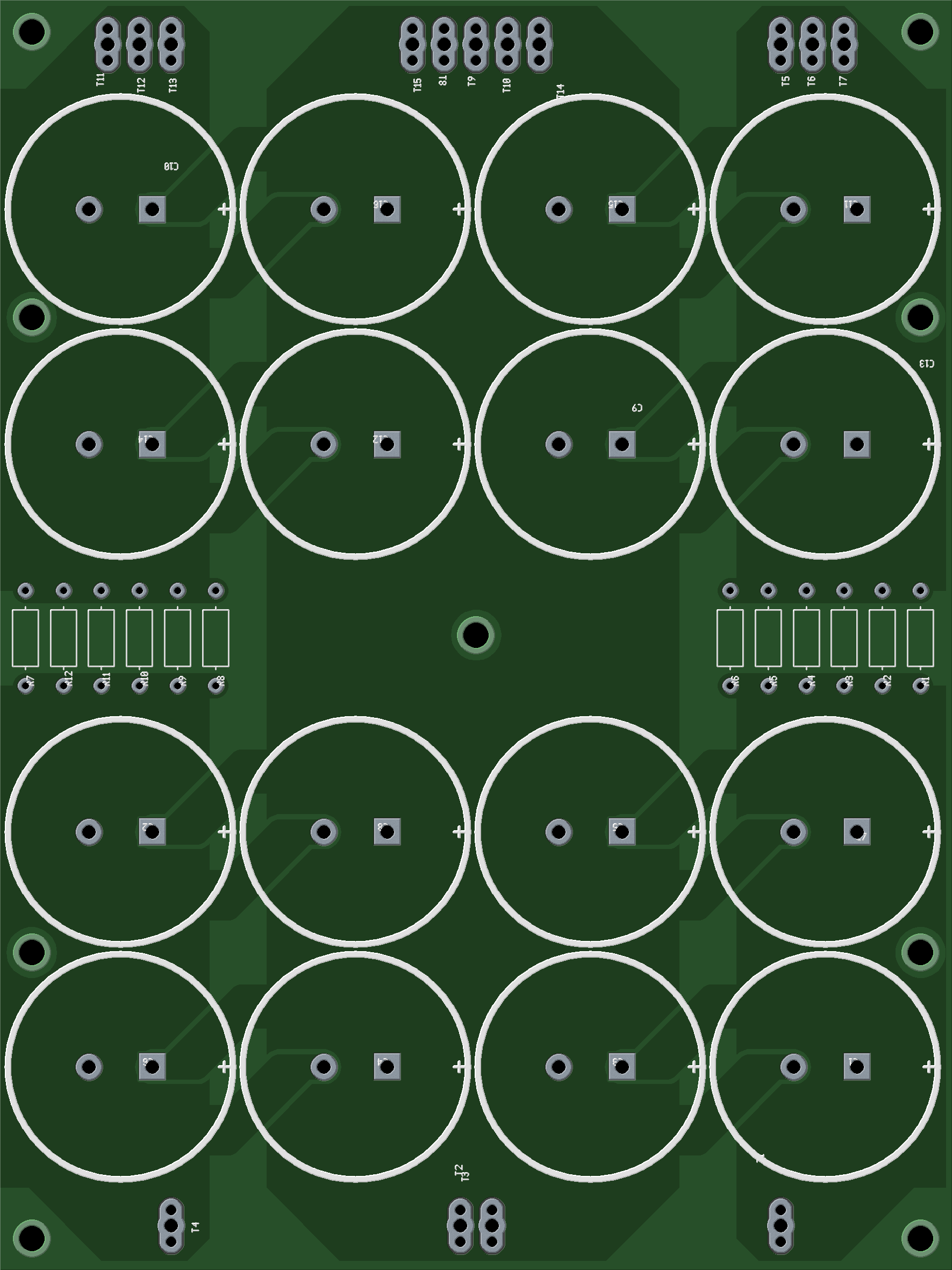

Hi does anybody know where to buy pcb for 16 x 10000 uf 50 V 30 mm Ø ? Just bought 32 ROE 105 celcius from Vilnius .
I have made this layout to another project, but you get the gerber and send to seeedstudio if you like. Board is 150x200 mm and snap-ins are 35 mm Ø. I have made it single sided because I plan on etching it myself when I get around to it. :D
