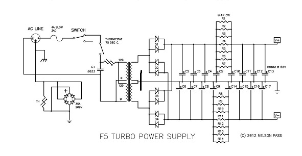

In looking at the power supply from the F5Turbo article, I wondered, what happens if you don't attach the transformer's center tap to the zero volt line?

If your PSU works and has a stable ground, you don’t have your transformer attached in the manner shown on the schematic you posted in #5526.
Which leads to the question, how DO you have it attached, with the 5 secondaries...??
Just like the diagram shows. .

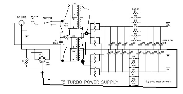

One V+/CT/V- secondary is not used. The 4 other secondaries are split into two groups and run in parallel. There is one full wave rectifier per channel.
The caps are strapped together on the PCB boards. They are the white teabag boards. There is a pair of boards per channel.
The ground on the right hand side of cap bank as shown on the diagram goes to the ground connected to the diode bridge/CL-60. There is one diode/CL-60 per channel.
Both of the diode/CL-60 grounds are connected to the same earth point on the chassis where the safety earth comes into the box.
I hope the drawing is OK.
The secondaries are in parallel with the other secondaries. If they were not, fuses would be blowing.
The connection between the center tap and the zero volt line on the left of the cap bank is not made.
The ground on the right of the cap bank is connected directly to the ground on the left on the diode/CL-60. The other side of the diode/CL-60 is connected to earth.
This shows only secondary side and ground.

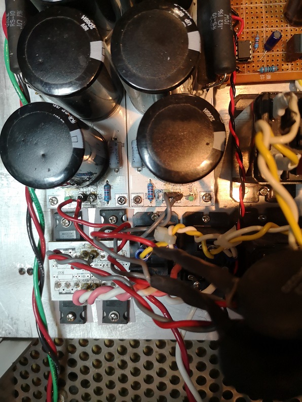

does the re-drawing help? The build is a mess.... The first photo shows a terminal strip. With secondaries attached. The unused ones have heatshrink wrapped ends. The flying caps/resistors are snubbers.
One pair of red/white goes to a cap bank for each channel. The second is a closeup of one of the cap banks. You can clearly see that red and grey are +/-. No CT connection on the diode bridge side.
There are a lot of relays around the boards. The notion was that in the event of a short cycle while powering up, a relay would disconnect the diode bridge from the cap bank, to enable the thermistors to cool.
But this is not about the relays. This is about parallel secondaries of a CT transformer, still supplying the correct voltage, even though the CT is disconnected.
The secondaries are 2xV apart. The zero volt line is connected at the signal ground only. That gives the center voltage reference. Then V+ is V above signal ground ,and V- is V below. The signal ground is 10R above earth due to the CL-60.
So there is a center reference.
