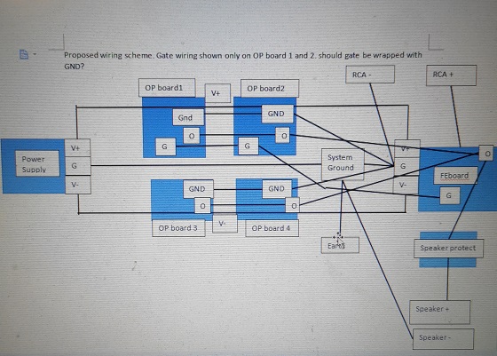

Attached is a proposed wiring scheme. The important bits are:
1) Power supply ground is attached *directly* to system ground ( the diode bridge ) with a single wire.
2) Output board grounds from board 2 and 4 are attached to FE board ground point, then to system ground ( the diode bridge )
3) V+ and V- is connected from power supply to OP boards 1 and 3.
4) V+ and V- is connected to FE board from OP boards 2 and 4.
PS ground is not transmitted through OP boards. It is an independent wire to system ground.
Any comments would be HIGHLY appreciated!

jpg attached.

PS, it's wired funny this way, because the cap bank is on the front side of the amp, and the FE board is on the back side. There is a large transformer in the middle. If anything is confusing, please let me know and I will clear it up.

This will help immensely... http://hifisonix.com/wordpress/wp-content/uploads/2019/02/Ground-Loops.pdf
Omg that's a lot to learn. Really complicated.
I've read about a third or so. It's not so bad, but then again, I don't know this stuff..... There are some questions coming up, but maybe finishing it will answer them.

Page 56 of http://hifisonix.com/wordpress/wp-content/uploads/2019/02/Ground-Loops.pdf should answer your question, the lowest bridge & cap in the bottom right corner are replaced with a CL60 in the FW designs.
Thanks Itsmee. Pages 36 and 37 are more detailed. I think 56 assumes that the amps are on a single PC board, while the F5T is spread over a couple.

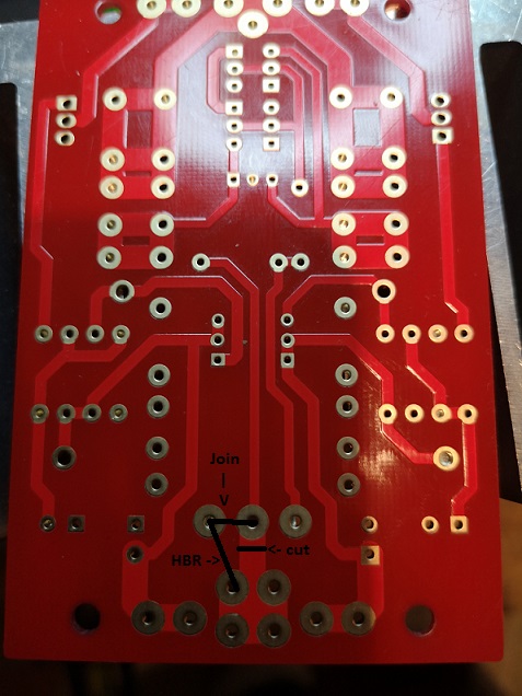

My question is where on the FE board to attach the HBR.
Is it just at the GND point or is the GND point on the FE board on the wrong side of the feedback resistors ? ( I am at the office, so cannot check )

You don't, it's in the PSU between 0V and chassis earth, unless your talking about low value resistors (10R ish) in the ground connection between the input socket and ground on the PCB; only do that if you have hum problems you can't cure any other way.

Adding the 10R's may not help, thats for breaking hum loops, if it does, rewire.
Your problem may be induced hum from local proximity, first move the wiring, then try rotating the transformer, next try standing it vertically - it moves the flux lines by 90°, try both N-S & E-W 'doughnut hole' orientation to see which gives the least hum; decide from there what needs to be done.

It looks to me like the FE board needs to be modified for the HBR to be installed as per the Hiphonics article. Specfically, the article shows that the RCA shield is connected to the HBR on it's way to the zero volt line, as does the ground between R3 and R4 ( I think ).
A picture says a thousand words.... attached is how I think the HBR should be added. The diagonal line is the HBR, the thick ground is cut, and the link and group of G's are connected. It is labelled with black text.
BEWARE: I'm not an expert. Just trying to learn something. It's easy enough to operate as designed.... just replace the HBR with a jumper.
Does that look right?

Can't help with the PCB, I dont know it - haven't built one with those boards.
There are lots of sucessful builds without the HBR.
Pictures of your build would help.
