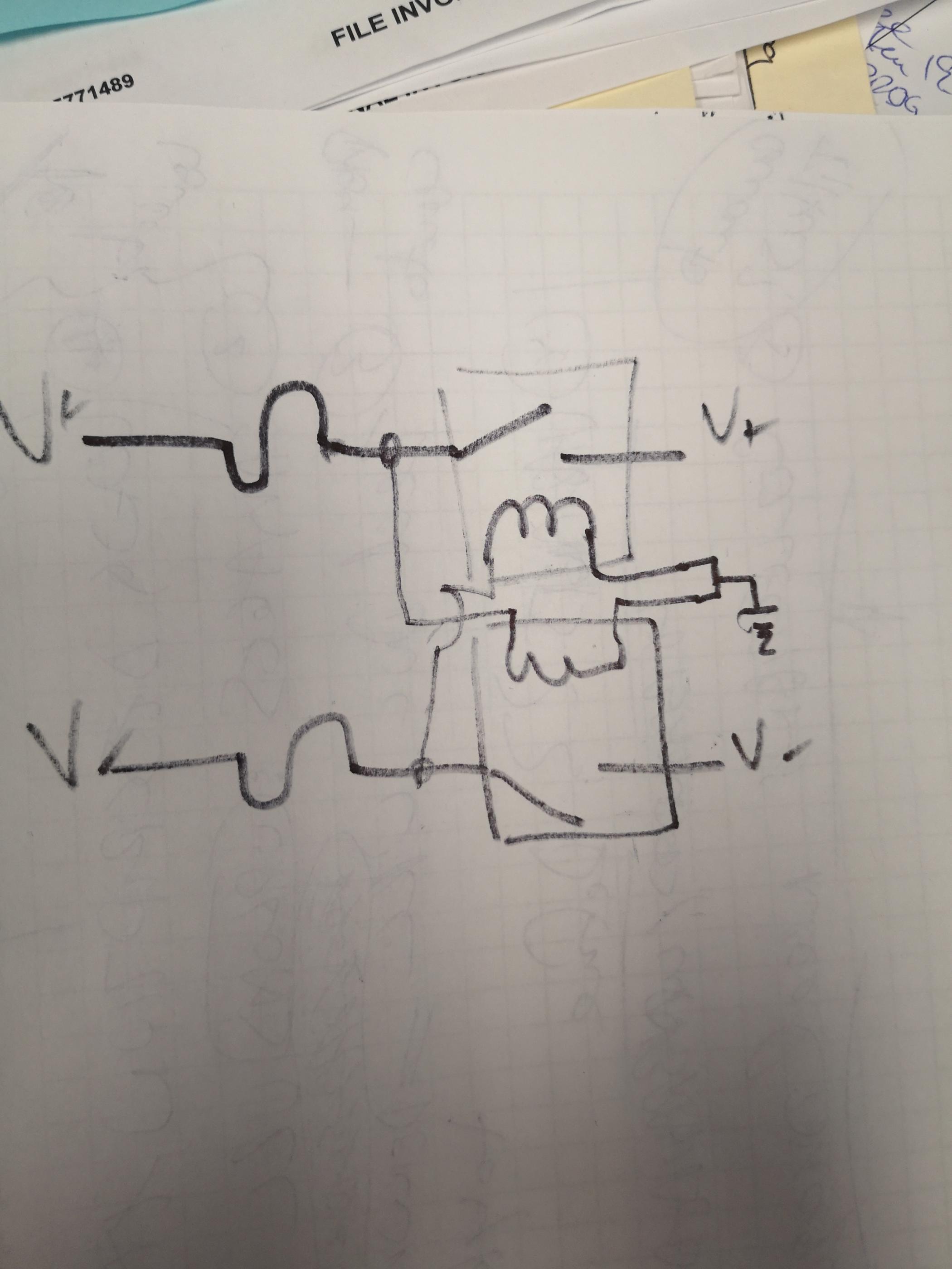

If you take the diodes out, an amp with a 40 V rail can deliver up to 46.5 A across the MOSFET Rds + Rsource_resistors. With the diodes in place, that rail can deliver 106 A over Rds.
Attached is the idea for a little circuit that might stop damage due to these surges , and stop damage due to crazy DC offset at the speaker terminals (fuses + relays). No doubt, a resistor ladder will need to be in place for the relay coil voltage.
Any idea if this will work?

1 relay will work, if a fuse blows, one end of the coil is connected to a supply (+ or -V), the other end of the coil is flapping in the breeze, there's no where for the current to go.
One coil is connected V+ to ground the other is V- to ground.
A resistor ladder can be used as necessary to adjust the voltage for each coil. eg. a 36 volt rail and a 24 volt coil would use a 1/3, 2/3 split, with resistor wattage and values to respect the coil draw.

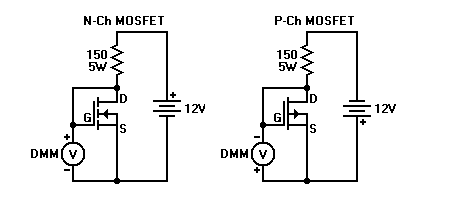

Or you could find a simple, inexpensive 12 Vdc wall wart, maybe laying around somewhere, with a current rating of 500 mA or more and a 3-5W resistor of a value that gives the desired current to the DUT. High precision isn't required, only consistency. You're not going to measure and compare to anything other than the group of devices you're measuring against. In other words your measurements are only good for you, they can't be compared to anyone else's and frankly don't need to be. You just want devices that that match each other using your setup.
Below is a great, simple circuit for matching MOSFETs. For 12vdc I use an 81 ohm 6 W resistor (actually 2 x 3 W 162 ohm, 80 ohm is fine) for about 250 mA at 12 Vdc (actually ~13.8 Vdc). With that, the DUT will heat up to around 50-55c max without a heat sink and closely represents the conditions inside an F5T and therefore a very good match under actual operation. Let them cook for 10-15mins to stabilize then note the Vgs.

But it is probably best and safest to implement this mosfet matcher:
http://www.firstwatt.com/pdf/art_mos_test.pdf

The MOSFETs need to be matched for Vgs (Voltage gate-source, the voltage at which the mosfets turn on), within a 1/10 volt or so (0.1), so one of the pair doesn't turn on before the other one and take all the current - if that happens basically the first mosfet will do all the work.
The N channel need to be matched to the N channel, the P need to be matched to the P. There is no need to match N to P, and although it's possible, it's quite rare.
Use the mosfet matching circuit as shown in the article you linked, don't try to use the front-end, it won't work. You can use a DC wall wart as suggested for power, there's not a lot of current required.

I have a (dumb) question regarding the schematic shown. if the 150 ohm resistor is replaced with a 80 ohm one, using a 12 V PSU, how does one get 250 mA current flowing thru the circuit?
