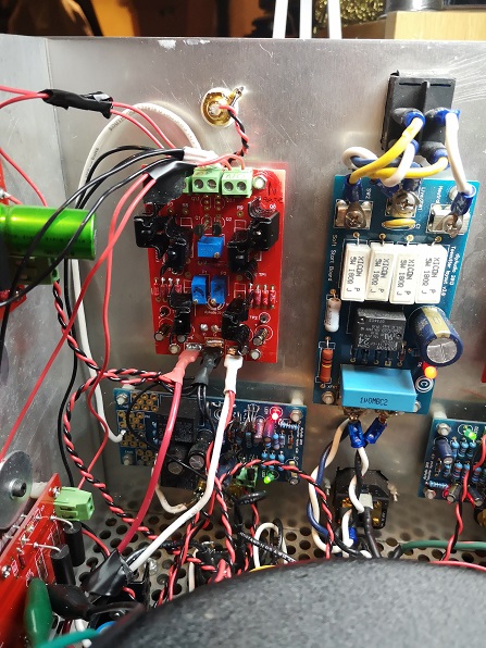

OK, so I wired it that way.
With a shorting plug, and AC coupled, the scope says the noise is 200 uV rms, or 0 using case ground, ie earth, as reference. That's the resolution of the scope I guess.... low end Rigol digital scope.
I'm letting this cook right now, and tackle the other channel later.
The article linked to by 6L6 is key. I have still not implemented all of the ideas.
This is a photo of how the FE board was wired.

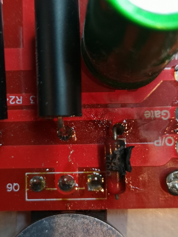

Could be awhile.... I just screwed up the other channel bad. Fire on board.
I was having some trouble, and suspected an N-channel short somewhere.
I removed all of the output boards from power by physically unsoldering the power wiring from the boards. I was going to reattach until failure, but thought that was a bit extreme.
I removed the FE board to check if I had made a wiring fault when repairing a feedback resistor -- I was checking just to be thorough. So the gates lines were in the air, along with the rest of the harness. The other board channel was disconnected from power at the transformer. Just the single channel was being worked on. Remember, V- and V+ were unsoldered from the boards.
The amp was off for over 1/2 hour. There was a pop and a fire under C2x. Smells like burnt silicon....I have no idea what could have happened. Vneg was not connected to the board -- and still pop and fire..... Even if you power these caps backwards, it should be fine... they are 50 volt bipolar. Power supply is max 41 volts unloaded...
Looks like Vgate and V- or V+ touched -- maybe on the case..... Two fried gate resistors and obviously, fried output devices.

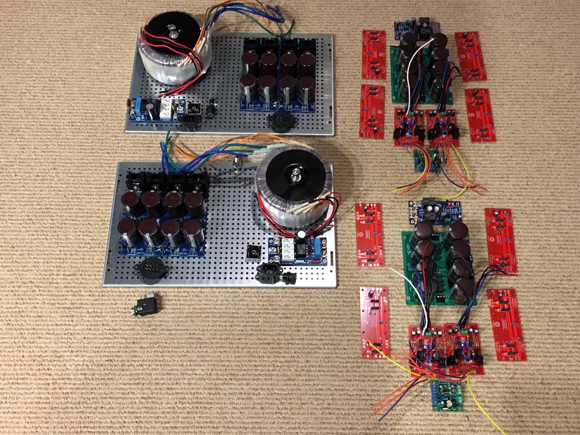

My F5t v3 Balanced amplifier picture #2, all the boards stuffed, two 800 va 36v x2 secondaries. Separate power supply enclosures and amplifier enclosures. I'm going to build the power supplies first along with the umbilical cables first. Nice to have the perforated lower plate makes it easy to build.
plates need to have edge pointing up
that way , if you elevate them slightly from heatsink brackets , you're gaining some clearance and you can route mains wires underneath plate
see here (post #669) Babelfish M25, SissySIT - general building tips and tricks
Got it. Love the pictures of the SIT, especially the DUCATI capacitors. With that name, they look as good as they must work. Thanks.
Looks like an mur3020 was not properly insulated on the N channel. Non-infinite ohms from heatsink to pin 2. I don't know how I missed this when re-aassembled. Probably because it was fine before last output device failure.
Heatsink is earth, audio signal ground has cl-60. That short would dump Vneg to earth, lower ground potential and other polarity of power supply would appear to read double, as it did before the first slow blow fuse went.
Will repair next week.
I hope that this experience might help someone else debug their work. Lesson learned.... just because it was fine last time, does not mean it is still fine after you touch it. No shortcuts. Measure it all.
Well, I got to it earlier.
Seasoned builders will already know this....please ignore or correct if you like.
The diodes are connected to the power rails via their middle pin. The middle pin is also conneceted to the back of the diode, which means you must isolate this from the case/heatsink, or you will short the power to the heatsink.
It is easy to test if the case is connected to the middle pin with a DMM. Just measure ohms with one probe on the case and the other on the middle pin. If your sinks are anodized, you will have to find a screw hole or scratch through to bare metal to make contact. ( Plus one for anodized sinks..... anything causing a short must penetrate the anodization to make a short as well, just don't rely on it. A little insurance is better than none.)
Since all diodes on one polarity are connected, the middle pin of any diode will show zero ohms (a short) if the back of any one (or more ) diodes are shorting to the case. If there are two boards per polarity ( ie 4 per channel ) you will have to first separate the boards of the polarity under test to determine which of them ( or both ) have shorted diodes.
DO NOT remove the boards from the case. You need the short to be there to find it.
I got lucky. When the clamping pressure on one of the diodes was reduced, OL (open loop ) showed up on the meter. When tightened, it showed near zero ohms again. Just the resistance of the leads was displayed. Note, anything that shows an OHM reading means there is a short. Only OL is acceptable -- or whatever your meter reads when there is no connection between the two points.
Visually, the keratherm showed zero signs of damage; the "puncture" that connected the back of the diode to the heatsink could not be found. Only this measurement showed the short.
I replaced the insulator with a new one, wiping down the surface first, and the meter showed OL after tightening.
