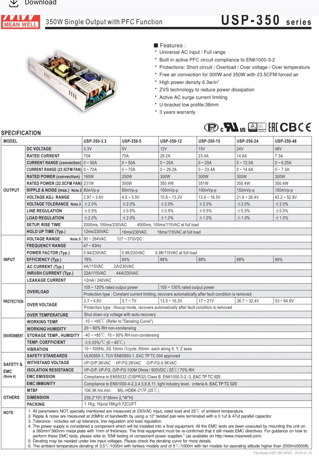

Could anyone check out this SMPS and confirm that it's good to use for F5m? I can get a few for very cheap, so I'd be using two in series for ± 24V rails. Should I pay specific attention to the switching frequency or can that be filtered regardless of what it is?
https://eu.mouser.com/datasheet/2/260/MWEC_S_A0007326977_1-2552144.pdf

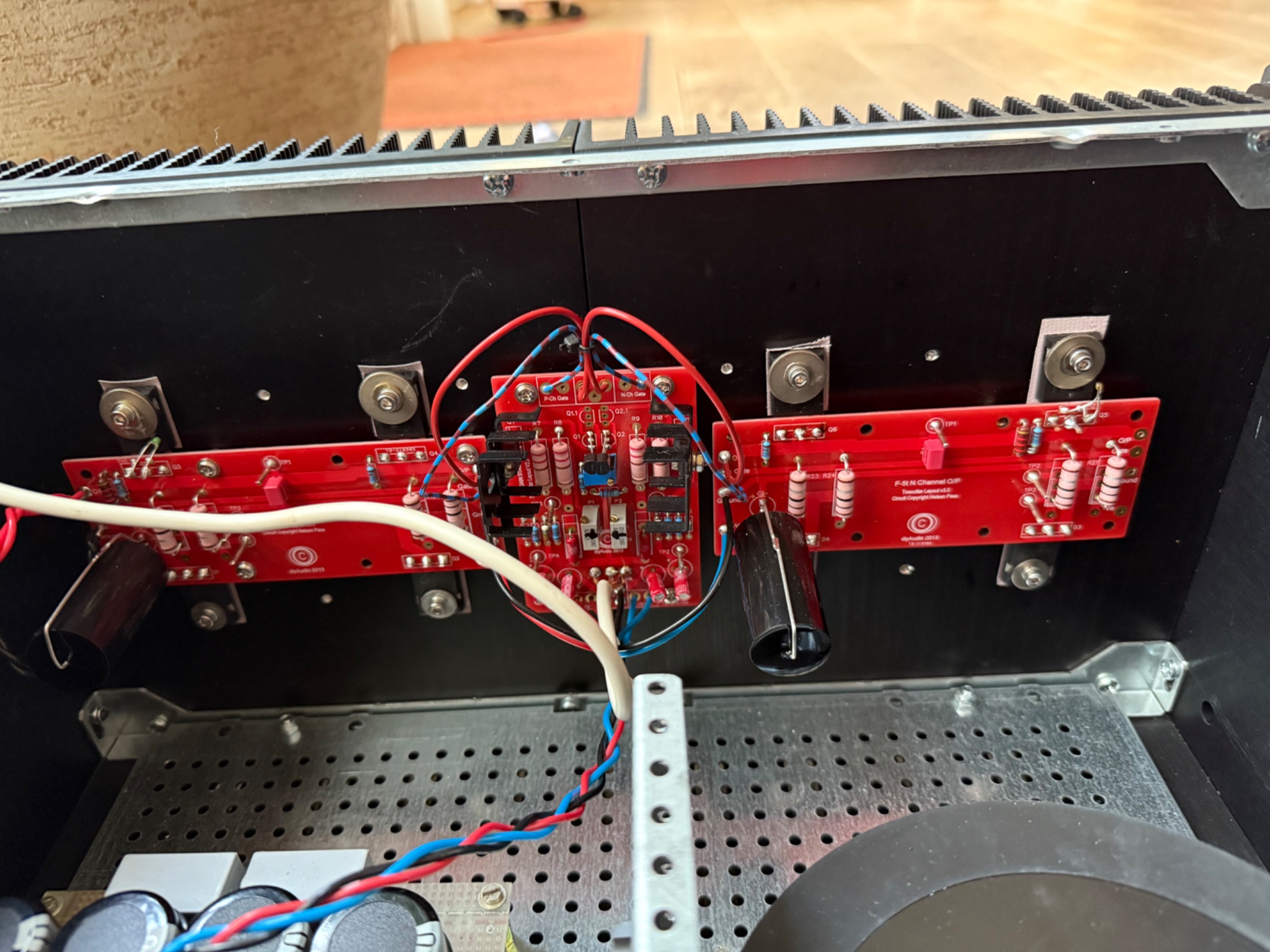

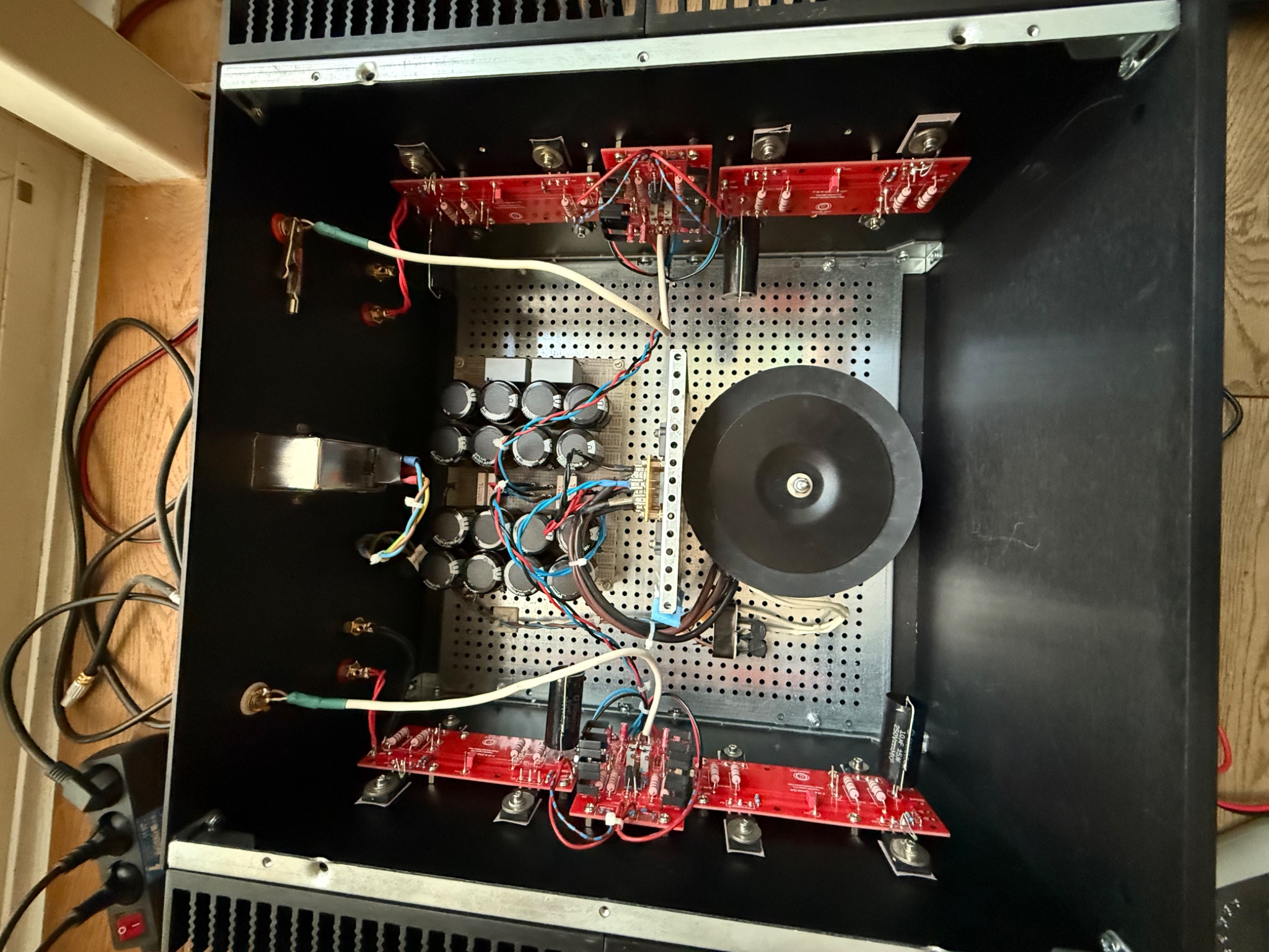

Hello
After installing the new Jfets, I can not set the bias on the repaired side higher than 325mV. On the other side of the amplifier, the setting continues to go up to 350 mV and higher. What to do?
When I originally developed mine 3 years back I had the same problem. I had to drop the emitter resistors from 1ohm to two in parallel or .5 ohm and then I could raise my bias. But did you change the front end fees just on 1 board? If so I would change on the other also so sides are matched to start with. Then you can do the same thing with both boards to get bias up. But see what ZM says first
Hello
I only exchanged the jfets of the bad side with the Toshiba from the diy store 6-8 mA.
I made the following measurements:
I let the amplifier run for 30 minutes in the closed state. Then I opened the amplifier and immediately measured the bias. It was on both sides at about 350 mV.
The temperature of the heat sinks directly between mosfets is after 30 minutes approx. 43 degrees Celsius measured inside on both sides
10 minutes after opening, the bias dropped on the repaired side to 330mV and on the other side the bias remained at 350mV.
The offset remained at about 0 at the output.
@zm : What exactly should I send. I didn't understand it.
