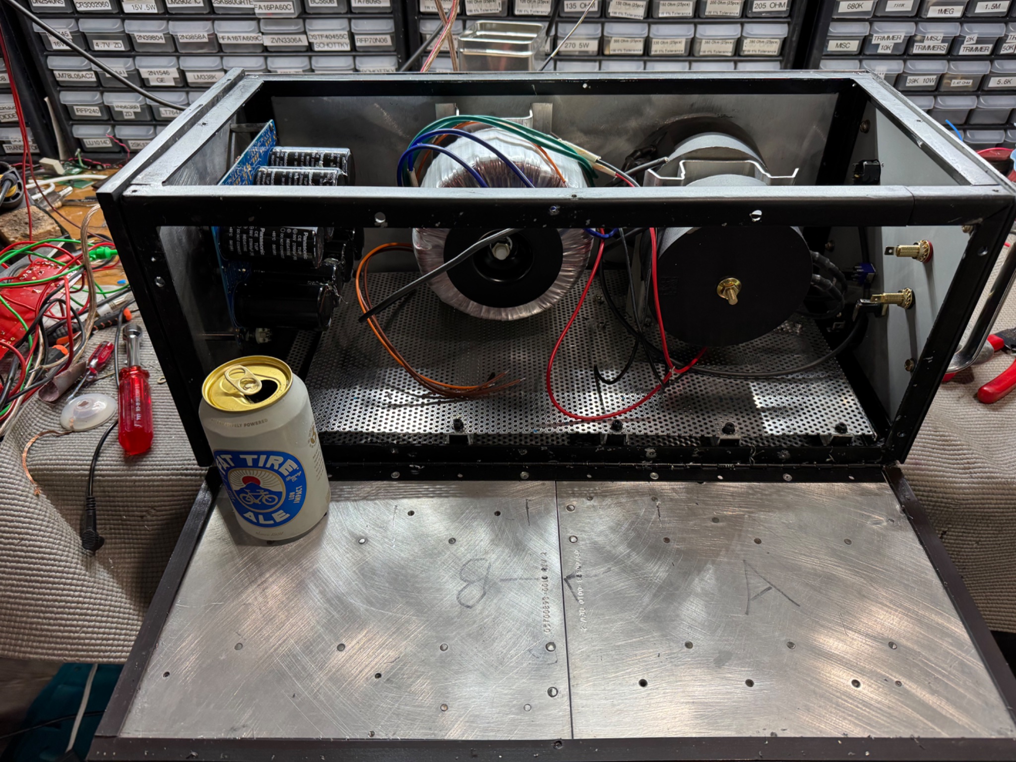

Stage 2 starting. First mono block is playing great on a klipsch bookshelf tester. Have small hum only when an input is connected. Need to check loops and grounds. Aleph J has been scary quiet. Very “black”background. Yes those are 2 30A 2.5mH chokes there. Bought them from the auction site. Stated weight was 2.5 LBS. actually they’re 3X that. Was gonna’ use them or else🤨 Stayed tuned….(only if you want)
