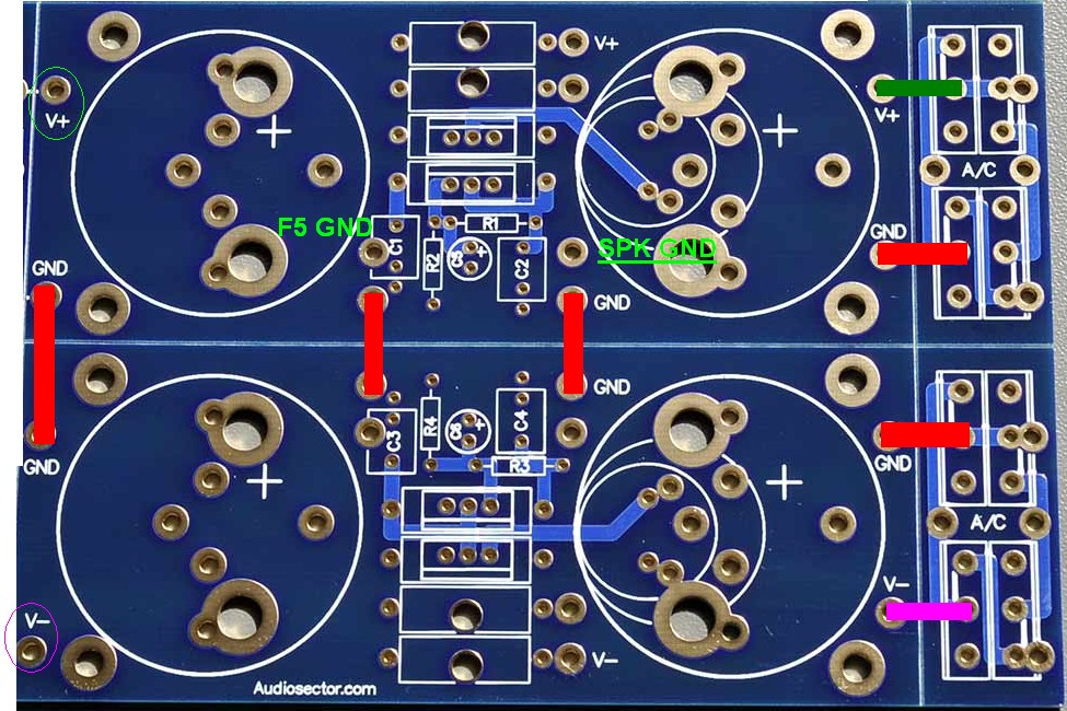

I am building a pair of F5 monoblocks. Each one with a transformer, a full diode bridge for each rail, and four 22.000uF caps with the 4x 0.1r 3w each full dual rail board.
Only one quick question: Is it ok if I put jumpers as in the way shown on the attached picture? These pads will be unused, so I am guessing that placing 3 of them could be better for making a dual supply PSU. I don't think it will make a ground loop.
Power will be taken to an F5 board from the marked outputs. These are your F5 boards. There is a wire from the F5 ground pad to the marked pad on the picture. The return of the speaker will go where marked in the picture.
Can anyone give it a quick look and check if it is alright?
FYI, it will carry all caddock MK132, and Mills for the power resistors. Capacitors are Mundorf MLytic SI, Schottky TO-247 rectifiers 🙄
I don't think I will place the thermistor and the current limiter circuitry on the F5. I want that bunch of small Hi-Q resistors and pairs of caps sounding at their bests. Adding more stuff get close to double the amount of components in the circuit.
Thanks, regards

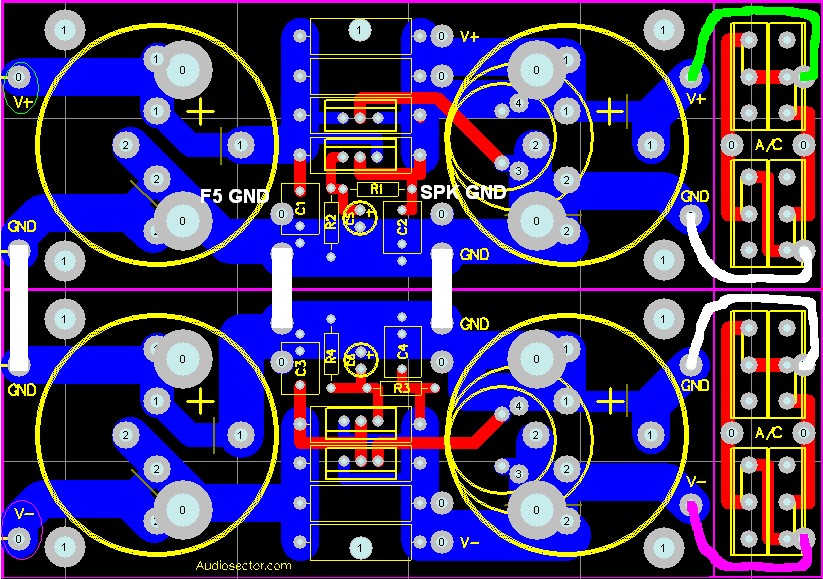

Teabag, I understand that you are joining both rail's grounds between the two gnd pads under and above the marked v+/v- output pads? Then, in which pads are you soldering the ground from the F5 board and the return from the speaker?
I'll do the same drawing in the underside, it should be clearer for you guys.
Sorry for a minor mistake. I wrongly drawed the connections from the diode bridges on the previous post. Not important for the matter.

Regi,
Don't tie the two in the middle, just one on left between v+ and v-. Attach speaker ground to it, board grounds to it, and signal ground to board or here. Then attach CL60 to it, and other side to Chassis and IEC ground. Shouldn't hum.

When you actually say "it", what are you referring to?
Can I use some pads for the task of connecting spk return, signal ground, earthing...?
I haven't yet found an elegant way to hook up grounds. Its a pity doing that way having so many holes on the PSU board.
