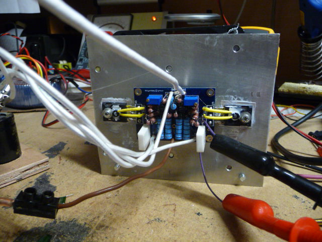

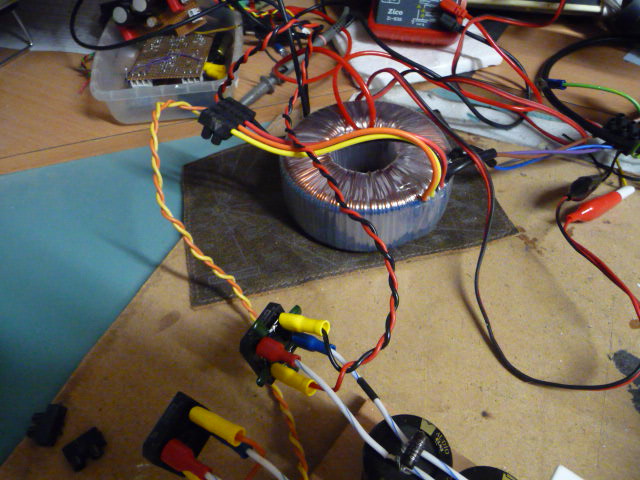

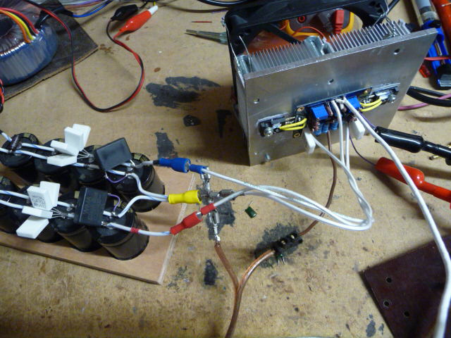

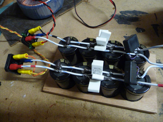

I experience some hum, or at least I think it is hum (some small multiple of 50Hz). one has to put his ear to speaker in order to hear the hum, but the target speaker is a 106DB sensitive one and the noise will be much more noticeable there. I measured the ripple of the rails while one channel is attached and properly biased (~0.59 Volts) on a scope and it is ~150mV peak to peak and similar on both rails. when the input is shorted to ground there is no noise at all. when the ground crocodile of the scope prob is attached, the nature of the noise changes.
Has anyone else experienced such noise?
one more odd thing - the rectifier bridge of the positive rail is getting hotter (by hand) than the negative one. I don't know what that hints.
Hum
the hum occurs when the input is in free air. still there is a pull down resistor just for that. I'll try hooking a source (output of opamp) and see what comes.

seriously speaking, this hum haunts me. several of my DIY attempts ended humming. I even had a GainClone the was perfectly mute, and after returning from a friend cought up humming I failed to remove. I must be doing something profoundly wrong, but I can not spot it.
........seriously speaking, this hum haunts me. several of my DIY attempts ended humming. I even had a GainClone the was perfectly mute, and after returning from a friend cought up humming I failed to remove. I must be doing something profoundly wrong, but I can not spot it.
if you leave the input open circuit you have effectively added a high impedance aerial to the amplifier.
This is never the way you connect an amplifier to reproduce audio.
