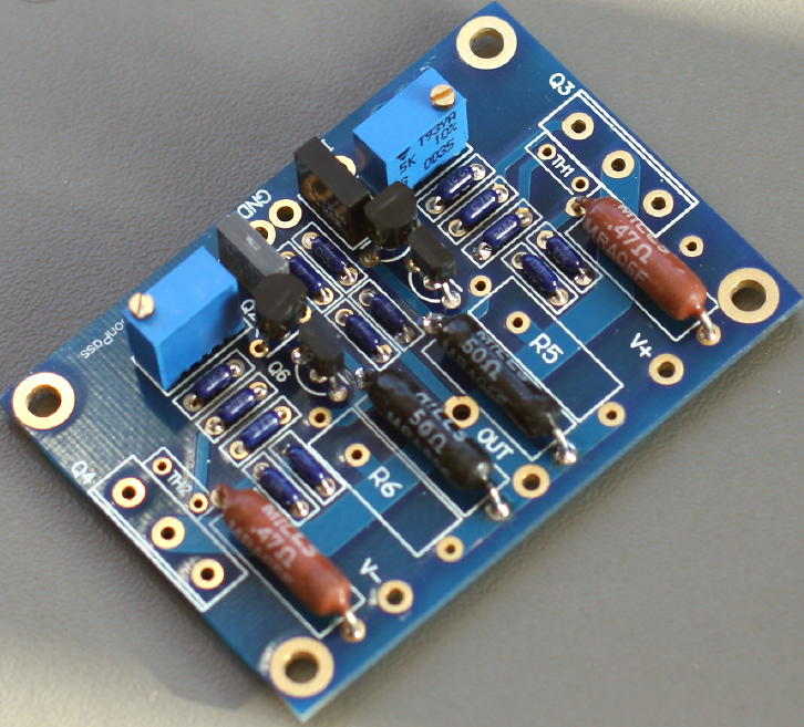

I am currently using Peter Daniel's boards, which are more compact because pad sizes are designed for Caddock MK132 resistors. If you are going to use standard axial 1/4W resistors, they won't fit without bending. I am building the circuit with the Caddocks, no thermistor for temp-co and no current limiting circuitry.

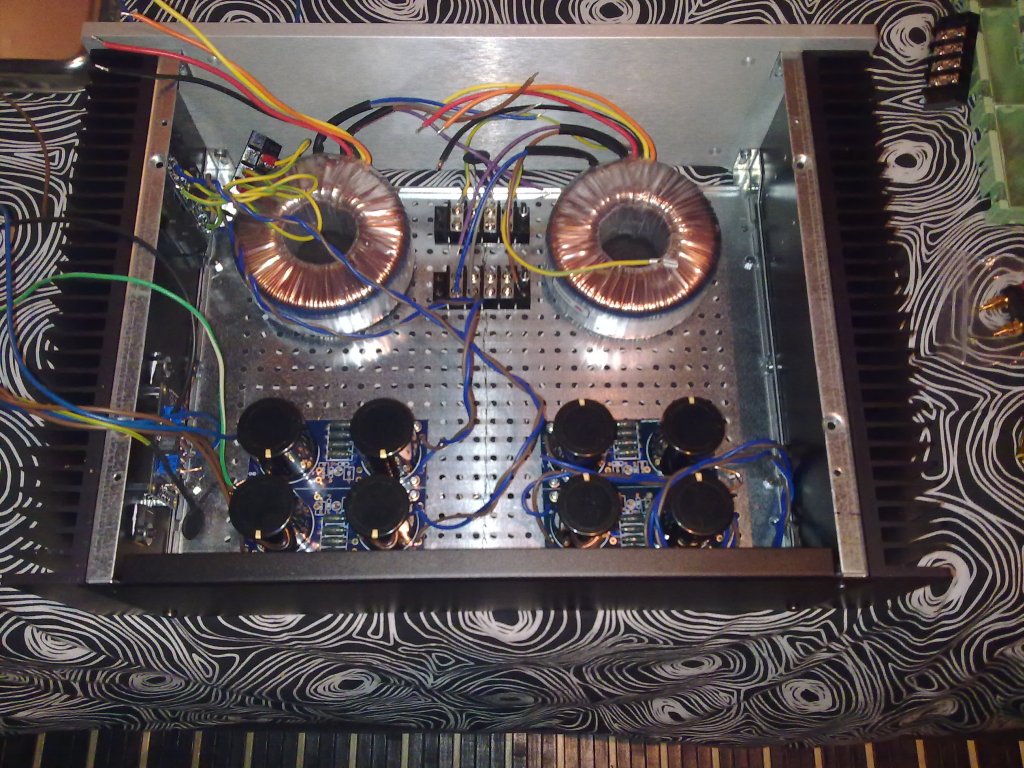

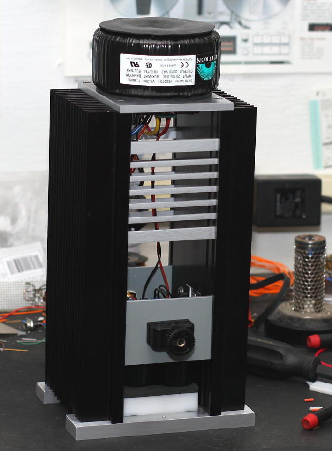

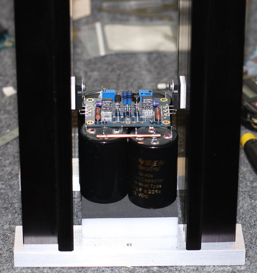

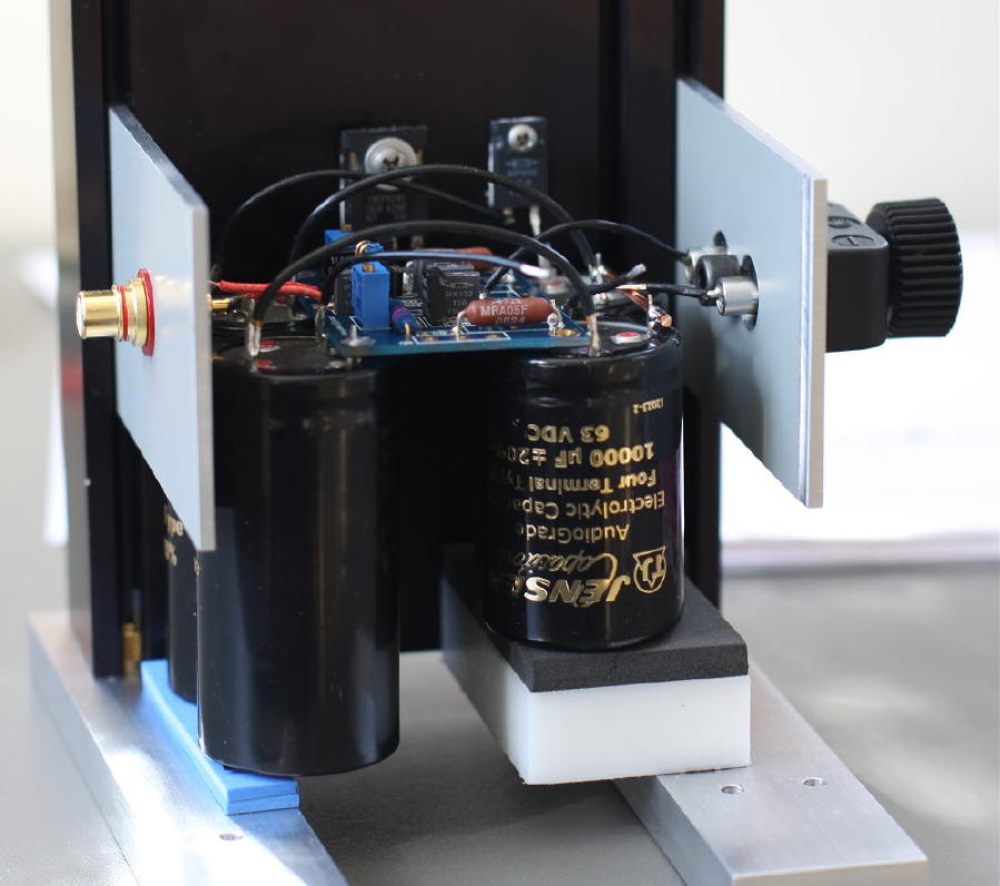

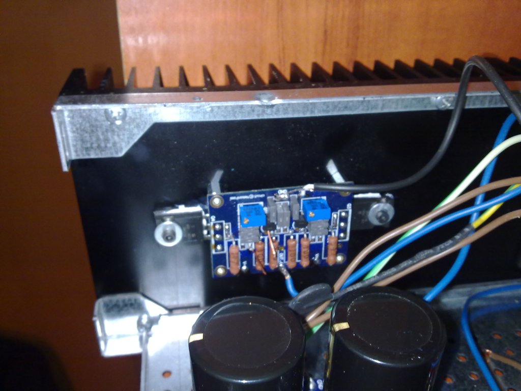

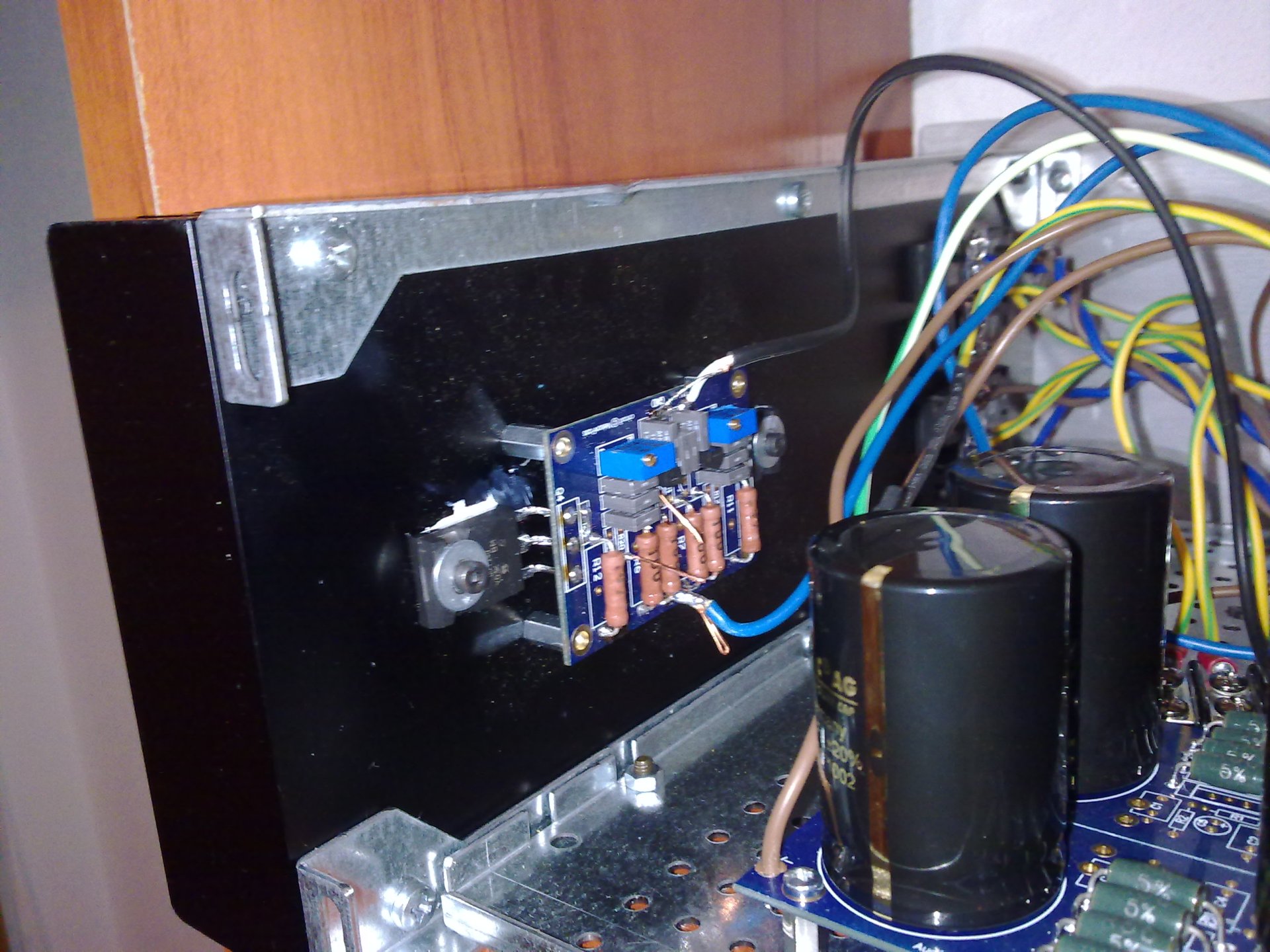

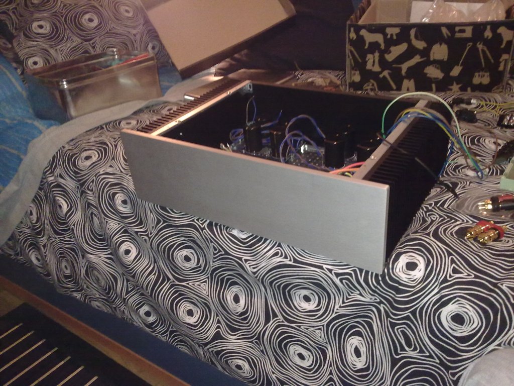

Here are some pictures.
It is dual mono construction, one PSU per channel, each one loaded with 4x 22.000uF of MLytic AG capacitors in CRC configuration. The amp adds a total of 176.000uF and 2x 250VA toroids.

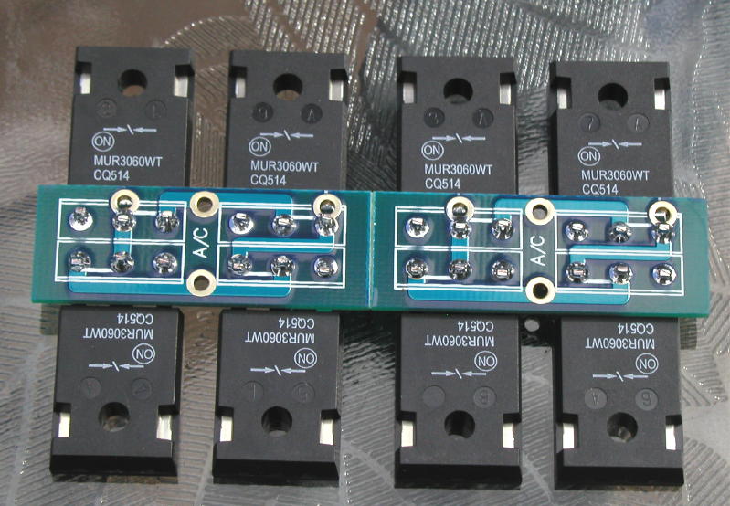

Diodes are IR Hexfred ultrafast and ultrasoft recovery. They are mounted on the heatsink too for a total of 8 per channel.
Resistors are Caddock MK132 and Mills. Output devices are IRFP9240 and IRFP240 from International Rectifier. I think that almost everybody has used them from other manufacturers, like Toshiba or Fairchild, has someone tried IR?
For wiring I am using just strapped AC power cords, because I have lots of them and because they have relatively "high" copper gauge.

I forgot to say that this is the most silent amplifier I have built. All my previous gainclones were almost dead, but placing the ear next to the tweeter it could be possible to hear a little bit noise. Now it isn't there even touching the tweeter with my ear 😀
Still have to finish it, let it burn in quite some hours and make serious listenings, but after a pair of hours playing one channel all I can say is that it is very detailed, sometimes too much, but I like that new sensation. It's like "ehhh, I don't want to hear THAT! and THAT neither!" he he he.

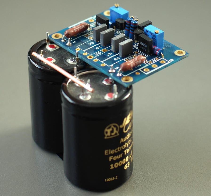

Glad to hear more boards will be available. Looking at your fourth pic across the top, the one that shows th amp in seperate pieces, I notice the wires going to your diode boards are fairly thick. I found the holes in the diode boards to be very small. How did you fit such large wires? Reaming out the holes? I was afraid that might mess up the contact to the pad?
Thanks,
Russellc
Russel, using TO-247 devices, there are two options, two or three legged devices. I had the ones with 2 legs, so I had to bend one pin once inserted in its hole to reach the next hole and solder it there. That will give you a quite "big" area to solder heavy wires, right onto the leg.
According to 300VA Plitron datasheet: http://shop.plitron.com/specs/0770XX201.pdf those are 14ga wires and this is what I used without any need to enlarge rectifier board holes.
Anything bigger is really not needed. However, you can always make the holes larger but make sure wires are soldered to pads on both side of the board.

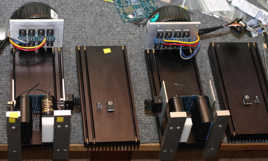

what would an output stage look like when done that way?
Ready to plug in a Mongrel style front end.
Quite sexy leaving some clearance between the mosfets for to-220 power resistors 😛what would an output stage look like when done that way?
