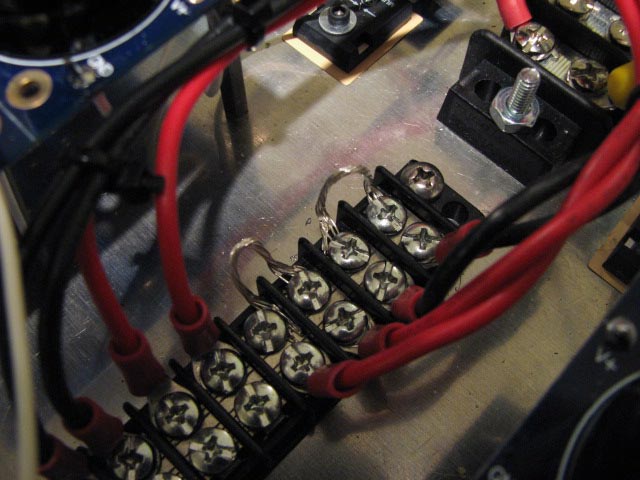

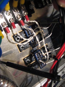

Here's some pics;

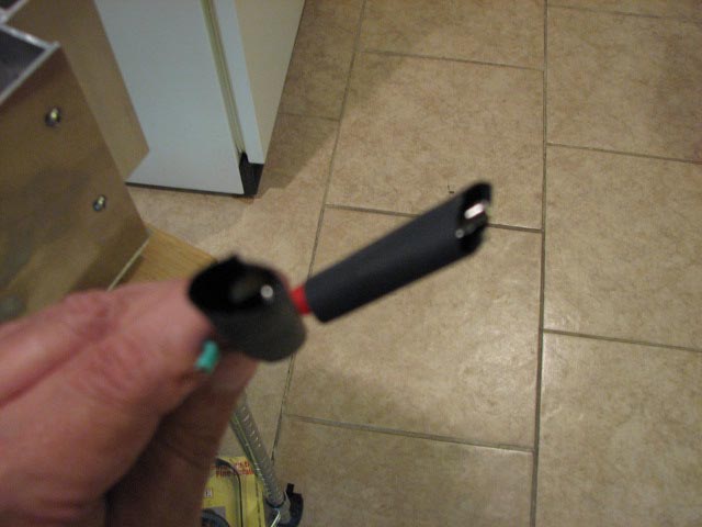

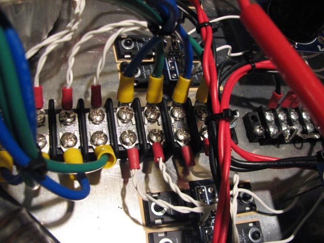

First is the temporary "plug" With alligators attached to clamp onto the transformer primaries, which can be seen connected together with temporary straps for the alligators to clamp onto. Next shot shows transformer and secondaries going to other terminal block, then next shot shows the white leads going to the diode boards. Measuring where the secondaries attach to the termonal block, each of the two pairs measures 17 volts, I dont think the variac was quite all the way up...

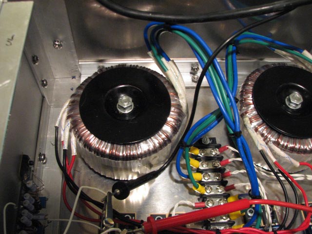

50 volt measurment taken with black multimeter lead on the V-, and the red multimeter lead on the V+...

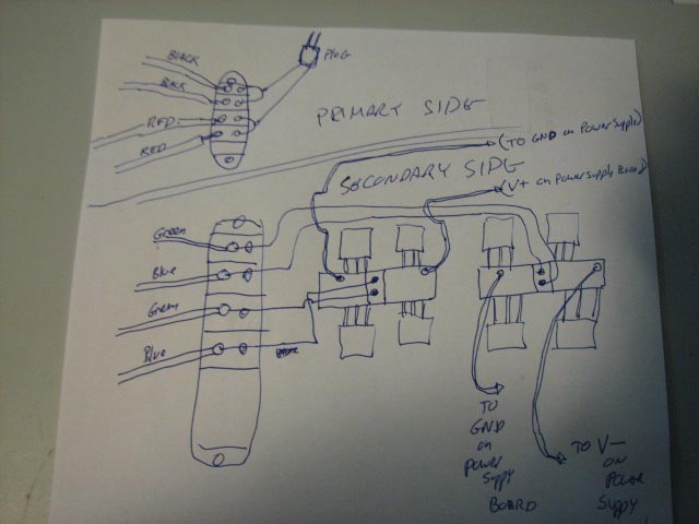

thats the problem. your feeding the boards ultimately two 22-25v connections.
Take one v- and one v-. The ground in the middle ties then together for return.
Your cool.😀
All output ground connections should go to the red spot id'd on peter's shot a few posts back. tie a wire down there and connect all Ground signals to it.
Solder a CL60 thermistor there, and attach that to chassis ground a IEC earth ground.
sorry, but I'm a little dense here, not sure what you mean by this? Could you describe where I went wrong by my crappy sketch?thats the problem. your feeding the boards ultimately two 22-25v connections.
Your cool.😀
are you saying to ignore one set of secondaries? Sorry, I'm not understanding...

What are you getting when one lead is on V+ and the other on GND?
26 volts DC
Russellc
your good. Measureing v+ to v- itself doesn't mean anything.
v+ to ground is a mesurement
v- to ground is another.
Is this how its supposed to be measured? ( red to V+ or V- and the other to ground) or from V+ and V-?
Russellc
russellc
Russellc
yes.

Ah, thank you Tea Bag! I guess I just measured from the wrong points. Back on the launching pad it goes! Sorry to be so thick on this, i just dont want to throw the switch for disaster!😱
