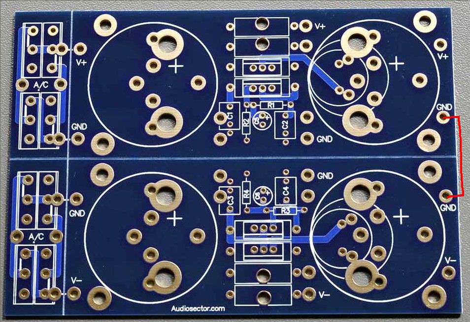

The caps shown in a drawing are on the power supply pcb. The connection between the caps is the power star ground. There is only one wire from amp pcb to that power star ground. The ground from RCA is a signal ground and it connects directly to amp pcb. The power star ground is located on PS board (if you are using one).
Two last questions Peter, where on the power supply board does the wire from the amp pcb connect? Secondly, this star ground must also ground to the chassis?

If you are using my PS boards, you need to connect grounds from positive and negative sections together (red jumper in attached pic). This is your power star ground and here you also connect the output ground to the speakers and signal ground wire from amp board.
Chassis connects directly to Earth ground from power entry module, power star ground connects to chassis through CL60 thermistor (as in schematic here, page 18: http://firstwatt.com/pdf/prod_f5_man.pdf )

Whoops, I tied them together, but did so at the pair of grounds next to the pads for c2 and c4. Do I need to move it, or is this OK?
russellc
It's perfectly fine, actually even better.
As to the ground wire from the amp board and the wire going to the negative binding post ( output ) can I attach them at the other ground "holes" on the PS board, or should I strip the jumper and attach them directly?
Sorry if this is too nit picky, I think I'm done now!
Russellc
I don't think there would be a problem connecting them to other pads, although doing it centrally would be more accurate.
