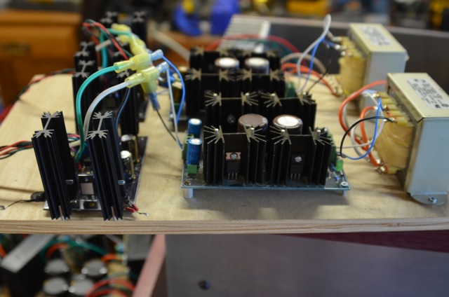

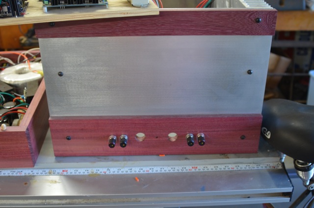

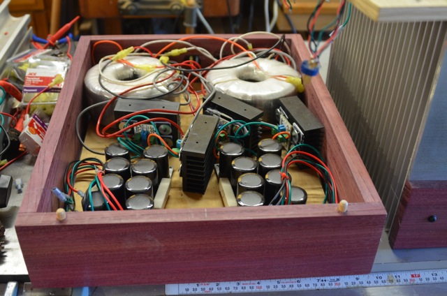

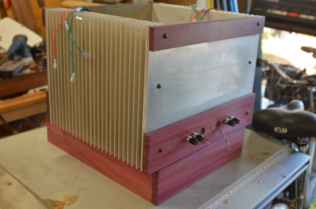

BA3b + crippled F4 up and running on workbench
Hopefully in system this weekend
Modular so I can lift it
Pix - power supplies, main box which houses F4 boards and BA3b set-up, BA3b boards courtesy of buzzforb(many thanks), integrated components
Will try to get pix of inside a bit later
