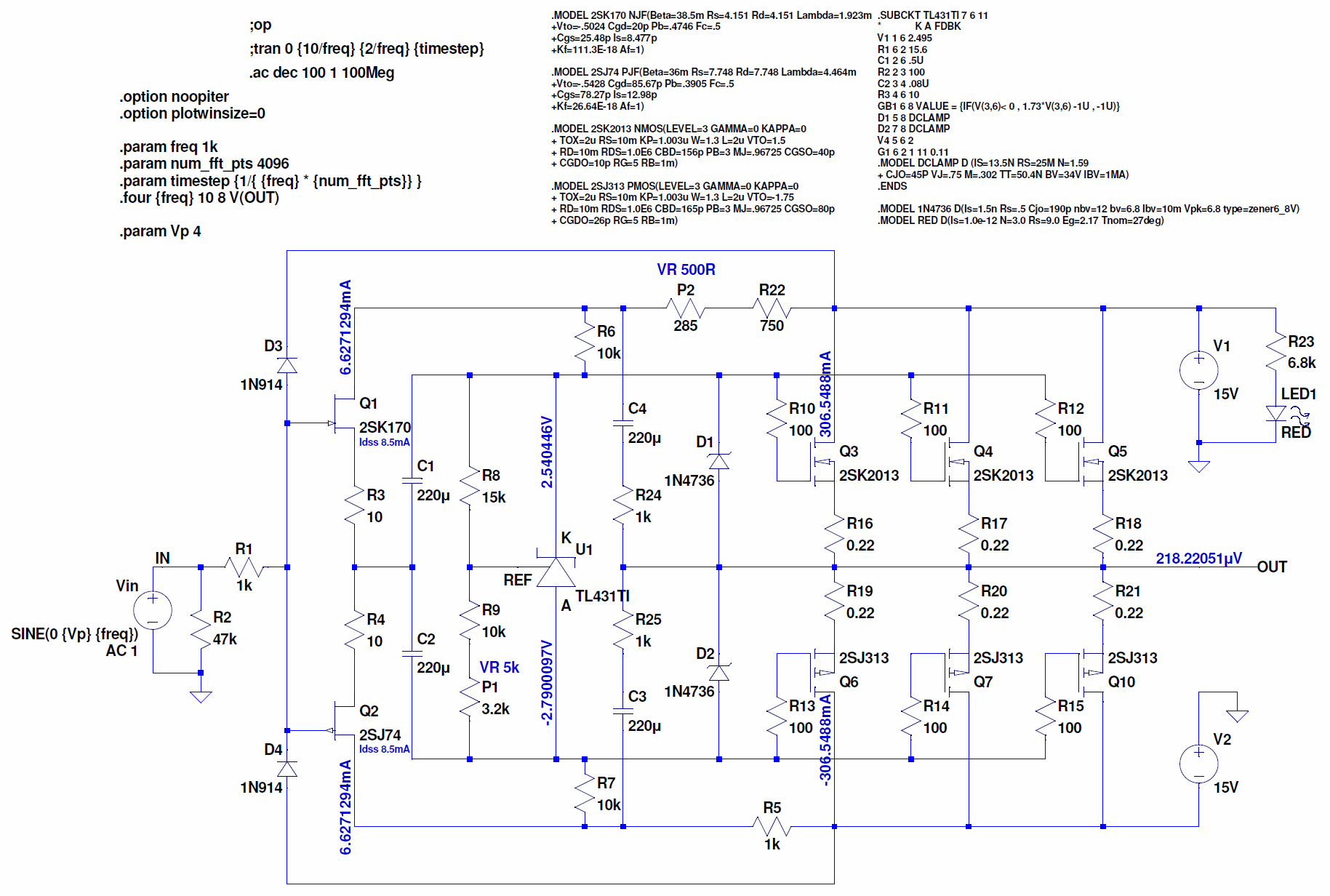

F4 low power
I'm thinking of building a F4 that max out at around 12W, because 10W is enough for me and my source+preamp gives only 14V anyway (2V DAC out, x7 preamp gain), and I want to avoid unnecessary heat dissipation.
I modified the component values a bit, got the attached and it simulated OK in LTSpice, but I would like some comments from the experienced ones, to see if I made some stupid changes.

- Q1/Q2 are 2SK170/SJ74 as I don't have 2SK370/SJ108;
- MOSFETs are 2SK2013/SJ313 as I have some, and they seem to perform better at lower bias than the IRFs;
- Preamp is LuminAria, it can swing 60V with 50mA current, but the gain is only x7 and I don't need/want to add another gain stage;

Ofcourse you can lower voltage rails and bias current to have lower power amplifier, but performance will be worse. Why? Because F4 has no error correction loop and MOSFETs are more linear at higher currents and higher voltages (less non-linear capacitance), especialy at rail voltages lower than 20V non-linearity starts raising quite a but, just look at datasheets. So yes, your amplifier will work and can sound good, but it will not sound as good as original F4.

With three pairs, supplied with +/-20V and 400mA through each pair it sounds noticeably better than original F4. Lowering the PS voltage to +/-16V changes nothing except the output power.
I used 0R33 source resistors.

k2013/j313 MOSFETs have lower capacitance, but also lower transconductance. So you have higher output impedance (lower damping factor) than with IRFP240/9240 MOSFETs. Apart from DF, Toshiba MOSFETs are more linear and they do not have IRFP P-channel problem.

Hi Juma, this is very reassuring, thanks 🙂. Given your comments I've decided I'll build it, instead of just "thinking of" in my earlier post.
Hi kacernator, the simulated THD1k 8R@1W is around 10ppm, and output impedance is around 0.66R which gives a DF of 12 - I think it's not too bad, though it's true that the original F4 have a higher DF of 40.

Well, I think Q2 is in wrong. Generally though, these "short channel" JFETs work the same in both directionsHi,

Well, I think Q2 is in wrong. Generally though, these "short channel" JFETs work the same in both directions![]()
Indeed it was a mistake, thanks for spotting that.
