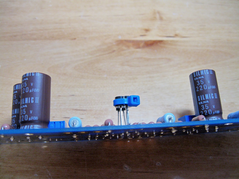

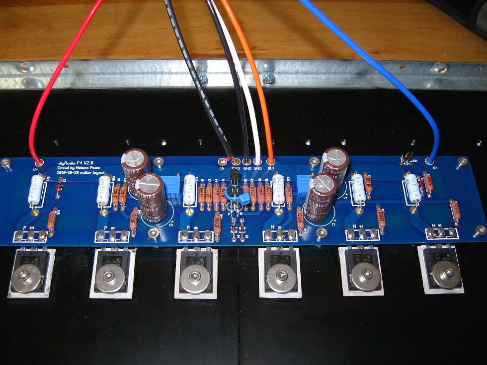

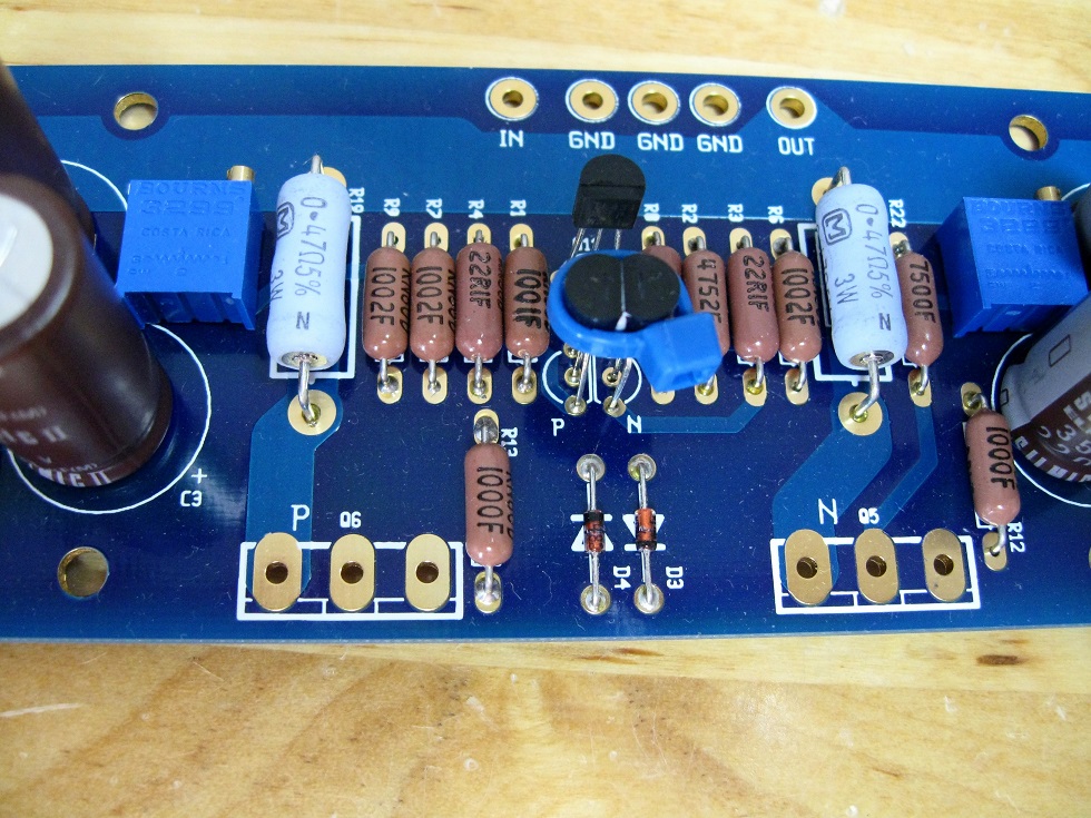

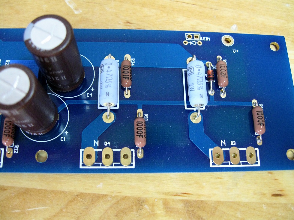

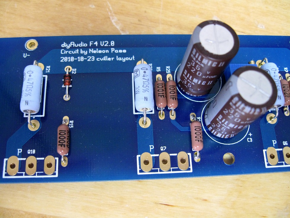

I completed my F4 and started one channel using a power supply that I had previously used, for a few months, to power my F5 built on Peter Daniel's boards.
I connected one multimeter across R21 and the highest bias I can get is 90mV. At that moment the multimeter connected across R16 measured 62mV and the DC offset at the speaker output was close to 1V.
I tried the second board and the results were similar. In both cases, with a speaker connected to the output, when touching the input with my finger I can hear a buzz. Whatever mistake I made, was apparently repeated on both boards and fortunately, not fatal.
The component values were taken from the BOM downloaded from the DIYAudio store. The JFETs were purchased many years ago, while they were still in production. I selected devices which measured about 8.3 mA IDSS (using 5 1/2 digits multimeter). The MOSFETs are IRFP9240 (P-channel) and IRFP240 (N-channel) matched to within 2 mV. All components were tested before soldering them on the board. The Zeners (D1 & D2), which are hard to read on the pictures, were taken from the bag in the last one.
Any ideas of what could be wrong?

Zen Mod,
While double-checking the values of the components against the BOM in the DIYAudio store, I noticed that some resistor values do not match the schematic in the F4 manual. R3 and R4 in the BOM are 22.1R and in the schematic 10R. R8 is 22.1K vs. 27.4K and R10, R11, R12, R13, R14, R15 100R vs. 150R in the schematic.
I usually bend the Vishay resistors' leads so the values remain visible after placing and soldering them to the PCB. When I posted the pictures I was hoping that some other member could spot something I may have missed. Can you see a mistake?
I don't mind attaching another resistor in parallel to R9 to lower its effective resistance, but I would like to understand what is causing the problem. Would you have a schematic with some expected voltages marked on it?
Official Court Jester
Joined 2003
that's why I strongly despise public BOMs - every second guy is using wrong BOM :rofl:
and , that's why I'm always insisting on writing "ref. to ....", 'cause there is so many variations of projects that at least I am lost ........
point me to exact sch you're using (I'll ignore BOM) and I can comment is there anything wrong
edit - looking at sch (mentioned in my previous post) all differences are irrelevant ......... except R8 (upper TL431 resistor) - make it 27K , as Papa intended
