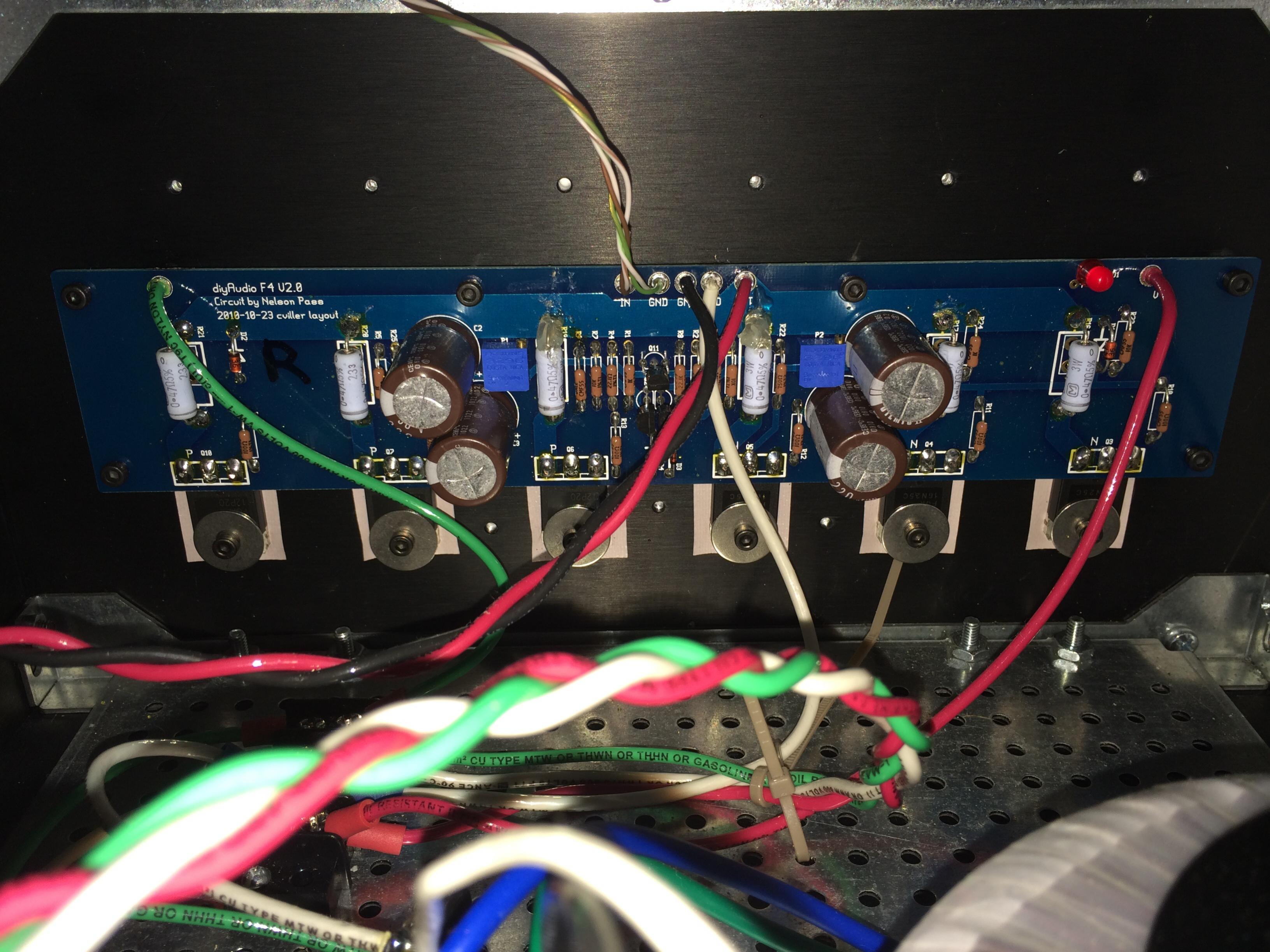

I opened up the F4 in my study and have taken some photo's. As you can see that I have removed the 2 top/middle screws from the PCB's as suggested by Itsmee. The PCB's were not damaged beneath the washers, so I do not think this was an issue.
You can also see the 1R2 resistors I added previously (parallel to R3 and R4, as suggested by Nelson; it does not look nice but it was just to see if it solved the problem).
Let me know if you require photo's of any particular details.

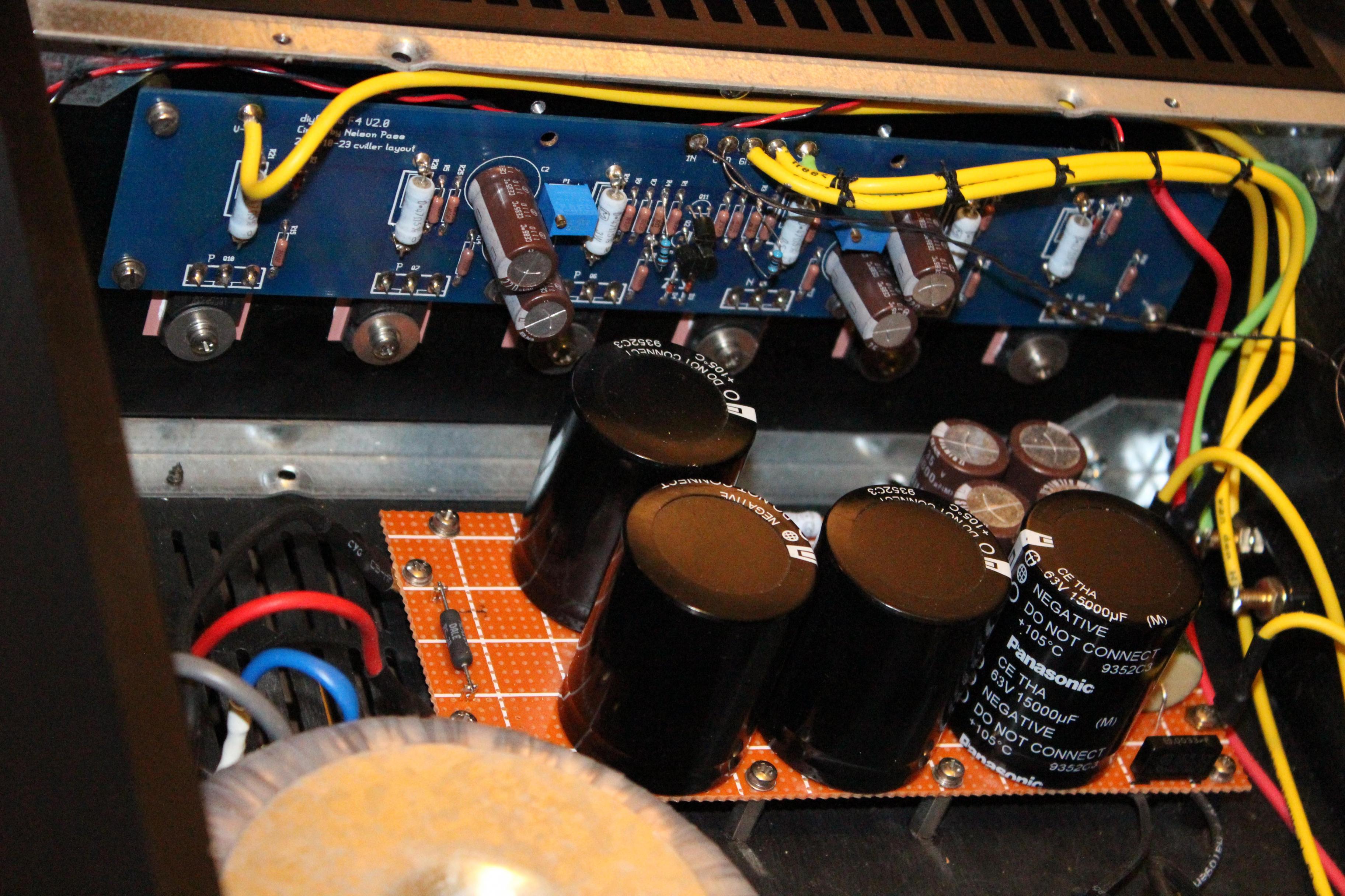

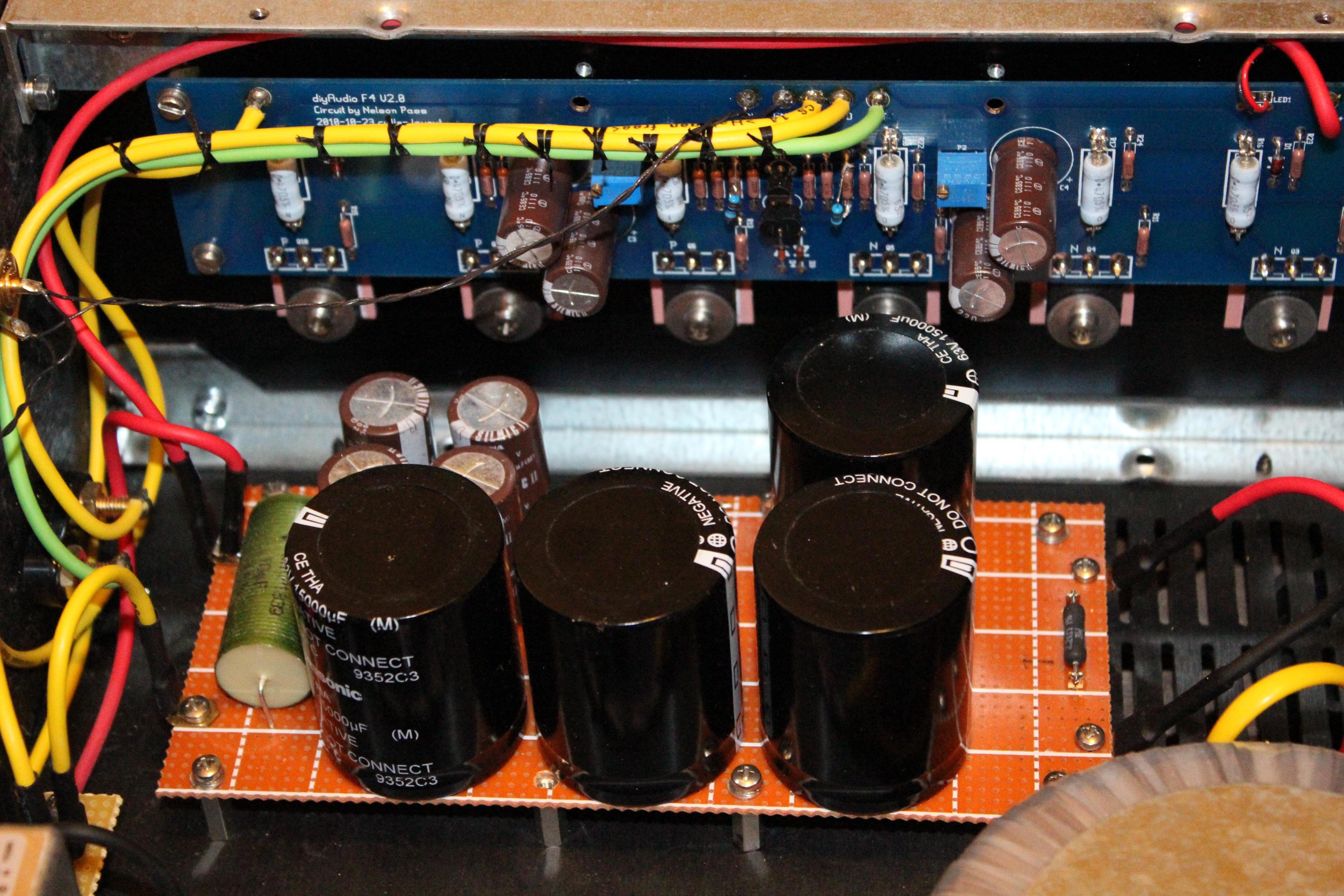

The photo's in message #4122 are of the F4 that I have in my study (the photo's in message #4114 were sent to me by my friend some time ago and I think they are the other F4 amp).
