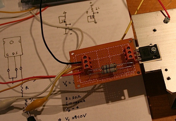

really don´t trust myself to do the matching.
You would be surprised how easy it is and once finished you'll be more confident about building the amp yourself too.
I just followed Nelson's circuit on a small piece of proto-board and life was easy. And I have the board to use again as and when it is needed.
Looks easy. Thank you!

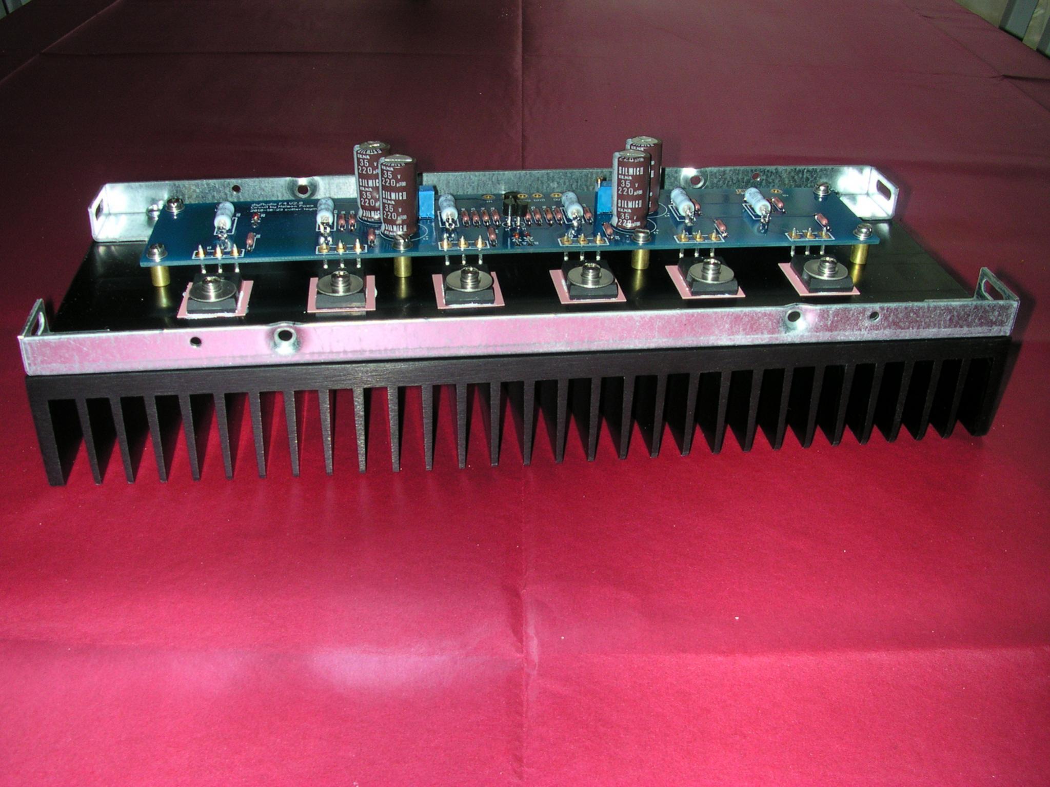

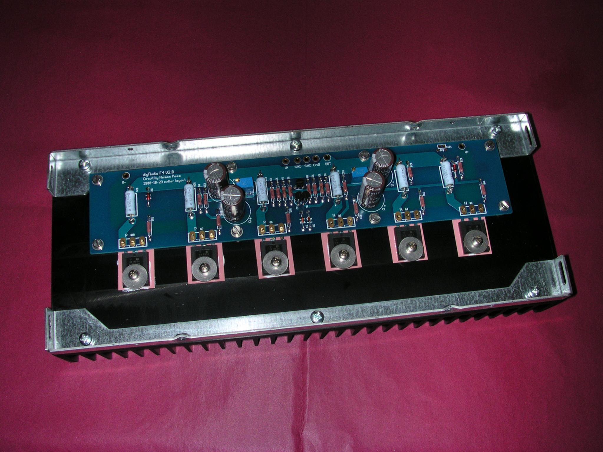

Hi guys, I have a problem with two DIY F4's and hope you can point me in the right direction. A friend of mine (a retired radar engineer) put them together for me. He biased the F4's to 250mV and the sinks of the Modushop 300mm 3U enclosures stabilize at about 55C. Source of parts A few years ago I bought F4 PCB's from the diyaudio store and F4 semiconductor kits from tech-diy. All other parts were sourced from digikey, mouser and farnell (i.e. no ebay junk). The power supply (see attached) is similar to the standard F4/BA PS. I inserted a single F4 (stereo) into the system in my study but the sound is not good. There is plenty of unrefined/harsh bass and highs but not much mid. Overall it sounds more like cheap hifi than the F4 should. Preamp gain BTW is not the issue (volume pot at 12 o'clock is loud) and the system sounded great before I replaced my DIY Aleph J (volume pot a 9 o'clock is loud) with the F4. Replacing the F4 by the Aleph J brings back the magic. BTW: It is not that I miss the Aleph sound (I know the F4 is supposed to sound different), it just sounds bad. I have used other power amps in this system and even cheap ones sound better than the F4 does at the moment. Thinking it might be mismatch, I installed the second F4 in my main system where it replaced (a Pass Labs original) Aleph 3 that I use for mid/high on Magnepan MG3A's. The Maggies are insensitive, so I knew that I would not be able to play them loud. Forget about playing it loud, it just sounds bad. Because the sound is bad from both F4's I have no idea what could be causing it. People have talked about fake JFETs from ebay in the past but I have not heard of people having trouble with those supplied by tech-diy. Before I take my F4's apart I hope you can give me some idea what to look for. Your help is appreciated. Thanks, Albert Edit: I cannot get carriage returns to work properly, sorry.

What grade are the Jfets? you have to look on the transistor face.
Hi 6L6,
I am not sure of the grade. I think that at the time tech-diy mentioned on their website that they ran out of BL and supplied GR. I had a look at some old photo's my friend sent me while he was building them, but they do not show enough detail (see attached).
I will have to open up the enclosure but that is a bit of a problem (wheelchair user, I have to get someone to help me). Hope to find out in the next few days.

PPS I forgot to mention that both F4's are dead quiet. No hum or anything like that.
