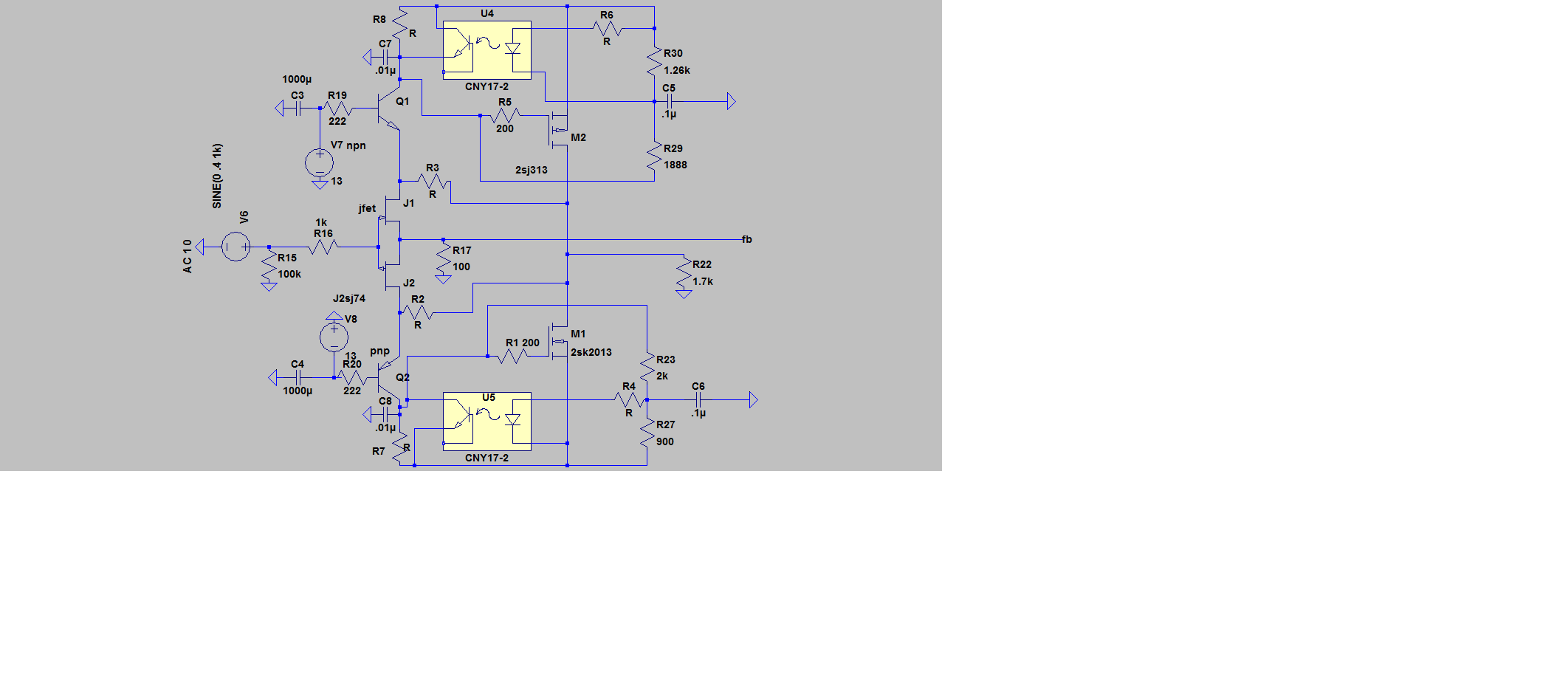

The circuit I posted above would not have worked for other reasons, r27 is to small. It would have to be about twice as large. Also the bias supply voltages have to be raised for it to work properly. But it would not be practical since r27 is to large as Zen pointed out.
Still need to finish off mounting binding posts and iec socket on each monoblock.

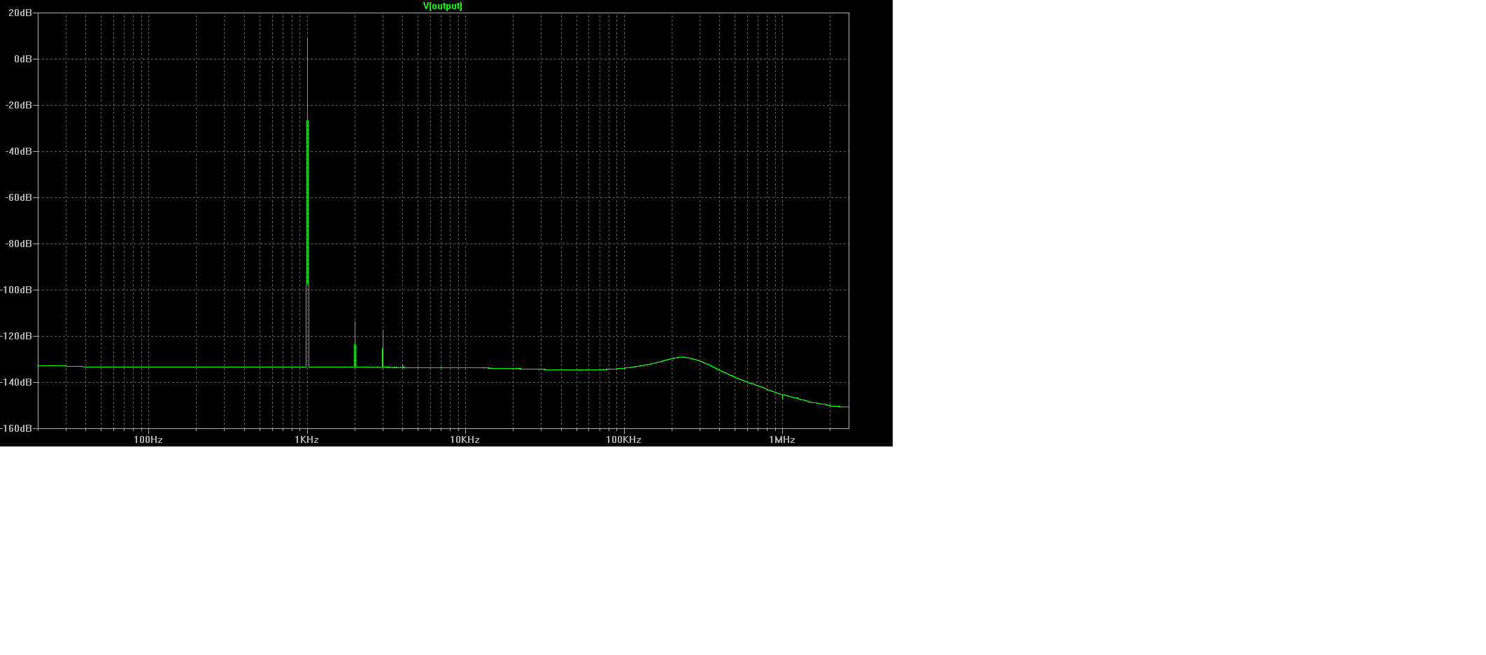

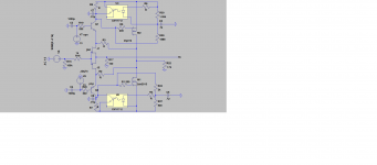

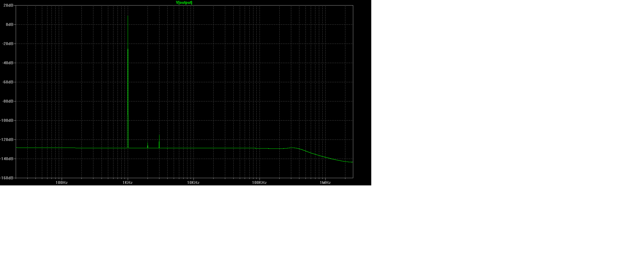

I connected the optocouplers to the amplifier as in this circuit to see what it would do. With the optocouplers first turned off the the distortion floor was flat across the bottom to about 200khz with about 400ma bias. Then I changed the resistors on the optos diodes until the bias reached about 60ma. As soon as the optos began to turn on it started to hump up at about 200khz but the THD (0.00009%) got better.
I would not worry about that hump. Sometimes these things are artifacts of the LTSpice simulation. See what happens when you change the parameters used in the Transient_Analysis or the FFT. Make sure that all compression is turned off in the Tools/Control_Panel. Also make sure you are using double-precision floatinh point calculations by adding ".options numdgt=9" to your .asc file.
I had those settings already set but thanks Lynn. I have the same circuit but without the optocouplers and when I added .07uf caps to ground to the jfet side of the cascode resistors it acted different with each circuit. It created an ugly hump on the original circuit but only seemed to shifted the same hump down to 350khz on the opto circuit. This also lowered the distortion on the opto circuit to 0.00005%.

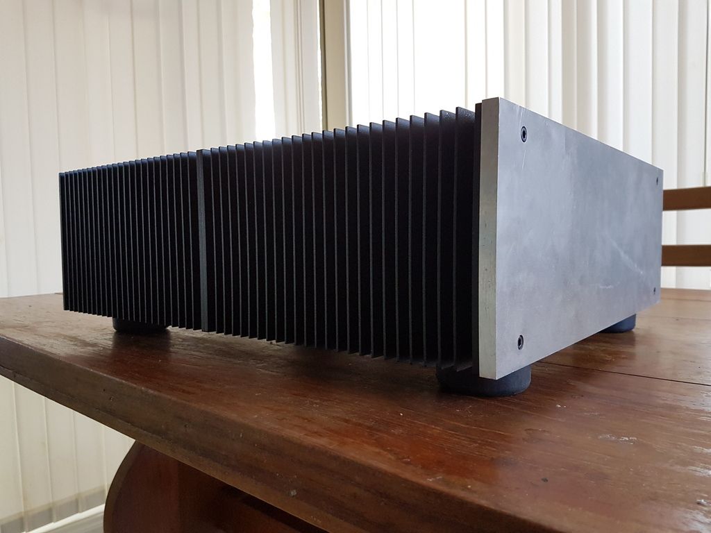

Just to let you all know I'm back after being away on business and going to get this prototype built today.[/ATTACH]
Mislaid the TL431's will have to a and buy more today hopefully powering up tonight.
Thanks 2 picoDumbs. What is the max supply voltage that I can safely apply to this output stage obviously it depends on the bias current?
In your version that we cannot wait to see the finished what bias are you running and supply volts? I currently run my F6 with around 1.8A and a supply of about 27V with 5U deluxe case and it it just warm. I'm going to assume the Hockey pucks can dissipate the heat better so can take a higher bias?
