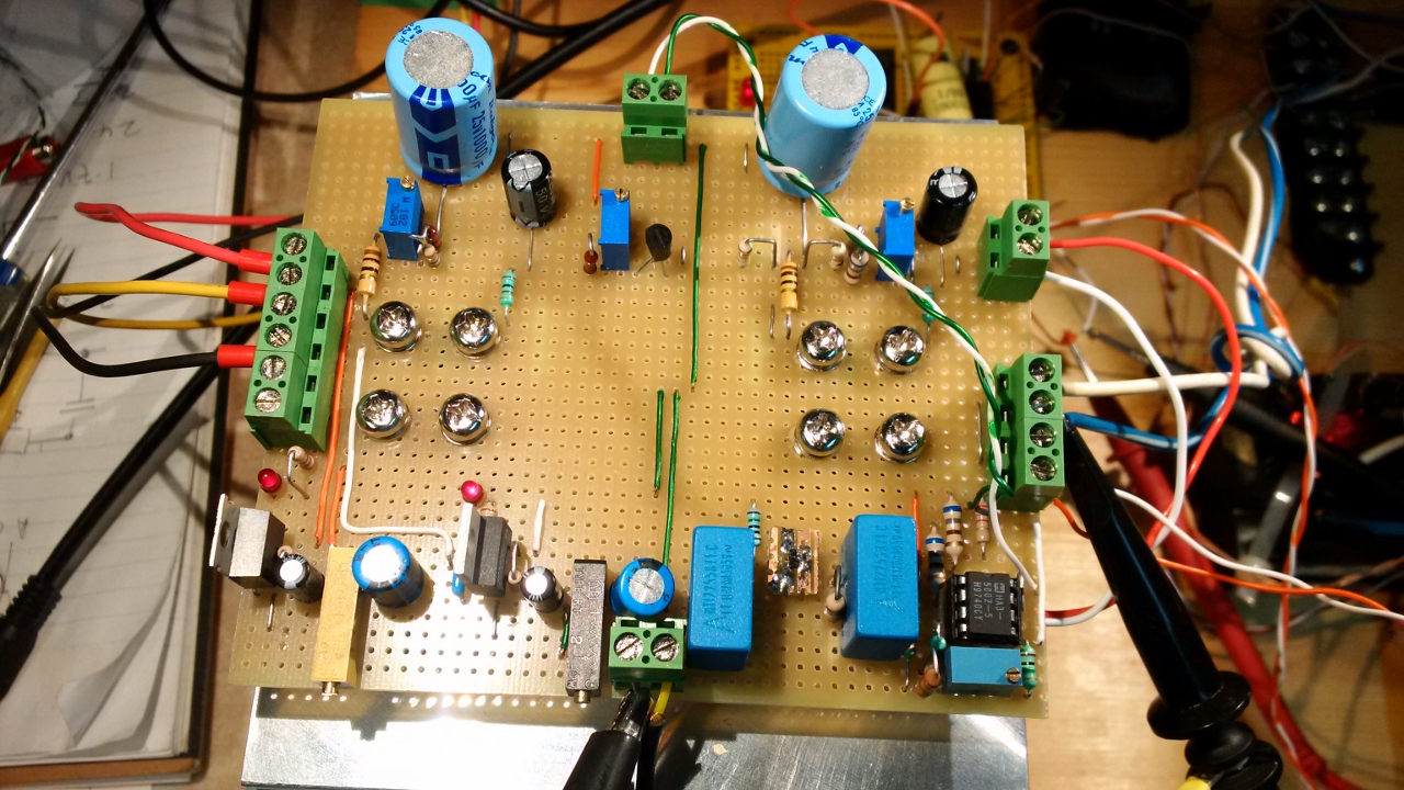

OK no magic smoke it appears to be alive! Currently running an 800mA Bias with 24volt supply and it is producing about 4 Volt peak to peak into an 8ohm dummy load.

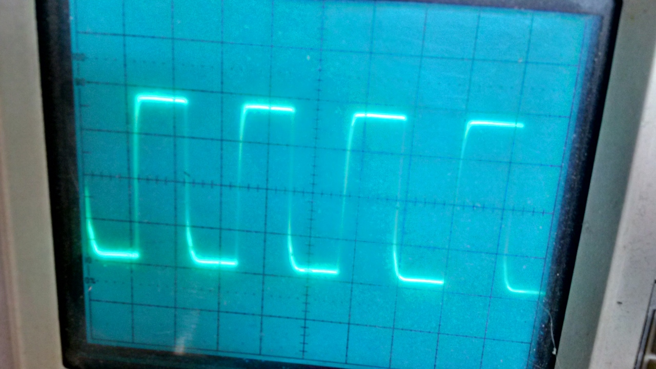

This is the waveform at 80KHz there is some strange rounding on the negative slope this is mimicked at the input as it appears to load my 50ohm output signal generator.
I'm also getting an offset of about 0.69 volts and the offset pot will not let me reduce any further possible big miss match between the hockey pucks?
Also the trimmer in parallel with the thermister has a huge effect on both the offset and bias is this normal?
Will not be able to connect it to a speaker until I have resolved this huge offset. Stay tuned.
OK update, I keep forgetting these lovely amps are class A and in my excitement to get this up and running must remember to let them get up to temperature before doing any serious tweaking or trying to put music through them.
It is now rock solid pulling 800mA at 24 volts supply 0.2mV offset and the frequency response goes way beyond 250KHz!

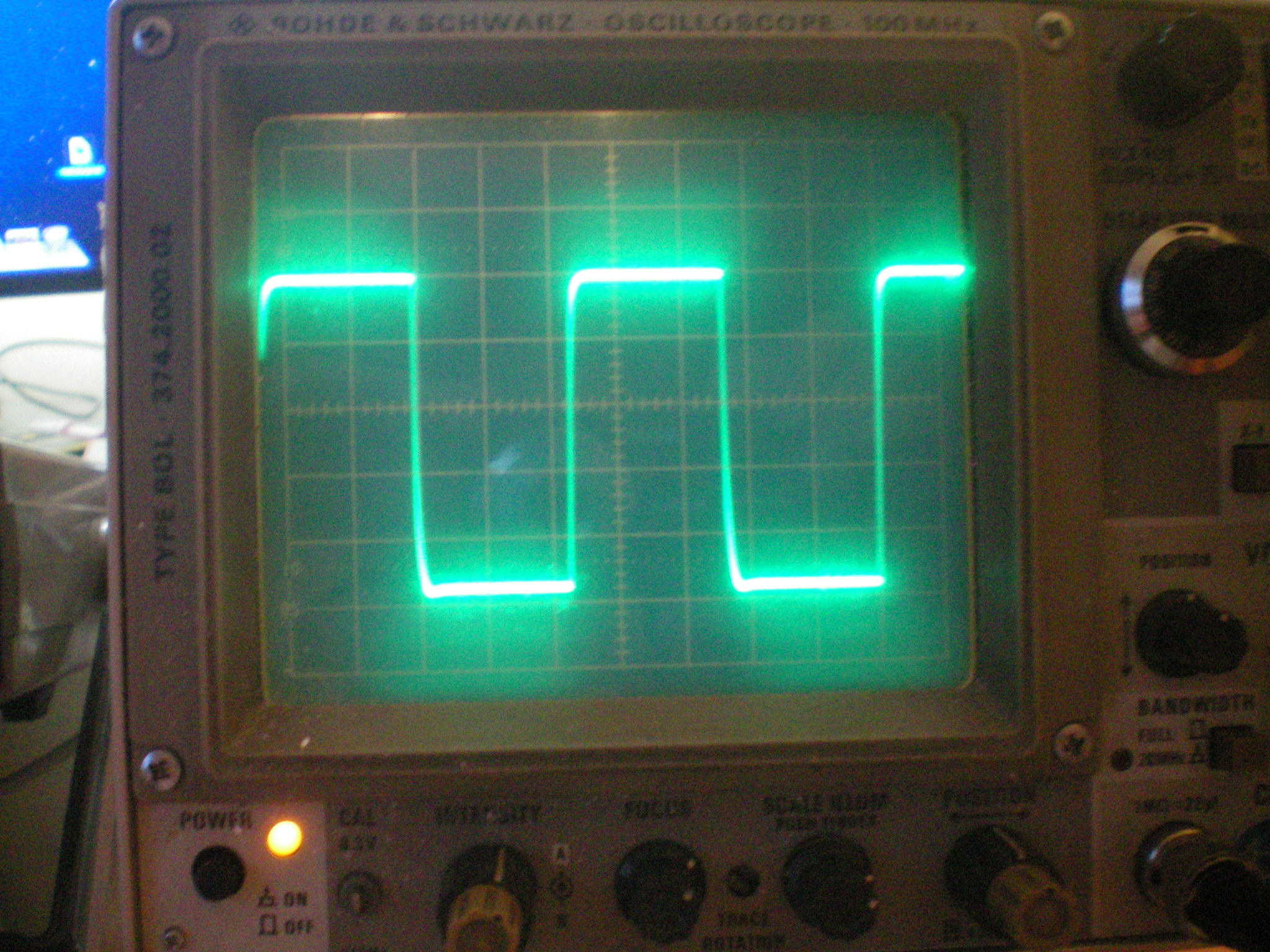

Concerning stability....
at least my "running at home" version with no source resistors at the J-Fets and at the pucks but with 47R at the sources of the SK/SJ
seems to show no oscillation.
10kHz around 4.5V/8 Ohm
I have not much experience in judging rectangles so tell me what you think, please.

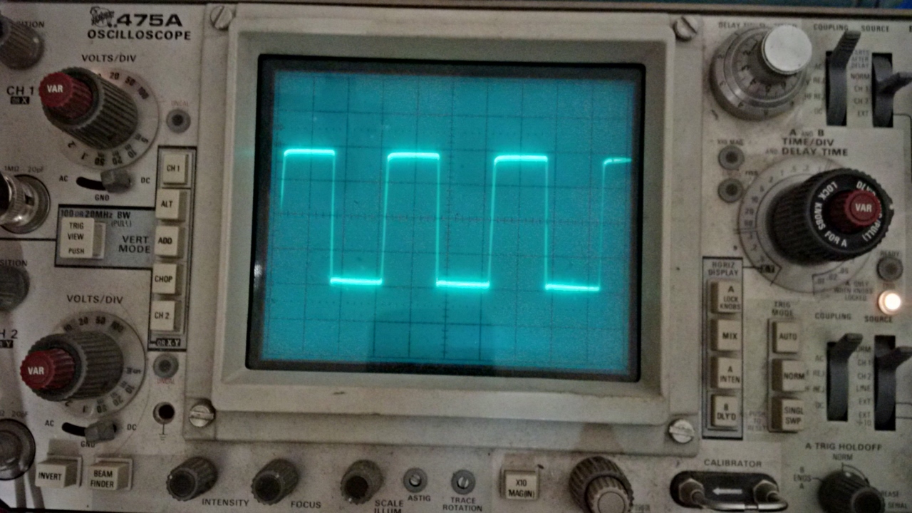

Well finally got the front end done with the HA5002 buffer with a PMBF 4393 Fet.
Still running wimpy power supply 24 volts at 800mA bias but am able to get the buffer to swing plus minus 20V. So here is the beast at around 15V pp into 8ohm dummy load running at 150KHz really nice square wave. (Starts to round off at around 230KHz but its -3dB point must be somewhere out in the MHz!)
