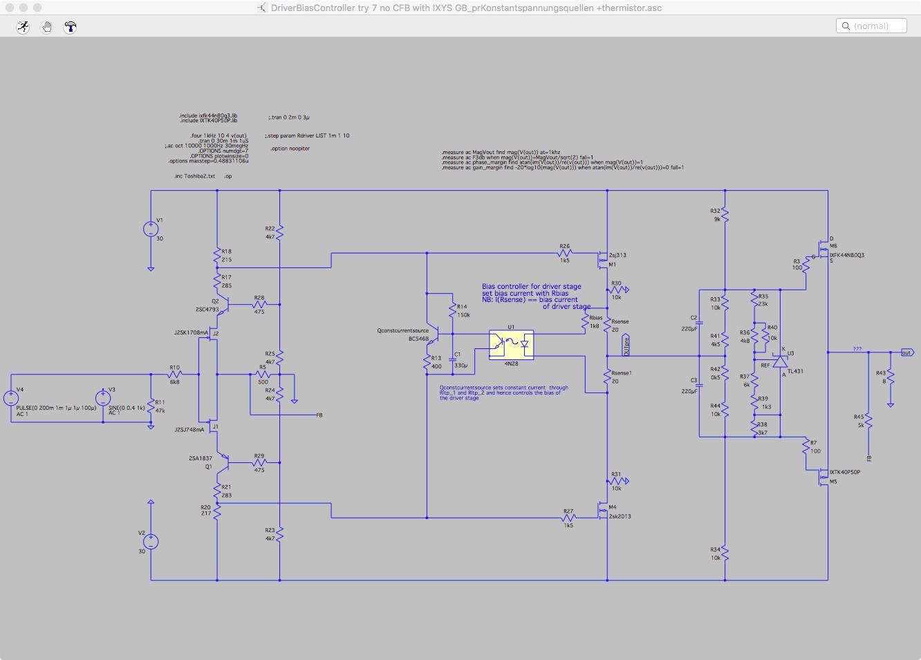

Hi friends,
PR was so friendly to combine the best of both worlds.
His driver bias opto control idea with the thermistor stabilization of the IXYS.
Spice data will follow....

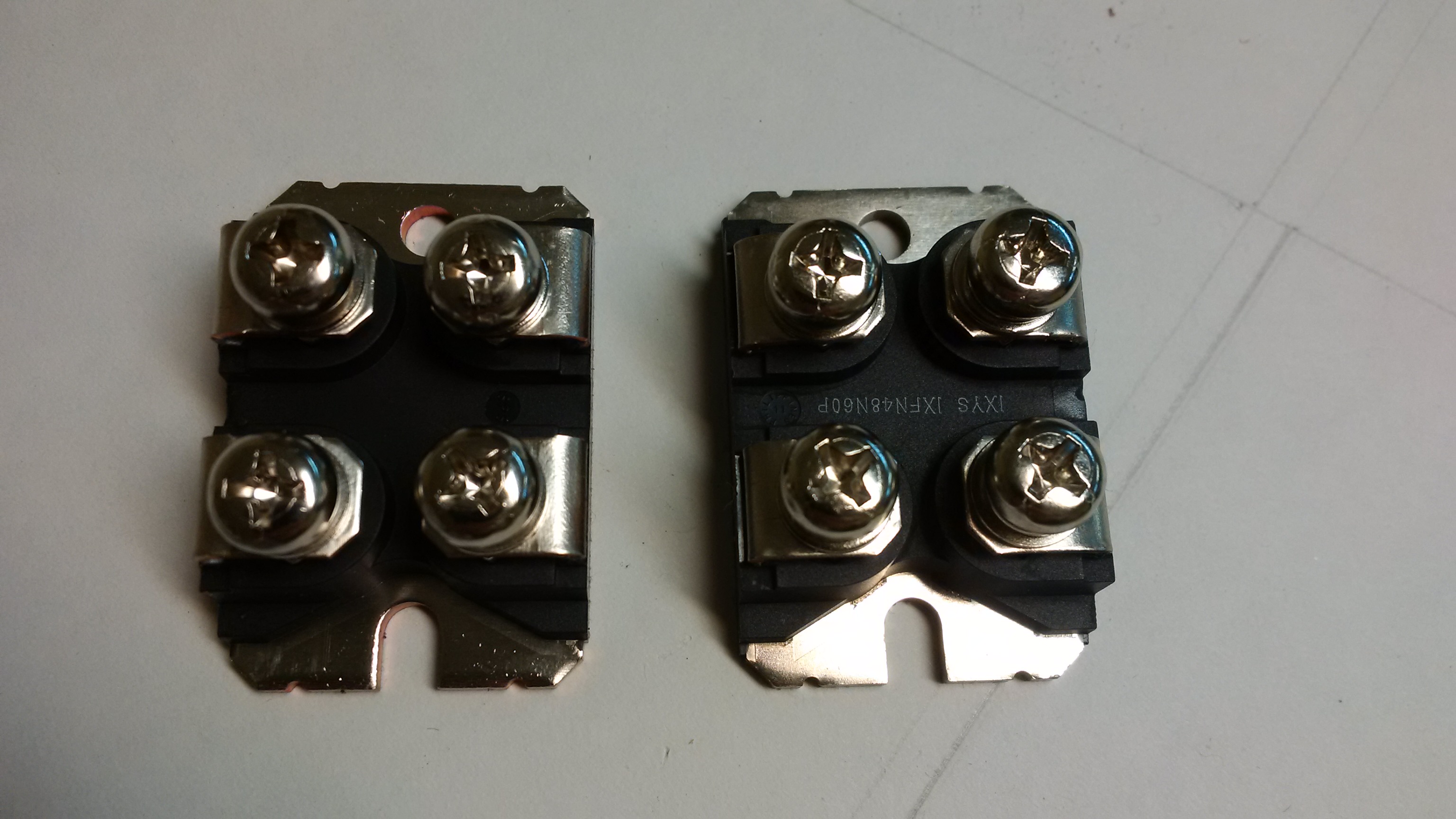

OK I'm joining in the fun the pair arrived today!
Will be testing this weekend keep you posted will use 2Picodumbs circuit.:) View attachment 600747

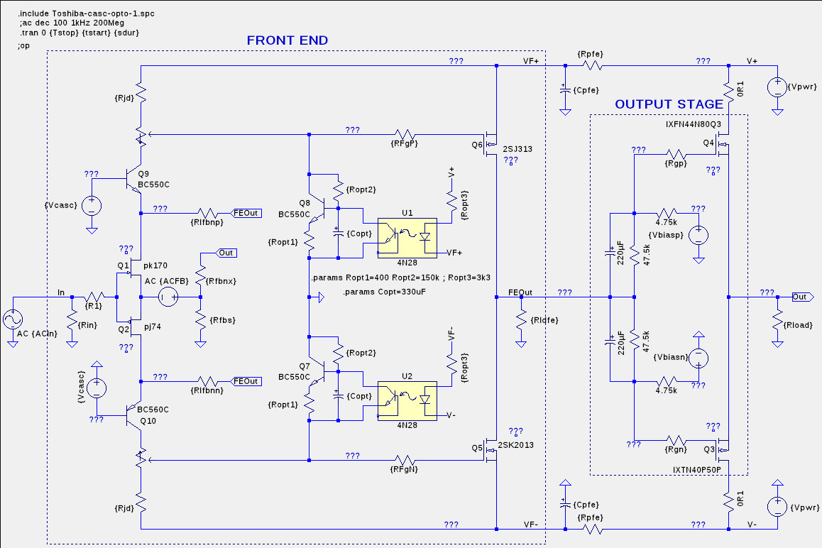

Just to avoid any confusion for the front end circuit R8/R14 and R9/R16 are trimpots. 500 Ohms would be a suitable value.
Depending on the filtering up stream you may also want to leave space for a cap across R3 and R20.

Here is alternate DUAL opto-bias circuit which should have both FE bias stability and FE output offset stability since the opto-bias circuit is referenced to ground rather than floating. It also has the advantage of not introducing resistors to the FE (Toshiba) MOSFET drains. With the bias circuits adjusted for minimal current injection at nominal operating temperature, the bias circuit should have virtually no effect on the gain and distortion of the amplifier. That is also true for the single opto bias circuit.

Lynn checked my idea and sees some flaws concerning behavior with rising temperature.
So the race goes on..... :--))
The problem was not rising temperature in particular, but the lack of sufficient gain from just the photo-transistor internal to the opto and lack of sufficient low-pass filtering. The challenge is to introduce another non-inverting gain stage that has low impedance output. I have tried several circuits involving a common-drain (emitter follower) but the lack of voltage gain limited their performance.
