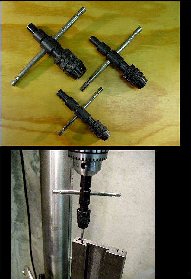

160 bloody holes drilled and tapped
Maybe this could speed up your project.

Probably won't try that method this time around, but I like that guy's thinking with hand tightening the chuck. I might test it on a scrap piece of aluminium, just for fun.
I'll most likely stick to the character building method for this job. Hahaha

This short video shows four hole tapped with a hand drill in 30 seconds so you could tap all your holes in just 20 minutes using this method.

Yeah that is what I already do.
Tapping is actually the easiest part, it's the precision drilling which is the more annoying part. Very little margin for error.
I have tapped lots of #4 and #6 holes and it is very easy to break taps, even when doing it in a drill press with a tap-handle show in the picture below. I am very skeptical about doing tapping small thread sizes under power. OTOH, CNC machines are very good at it.
Yeah I agree Lynn. M3 taps are extremely delicate/susceptible to breaking.
I recently purchased a battery operated portable hand drill (been living in the stone age), and if you set the clutch on the lowest torque setting it is effectively less than finger tight so impossible to break the tap. Saves me a lot of time and haven't broken an m3 tap with it.
Always use a cutting lubricant. Basically anything.
Lynn, the guy in the video said you can't use just any tap it needs to be a spiral tip and machine steel, not carbon steel. normally I would tap by hand but with 160 holes I would see if it worked. The guy said number 4 is as small as he would go, but I would have to agree that that does seem too small to tap a hole this way.
I appreciated the video Rob.
The thought had crossed my mind before but hadn't considered hand tightening the chuck to protect against breakage.
I'll give it a go on a piece of scrap just for fun.
