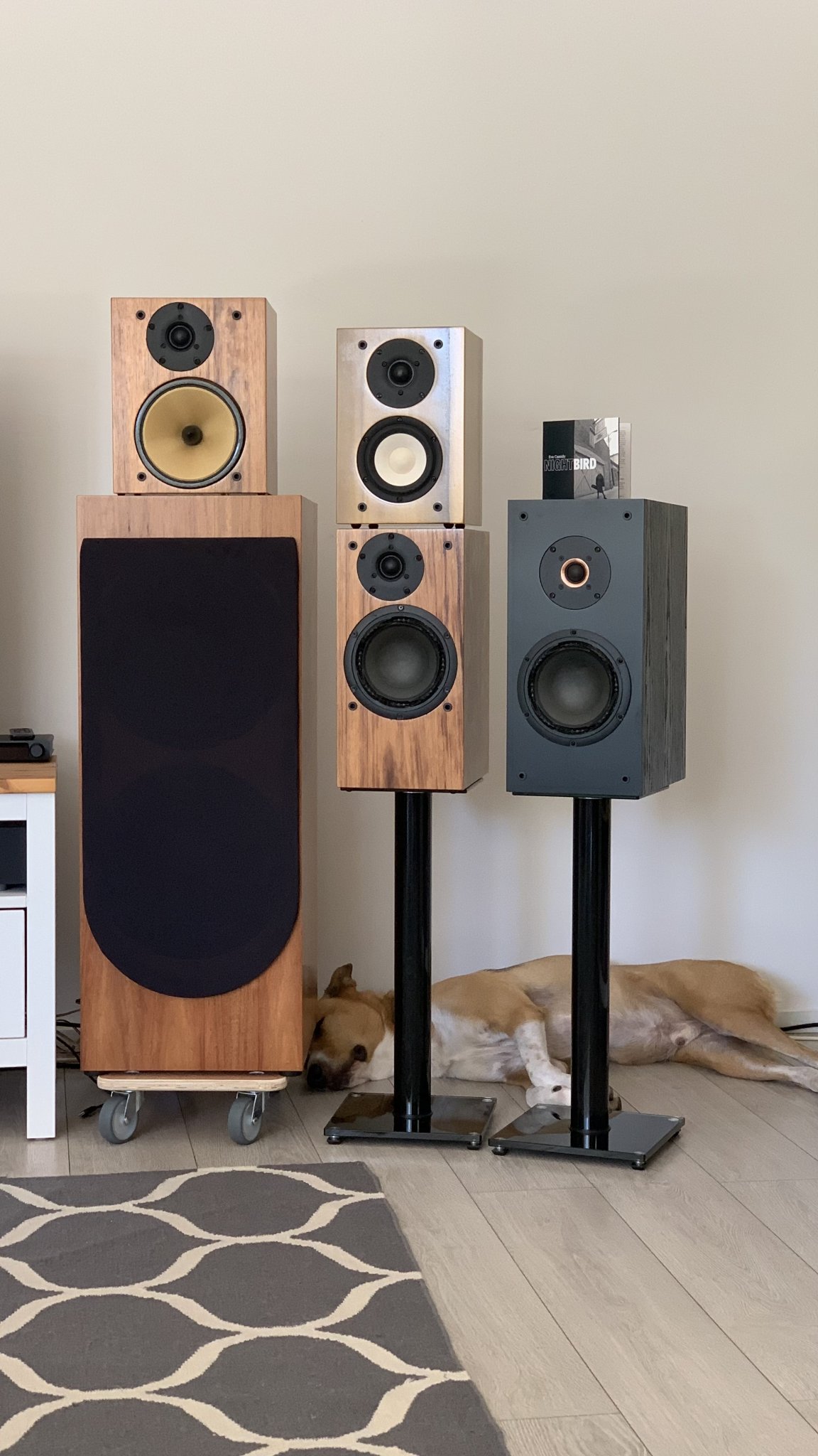

Hi guys, just wanted to add my grain of salt to the discussion about Purifi midwoofer in closed enclosure and show you my prototype in progress.
Actually the PTT6.5X04-NAA-08 is working flawlessly in sealed enclosure of 7 liters, and its frequency response and sound are top notch. Hi to @lrisbo and Purifi! <3

How do you compare Aluminium and composite woofers from Purifi ?
