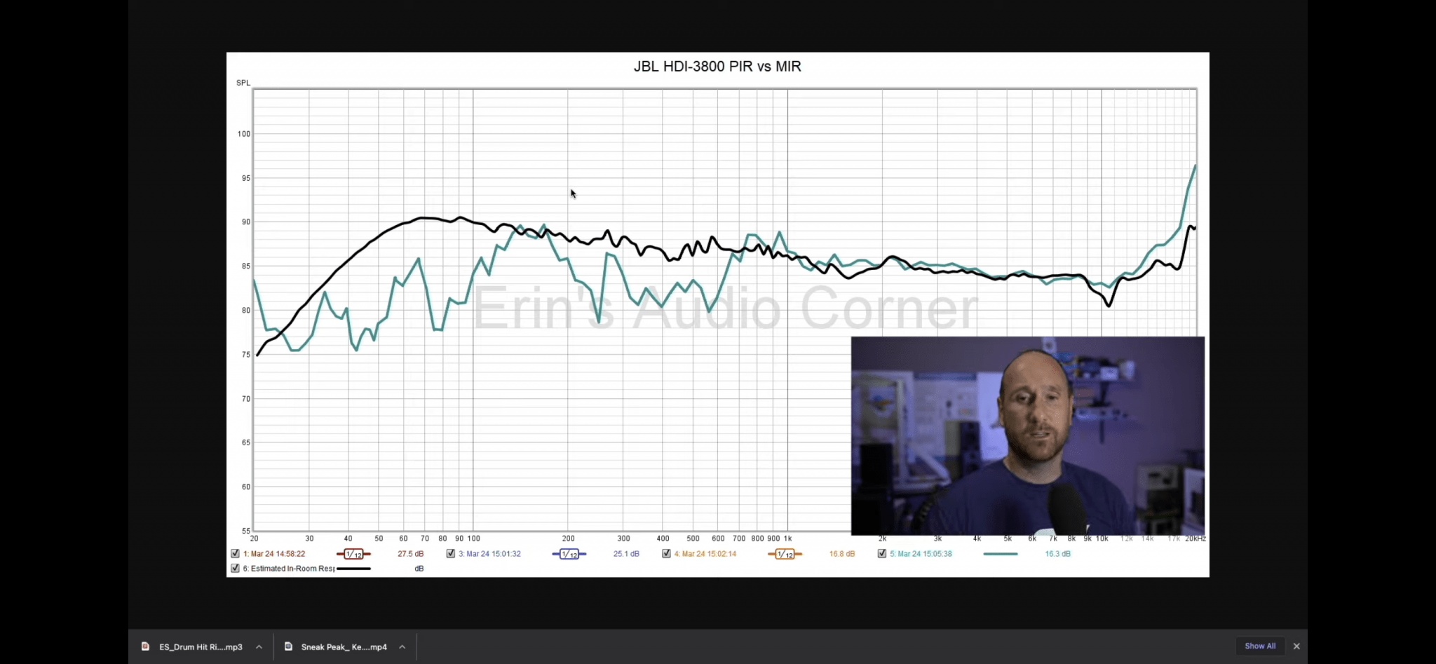

Regardless of the cause ie. "cabin gain" or room modes, as well explained by Rene in the theoretical sealed room; the effect of gain or loss below the Schroeder frequency present a big challenge for the speaker designer.
In many, if not most cases, the actual in-room response of a speaker in an individual room, is different from the power response or predicted in-room response as suggested by the spinorama/CTA2034A.
The actual in-room response of any particular speaker in any particular room needs to be measured, and compensated for, because it is often FAR OFF from the power response or predicted in-room response.
There are commercial products eg. Dirac OR Acourate that automate the measurement of the actual in-room response, and provide corrections to allow a more neutral sound.
For the active/passive speaker designer, however, who has no intimate knowledge or control of the actual room it will be placed in, we must compensate for this with using various methods eg. various amounts of baffle step compensation (for passive speakers), use of boundary compensation switches for active analog, or parametric EQ/DSP.
Below is an example of a speaker's Measured In Room Response VS Predicted In Room response. I'm not singling out this speaker for any particular reason, other that not providing my own measurements and thus suggested of bias.
As one can see, below the Schroeder frequency, the predicted in room response is deviates significantly.
Whether it is caused by boundaries, carpets, open doors, hallways, or room modes in a closed sealed room, or "cabin gain", the practical effect is what matters.
This speaker will not sound neutral in this particular room. And will need in-situ compensation.

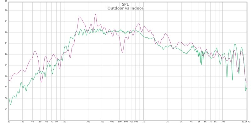

My current room is pretty far from a sealed cabin being open on two sides, but yet there is still a reasonable amount of measurable low frequency gain when compared to an outdoor measurement. Below 100Hz there is a gradual rise that peaks or dips along with the modes and boundaries.

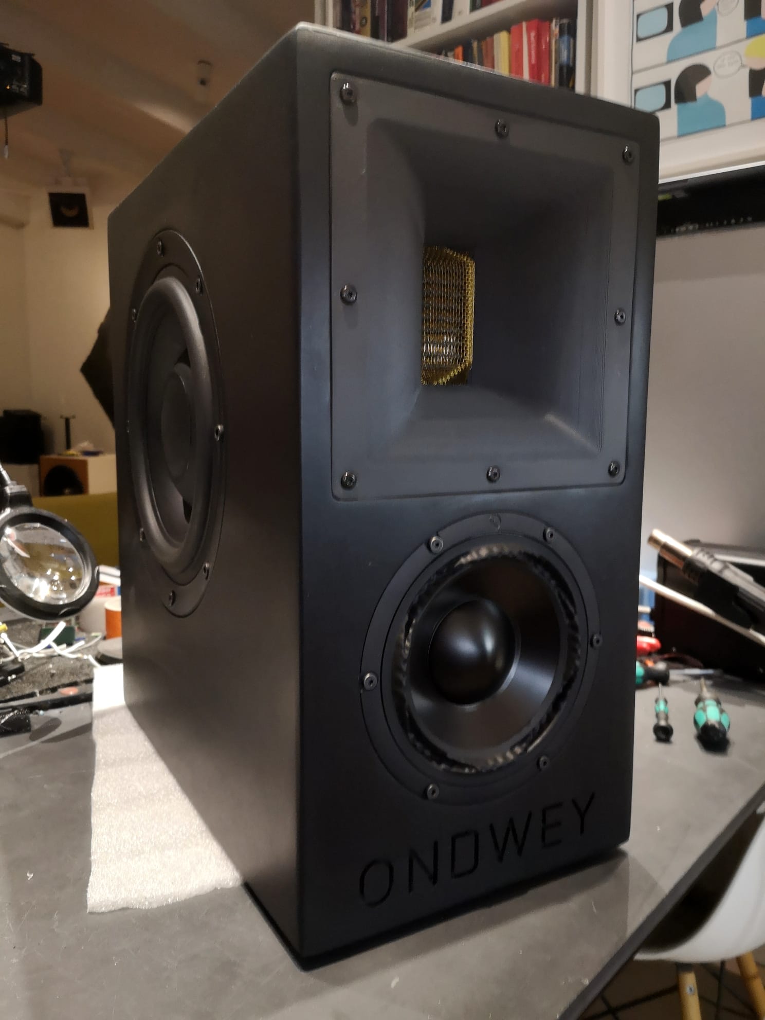

Hi guys, just wanted to add my grain of salt to the discussion about Purifi midwoofer in closed enclosure and show you my prototype in progress.
Actually the PTT6.5X04-NAA-08 is working flawlessly in sealed enclosure of 7 liters, and its frequency response and sound are top notch. Hi to @lrisbo and Purifi! <3
