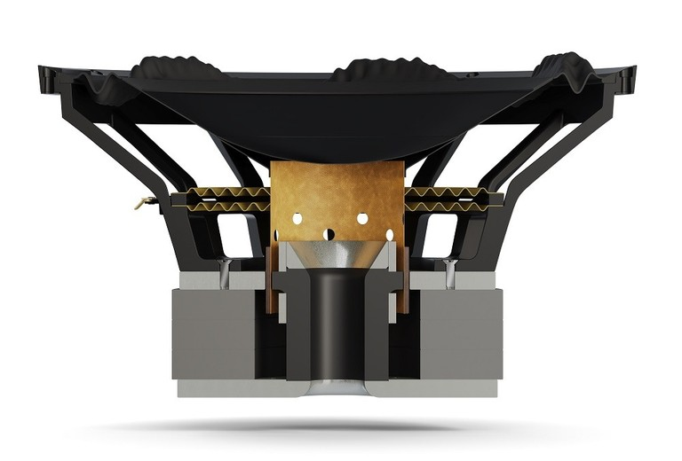

1) Use a basic, off the shelf, aluminum cone for its rigidity and absence of a cone edge surround resonance.
1b) No need for the under cone edge treatment ring.
2) Use a traditional motor design, obviously FEA optimized, but with a standard pole, no neodymium slug.
3) Do not use copper in the motor, unless a thin copper cap/sleeve is cost effective. Just use aluminum ring(s) instead to reduce price for some inductance Le (x) control.
4) Commonly wound voice coil but with a Bl(x) curve out to 14.75mm standard in Klippel
5) Their neutral surround, the star of the show
6) Big spider with odd number of corrugations/pleats to enable Kms(x) to match their geometric voice coil x-max of 14.75mm x-max

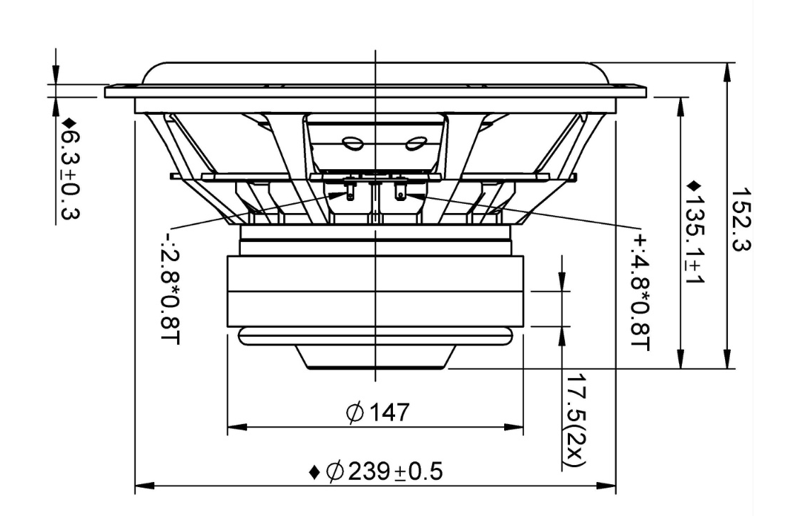

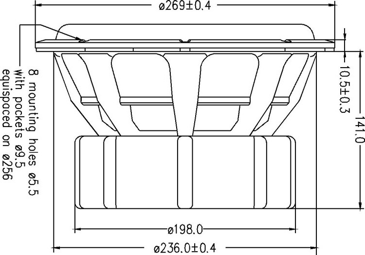

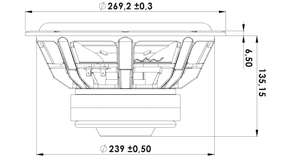

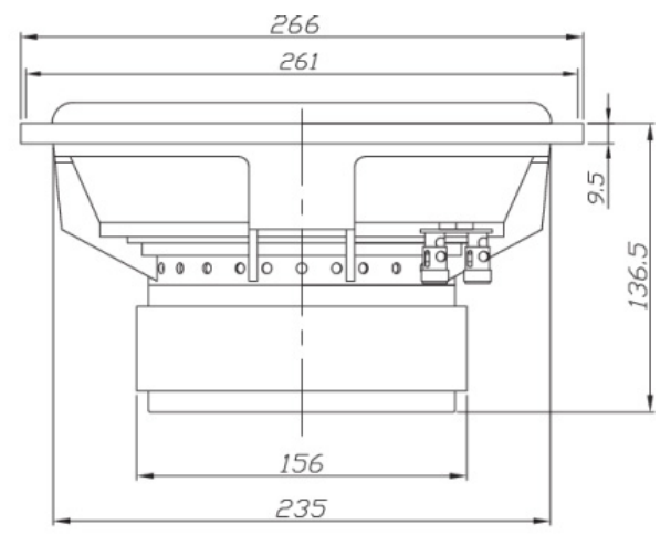

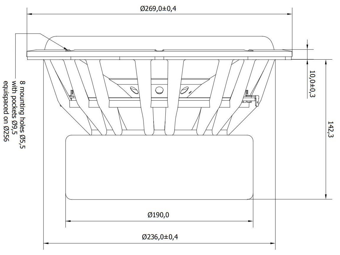

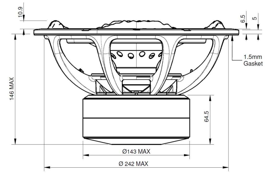

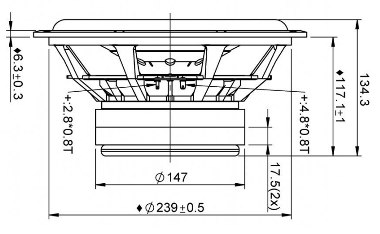

Because more investment would be needed to retooling the frame for a bigger landing for the spider to get the full 14.75mm x-max:
In order of date of appearance:
Peerless (DK) 10” XLS 830452 5ohm pulp composite cone, aluminium rings for demodulation circa ~ 2001 ?earlier
Dayton Audio (Parts Express house brand) RSS265HF; aluminium cone, aluminium rings, Made in Taiwan ~ 2005:
SEAS L26RO(4)Y
10 inch 4 ohm (4 layer VC) 2 layer voice aluminium cone, copper sleeve - 2011 (A collaboration between the late Sigfried Linkwitz for his Orion 3.3, originally Made in Taiwan under the SEAS Design brand.
Klippel data and application note
10” Tymphany XXLS 835016
Alu cone. Aluminium shorting rings
Made In China
~ 2012
L26ROY manufacturing moved to Moss, Norway, with redesigned basket- ~2018
PTT10.0X ~2024
All are 10” woofers with a frame whode outer diameter is 269mm (except for RSS265-266mm)
But only one has a spider landing of significantly less than 143mm; whilst all others have a frame landing of significantly over 160mm (or well over, in the case of the SEAS)
Could this be the reason for the PTT10.0X not reaching the 14.75mm geometric x-max?
Displacement limiting numbers calculated by the Klippel analyzer using the full-range woofer criteria for Bl was XBl @ 82% (Bl dropping to 82% of its maximum value) 11.9mm for the prescribed 10% distortion level. For the compliance, XC @ 75% Cms minimum was 10.2mm, which means that for the Purifi woofer, the compliance is the more limiting factor for getting to the 10% distortion level.

hi, we deliberately want the suspension to limit the excursion so that the coil stays in the linear range. This keep IMD down. the distortion from the Kms is more isolated to harmonic distortion of the deep bass and not so much IMD. of course, with a dsp limiter you can control excursion better and benefit from a more linear suspension. Note also that it’s the surround that limits excursion. the spider goes further. The 8” and 10” spiders are geometry optimised by us. We dont trust the Klippel LSI graphs and use our own analyser for the data sheet.

It's a superior solution imo, but it's also significantly more effort. To accurately predict displacement you NEED a nonlinear model, without such model you end up being very conservative or you won't have safety guarantees.
As a driver manufacturer you don't know how the customer is going to implement the driver. If you look at the average high end manufacturer, they still use passive crossovers (don't get me wrong, they can be fine). However if those people are your customers, I completely understand the philosophy of using Kms(x,T) as safety mechanism.
Changing the shape of the suspension system won't increase the Xmech, but only the distortion character. As Lars already mentioned, the Kms(x) distortion stays within low frequency and thus is quite tolerable from an audibility perspective.
