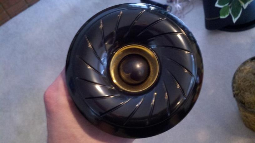

That's a dome with a WG inside a torus, right?
This looks like a standard coax driver with a centrally mounted VC for the MF, no outer surround.

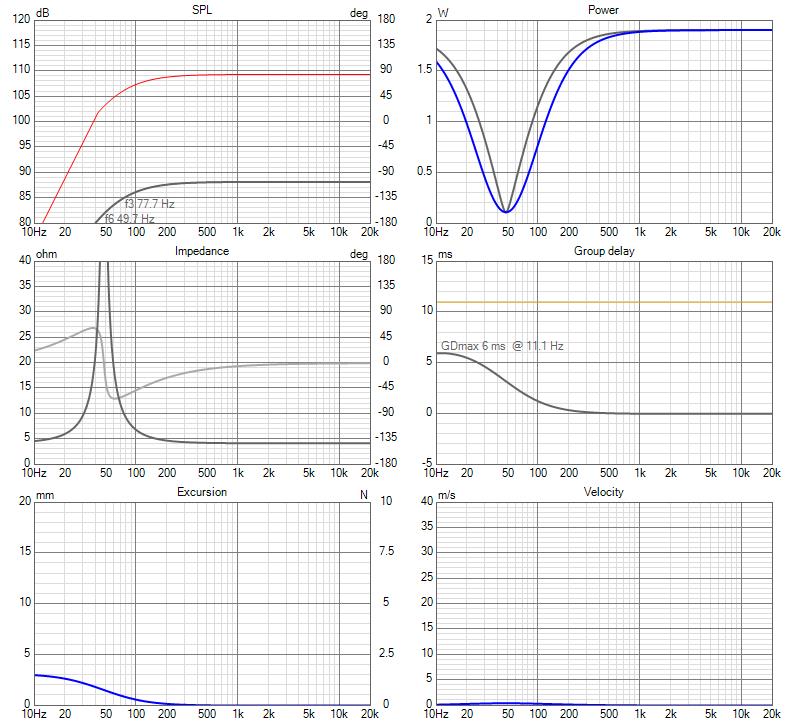

How would the PTT6.5X04-NAA-08 perform in a 17 liters (0.6ft³) sealed enclosure? I don't have time for simulations or even building new enclosures at the moment, but I'm really itching to buy some Purifis and temporarily install them in some old boxes.

I also lack time so here is a sim simply opening CAD and setting box to closed with 17 liters. Looks like you get F3 at 78Hz F6 at 50 Hz Qtc 0.48. My guess is with room gain (and if available a bit of bass EQ +2dB below 50 Hz) this would be quite enjoyable for "really itching to buy some Purifis and temporarily install them in some old boxes."
IRIS is the picture your words brought to my mind. I’ve also played with those - they’re fun little drivers!
You could also use examples from, e.g. Cabasse or Thiel that have suspended rigid ring radiators with concentric tweeters. That’s my point - unless the “midrange dome” has a hole in it I don’t see it. Though I guess what you’re saying is put a tweeter on the “coherer” (phase plug) of the midrange?

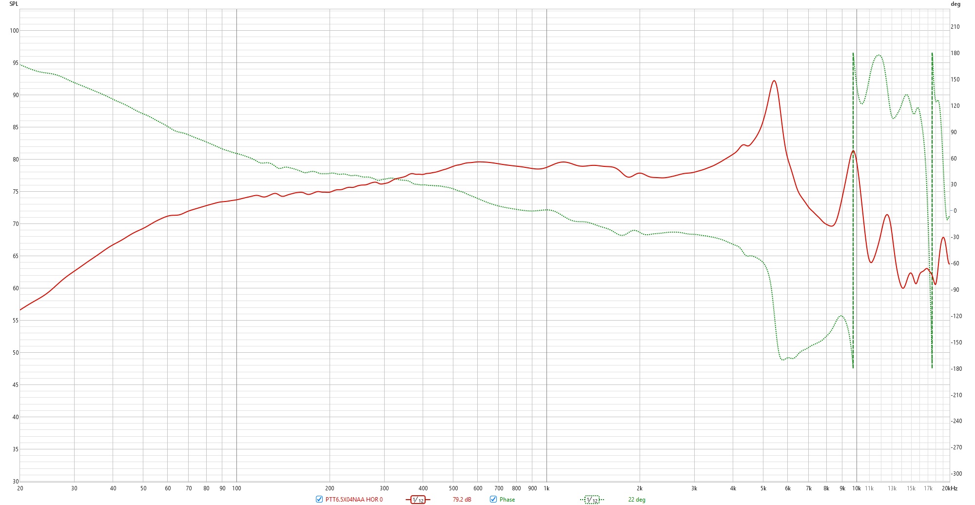

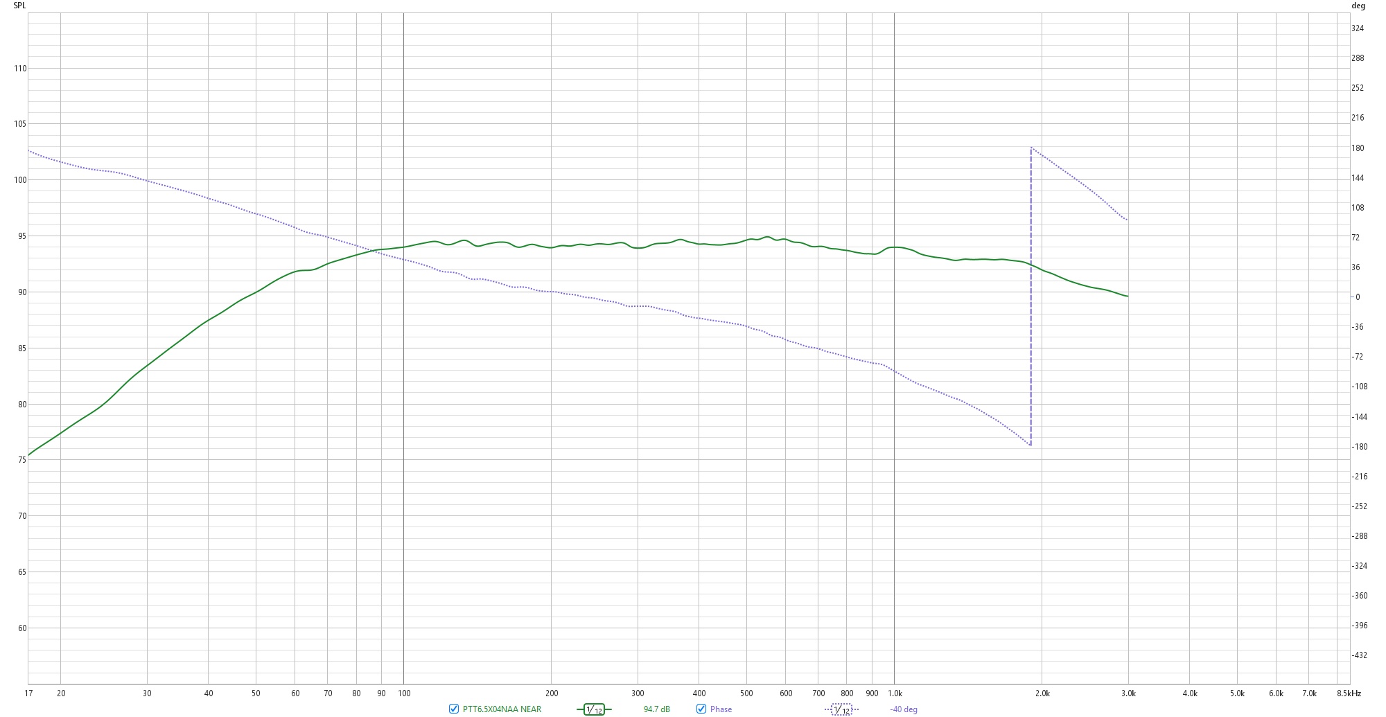

Here's 12L sealed near field, then far field 1m merged to nearfield with baffle step correction, 1/12 smth

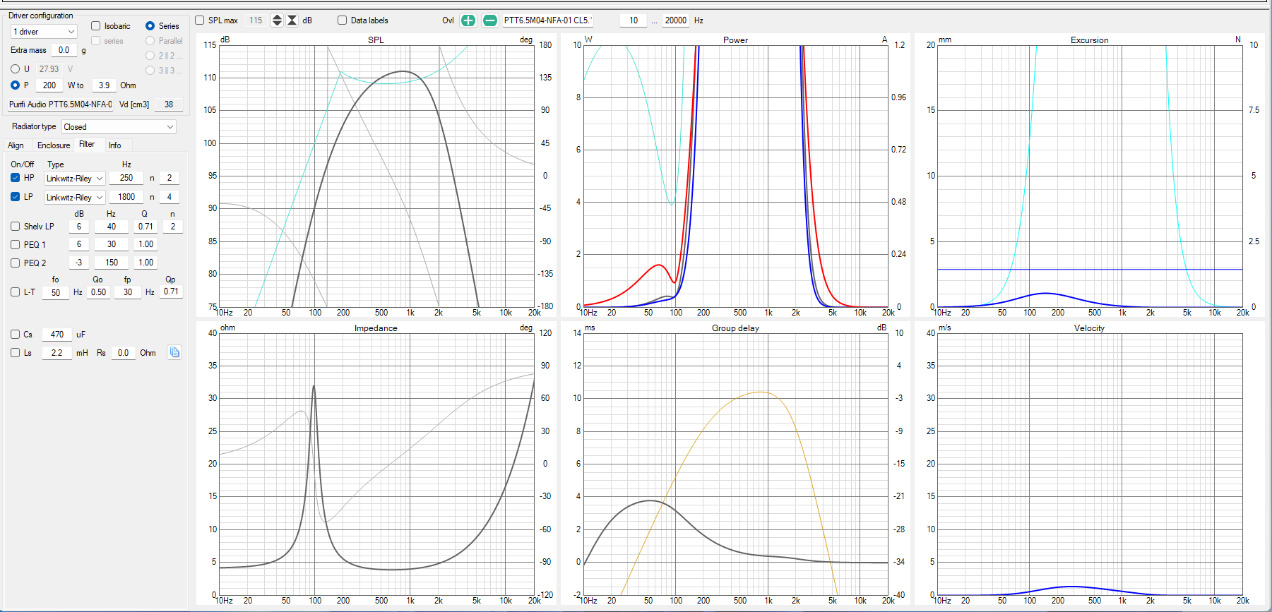

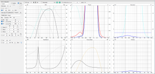

Thanks! Although my problem is I'm not experienced enough yet to know how to interpret this stuff. <1mm excursion. No idea if that's good or bad, given the THD rises fairly rapidly below 100hz with this driver.
The thd at low frequencies is largely dependent on excursion. So if you have thd measurements they should also say how they were measured and from that you can guestimate what happens if excursion is of say 1mm .
Assume measurement at 2,83 Vrms and full bandwidth withbdriver in closed box or infinite baffle, you can sim that. It gives you an indication of the excursion in that test.
As it is a midrange it has a short voicecoil, thus limited excursion.
Sort of combining these gives an good indication.
Reactions: maFrodite
Right, got it. It's from here. 16v, 80hz 2nd order, no mention of filter type. Regardless both BW and LR filters put the excursion just above and just below the 3mm maximum, respectively. Ok I'm going to call this one solved. Thanks again for your help!
