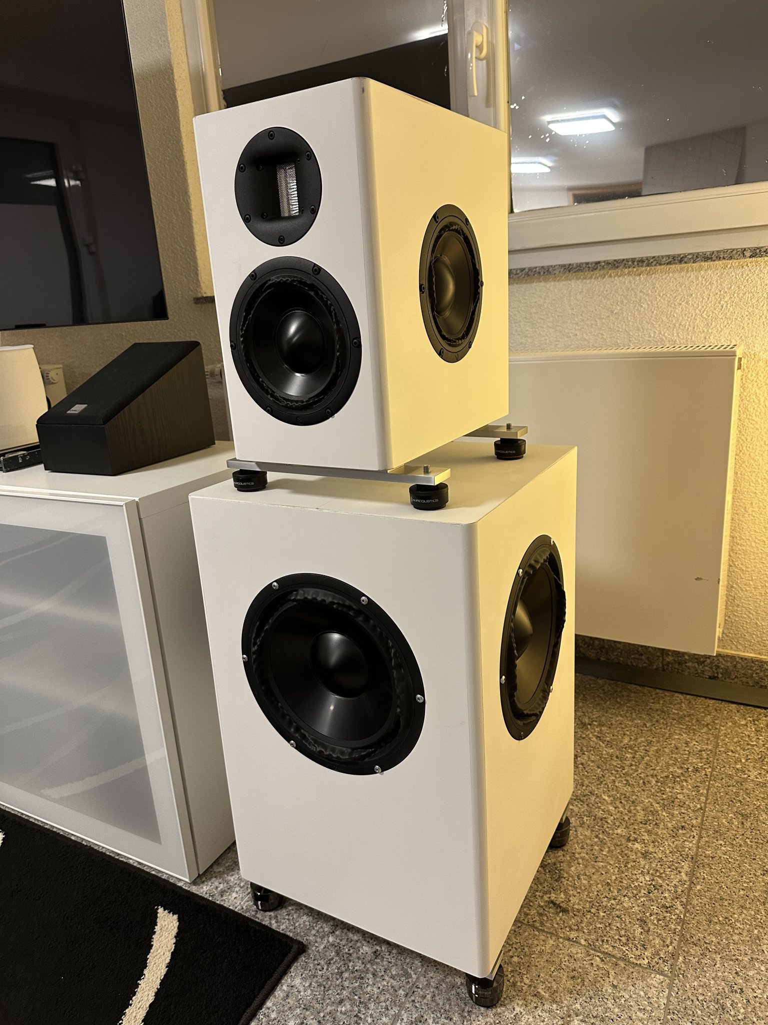

The holidays finally brought my new Purifi build home. I must confess, I contracted the professional expertise of MG from Rose-Handwerk. I could not have built such solid boxes. So this is custom build and not really DIY.
The upper boxes with 6.5-inch aluminium 4-ohm mids and Viawave GRT-145-8 tweeters are very pure (as measured and experienced). The 10-inch sub boxes have no lining or stuffing at present. So would appreciate any feedback folks might have from the charts below.
The sub drivers are PTT10.0X04-NAB-01 with PTT10.0PR-NA2-01 passives carrying 200g each side. The sub boxes are 40x40x60cm. Though take off 28mm for the MDF.

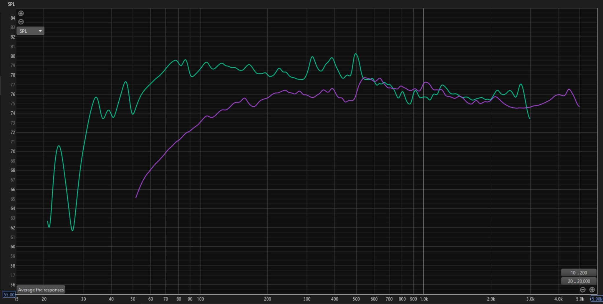

Here are REW SPL measurements for the sub and mids from three inches away. I am not too fussed about the absolute dB levels. The REW SPL meter hit 75dB with periodic pink noise running before I ran the measuremenrts. Here is left:
And right:

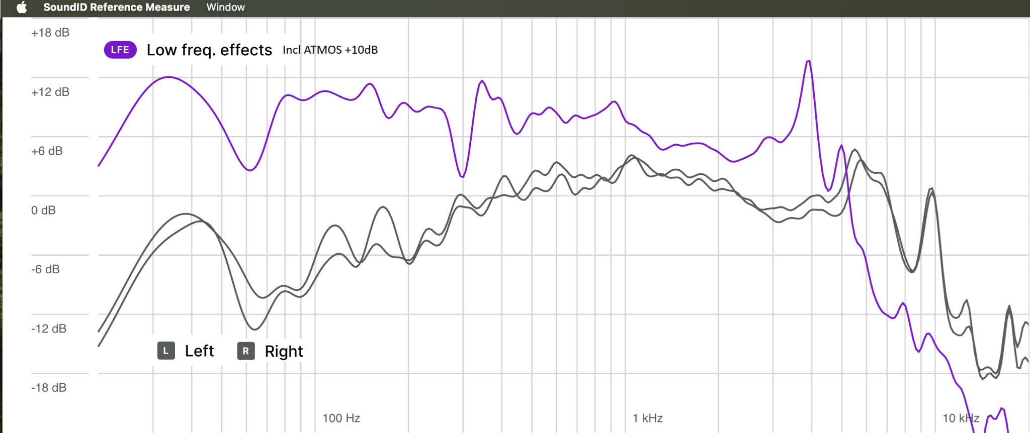

Here is what SoundID Sonarworks saw for ATMOS purposes with the same LFE signal going through both sides at the same time. Got the same dipping of the subs around 50Hz.

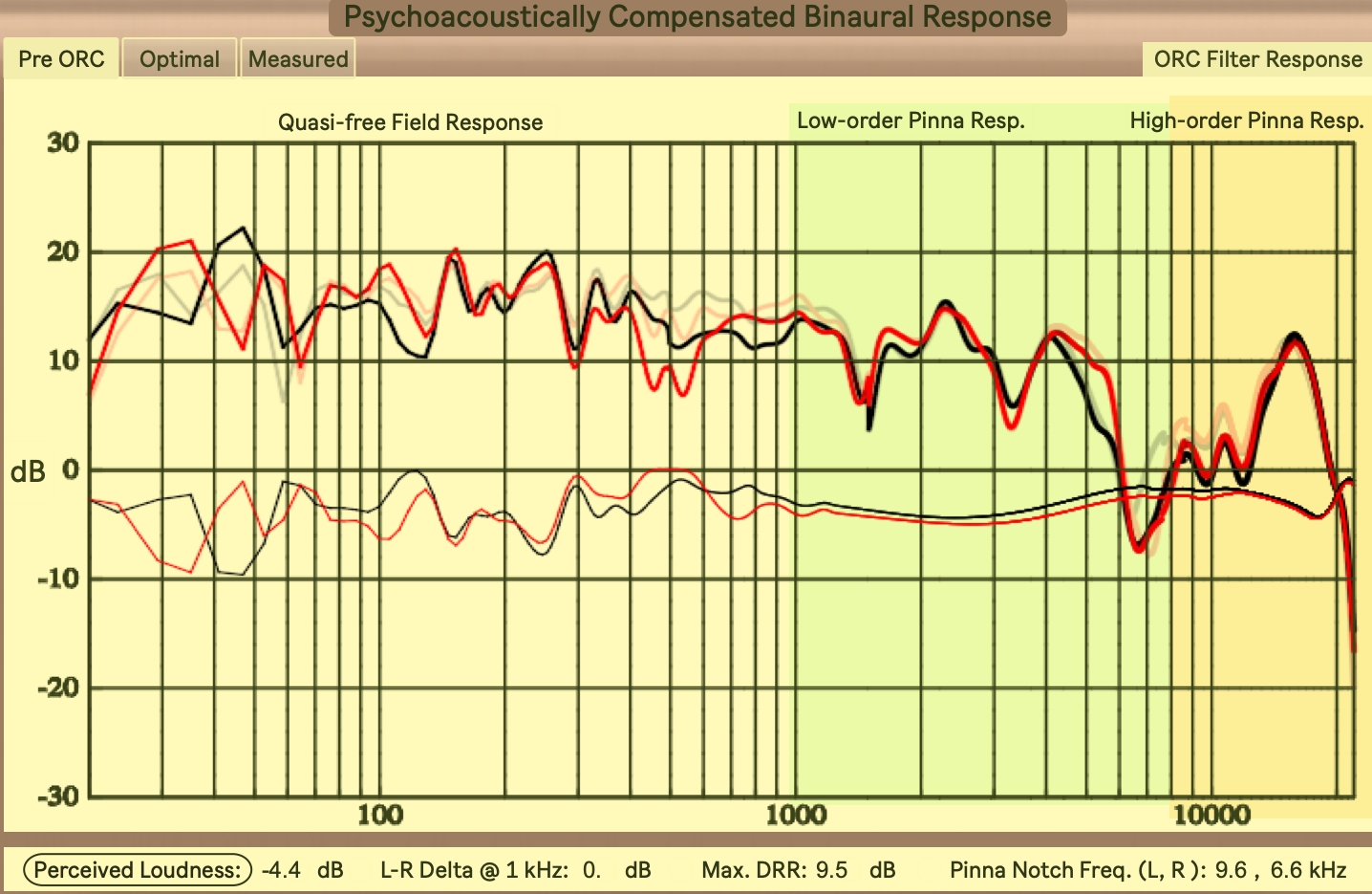

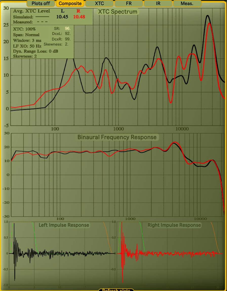

I am running an active crossover (fourth order at 200Hz and at 3000Hz) and crosstalk cancellation (XTC) and room correction (ORC) from Theoretica BACCH4Mac. The XTC figures over 10 are considered quite good.
Here is before ORC room correction in bold vs. after in shadow:

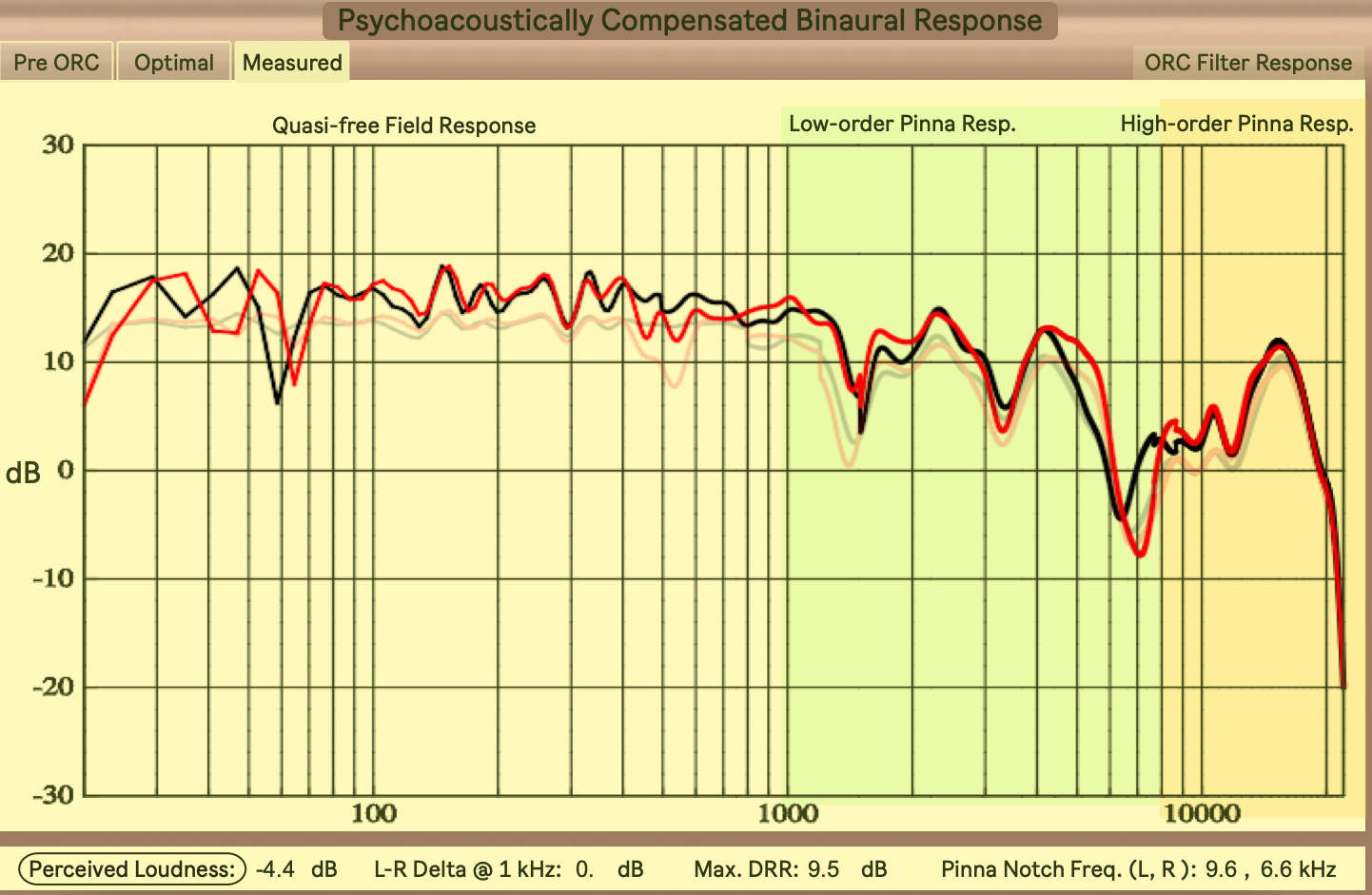

Here is after ORC room correction in bold vs. “optimal” in shadow:

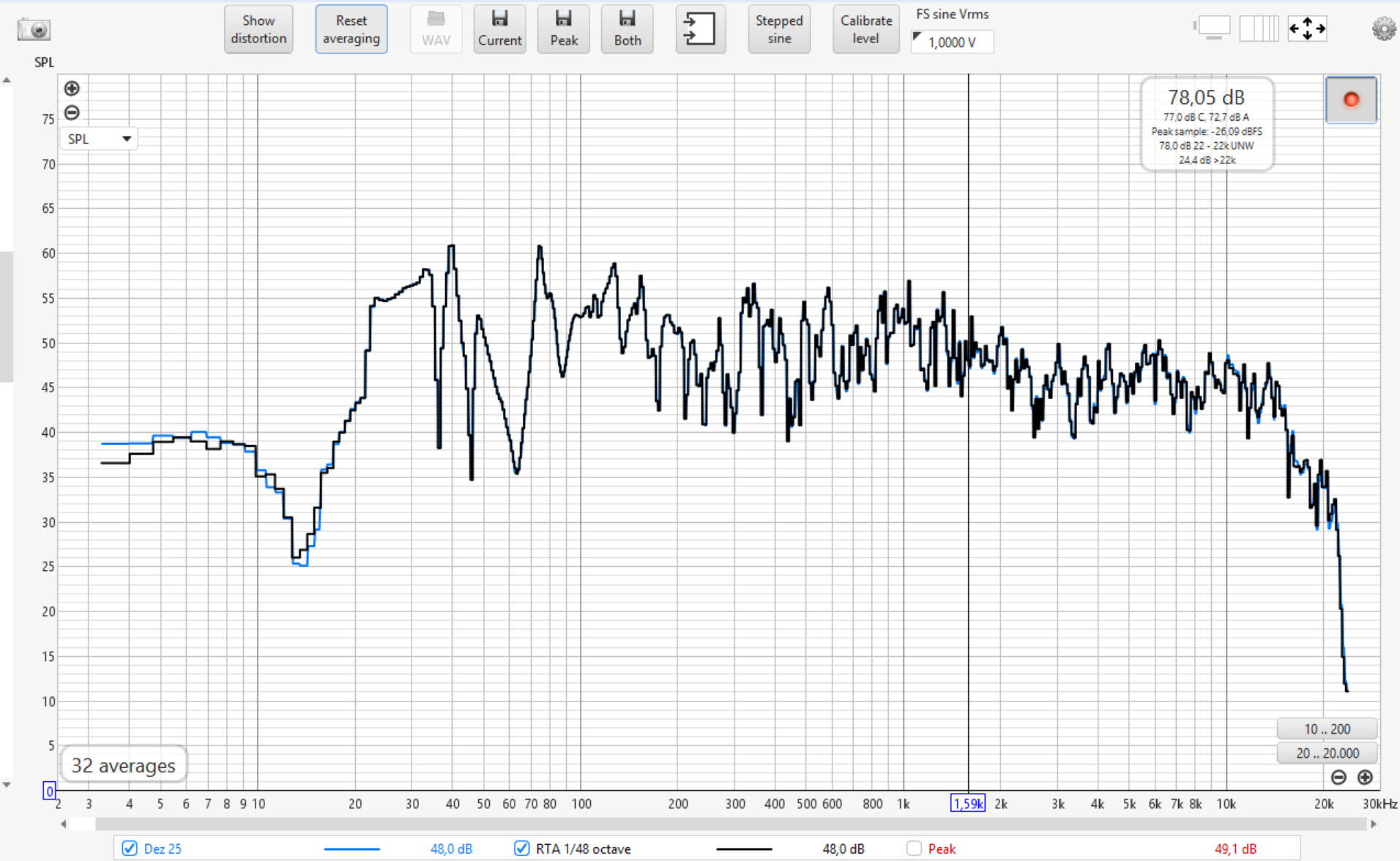

And here is the REW RTA view after BACCH XTC and ORC using pink noise (again not too fussed about absolute dB level indicated... it was loud enough in the room!)

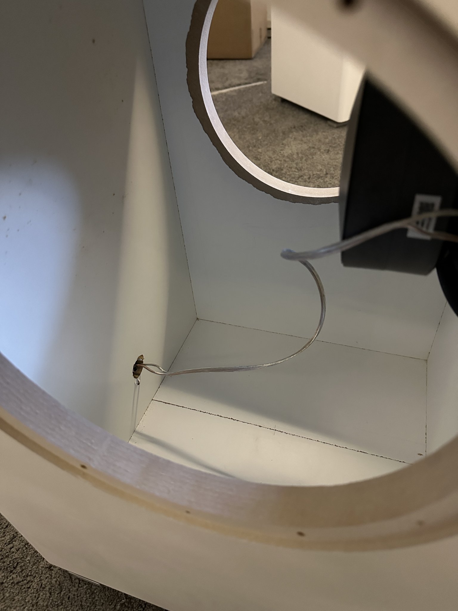

Still wondering if I should stuff any materials or linings in the subs, e.g., blackhole for the back wall. They are pretty bare inside:
Throw some acoustic felt/foam in there.
Thanks, will do! The results above were the encouragement I needed to learn the CAD tools a bit better. By playing with the Qa fill / lining factor in VituixCAD (from 120 = no fill up to 5 = heavy fill) I can see the projected improvement around 50Hz. Latest when I disassemble the speakers in Spring to take them outside for final coat painting, if not sooner, I will rectify this.
Very nice...🙂
If they are not finished, add also some bracing inside....big box with heavy cone drivers needs that desparately...
You could/should couple passive cones with MDF bars for forces cancelling and add bracing to the biggest surfaces to break them in smaller ones. It will vibrate significantly less and you will hear that. Drivers of that level deserve dead box....

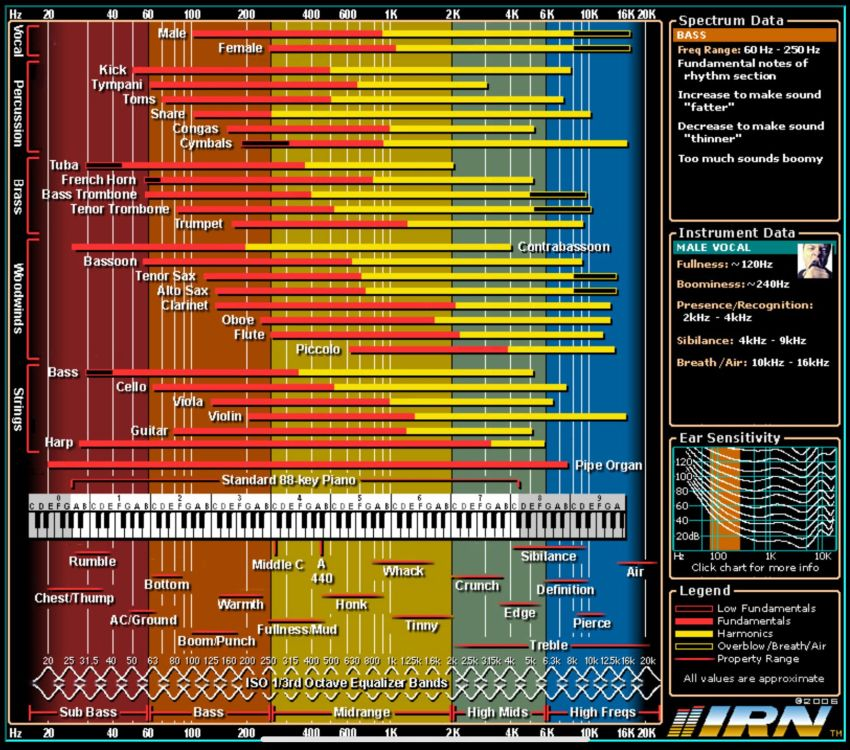

The Percussion range is very wide as you point out, with even lower frequency instruments having some high frequency components as well.
In my case the Alcons pro ribbons provide the above 1100Hz range with up to 130db range delivering sound dynamics in spades. The issue is the lower frequencies 80-800Hz especially male vocals in that range.
Helpful chart - though female vocalists can go higher than shown for example: G6 1568 Hz, C7, D7, and even higher ranges, which would be well over 2000Hz and sometimes closer to 3000Hz. Mariah Carey can frequently reach notes above C7 (around 2093 Hz), sometimes even going into the E7 (around 2637 Hz) and F7 range.
