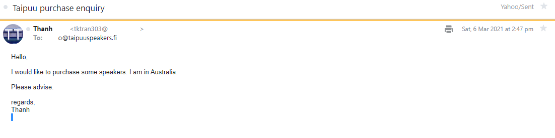

I sent an email to Taipuu in March 2021 asking to buy one. But received no response. Maybe us fellows down under don't get much attention...

It's probably something else. Getting response to e-mail can be hard also for a small company as a customer. For example, about a year ago we were interested in IcePower OEM amplifiers for own system amplifier. I wrote proper e-mail including name, company's information; name, address, vat number, what we're manufacturing, estimated order quantities and so on. No answer. Possibly hasty conclusion was that we're too small and insignificant manufacturer to get their attention. Next try may happen soon. Chances are even worse if e-mail looks like a spam from a robot; without actual name and address, but nothing is guaranteed with full contact information.But received no response. Maybe us fellows down under don't get much attention...

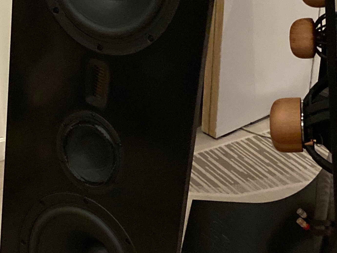

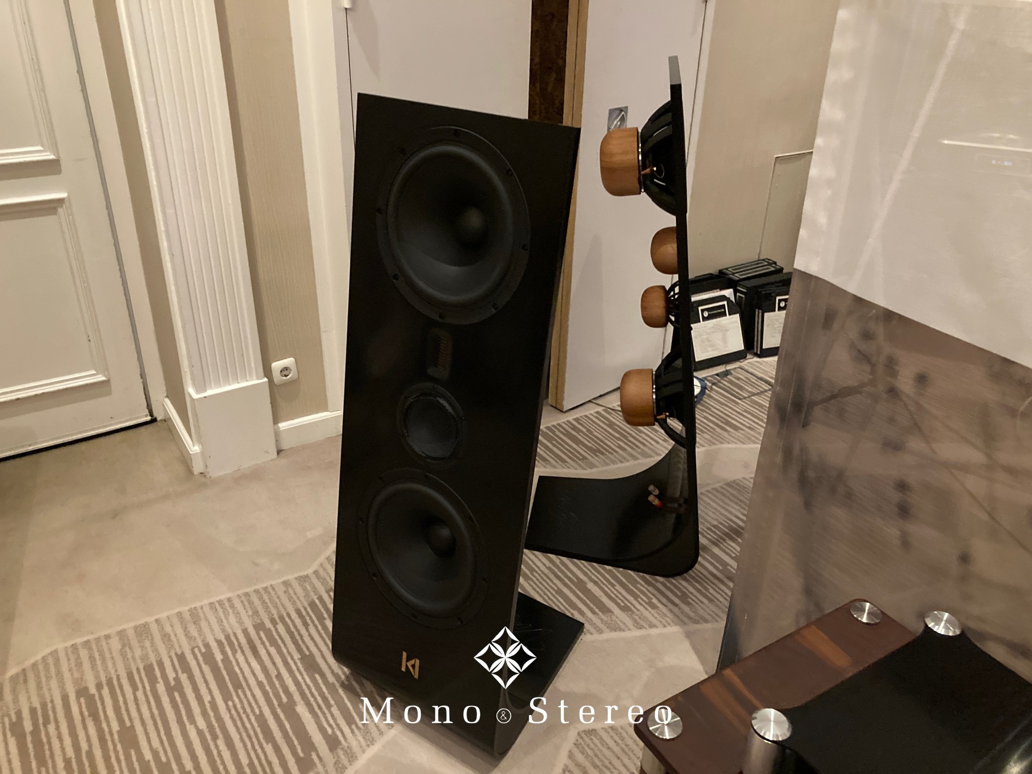

Continuing posting some Purifi design wins that emerged at High End 2022 Munich show here is the Violetta open baffle design by Kroma Atelier.
https://kromaatelier.com/violeta/
Cropping in on this photo originally posted to monoandstereo.com event coverage clearly shows a PTT6.5’s unique surround.
Interesting turned wood magnet covers. We will all have opinions of how such effect the sound, looks nice given the back of the drivers are left visible. The baffle is a manmade material they call “Krion”.
Throughout this threads presently 79 pages an FAQ asked/proposed about once every six pages is “what about Purifi drivers in open baffle applications?” Apparently Kroma Atelier likes them for open baffle mid-woofers. Not surprised they went with a pair of 12” for the woofers. In open baffle systems the old hot rodding truism applies “there’s no replacement for displacement”, or in this case square CMs of Sd.
saw those in Munich - not hooked up though. They like wood. the port was made of wood in some of the other models

The text of their web site reminds me of one of those social media posting challenges. "Show me how you can say 'full of Purifi driver technology' without saying 'Purifi driver technology'".
Woofer is probably SB34NRX75-16, or at least some kind of SB34NRX....Continuing posting some Purifi design wins that emerged at High End 2022 Munich show here is the Violetta open baffle design by Kroma Atelier.
