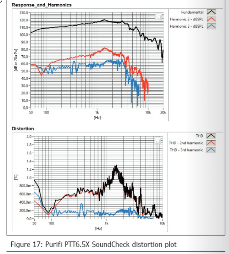

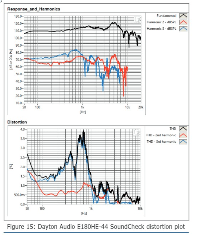

I appreciate this is a slow-witted question, but what's the big advantage of the Purifi drivers over, say, a Satori MW16P if crossed over to a sub at ~75hz? Or building a 3-way with a larger woofer and cheaper drivers?
Is the IMD reduction that substantial? The numbers I see look good, but they don't look astonishingly better than a Dayton E180HE.

On top of the IMD you mention, if you look at the measurements in Voice Coil, the 3rd order distortion of the e180he is almost an order of magnitude higher than the Purifi at the same spl. Whether the additional cost is worth it is up to you, but the difference is clear.
NB, Vance notes in the articles for both drivers that the SPL is 94db, not 110+ like it appears.

I missed the note about 94dB and failed to read the graph properly. Thanks.On top of the IMD you mention, if you look at the measurements in Voice Coil, the 3rd order distortion of the e180he is almost an order of magnitude higher than the Purifi at the same spl. Whether the additional cost is worth it is up to you, but the difference is clear.

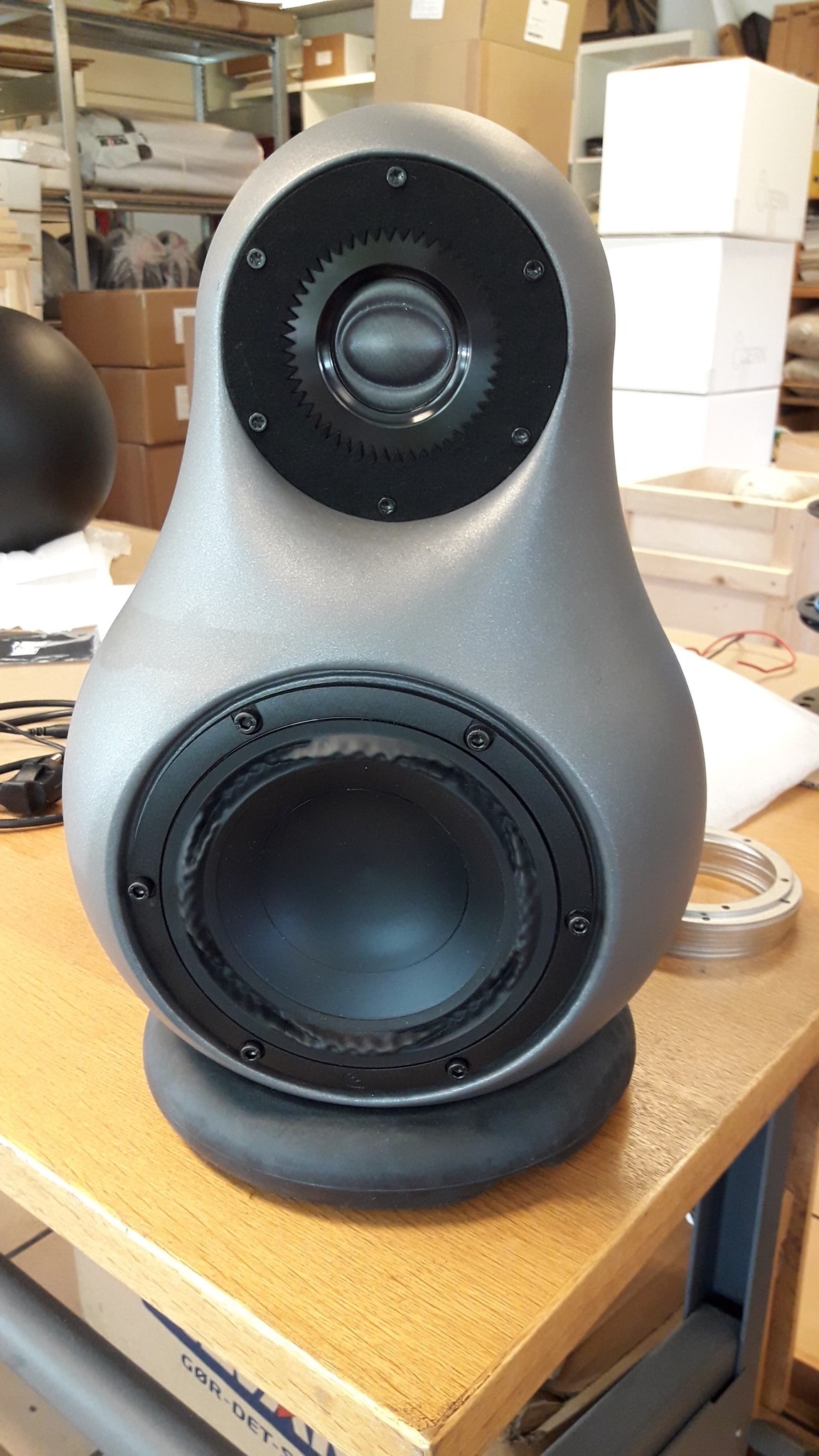

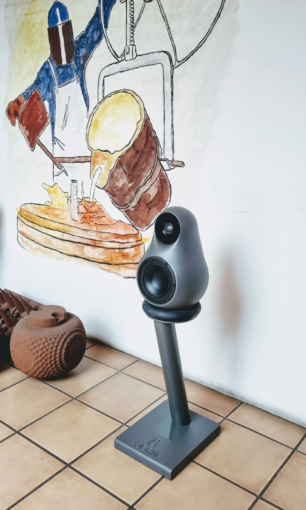

Watching 'net coverage of High End 2022 appear on the web I see fellow Danish company Jern (https://jernspeakers.com/) was showing a new model the Jern 35 using Purifi woofer. Jern specializes in cast iron enclosures an off shoot of the owner's family business a leading High Precision Casting company serving the automotive and other industries. If you are a automotive nut like me one look at the Jern speaker enclosure and you think "turbocharger housing".
I would love to hear Purifi in such an inert sealed enclosure. Note they appear to be using the Scanspeak oval tweeter, I like the look with the long dimension turned horizontal.
