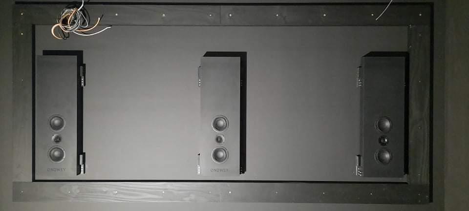

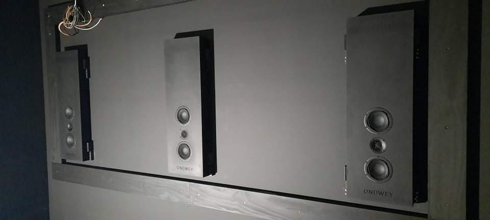

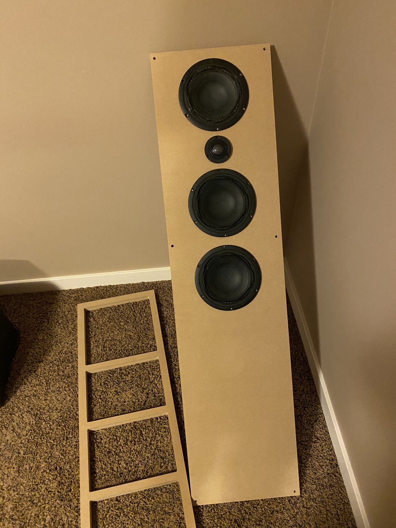

Very nice! I’m doing similar in walls, but 100% active. Baffle from 1 design with Bliesma tweeter. 6l sealed on the midwoofer running 120hz up, and each lower woofer is in it’s own 4l sealed sub-enclosure. 6dB free boost in the low end with in wall. And I can run the bag off the woofers without adding any distortion to the mid. All Purifi amplification driving each driver direct.Hi Dude,

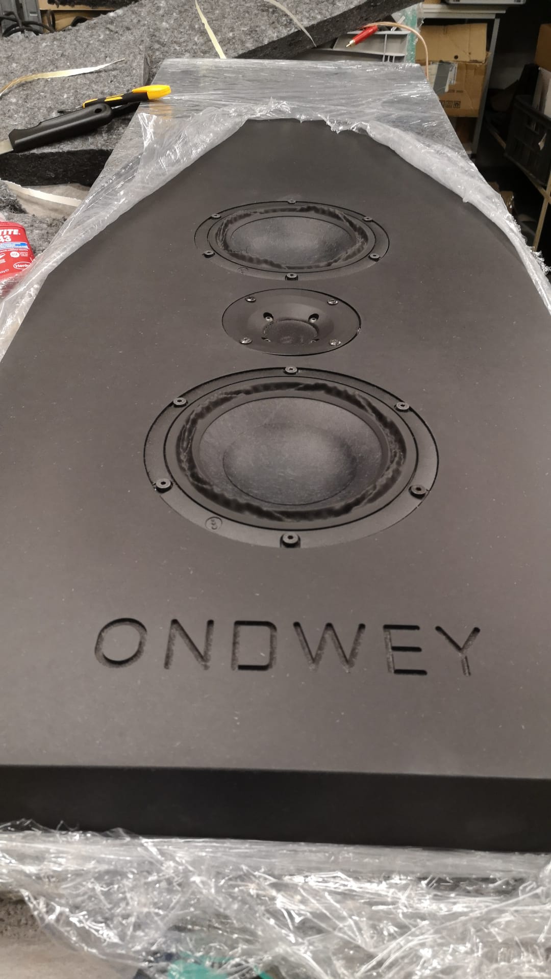

exactly, i have built a lot of vented (with passive radiators) and sealed prototypes using Purifi PTT 4 inch and 6.5 inch midwoofers, and i must say that they sure can take beating without a sweat, and i have not found slightest disadvantage with using them sealed, on the contrary. Of course they are demanding powerful amplification, but that is not a problem nowadays. FYI here is my build of flat Dolby Atmos mains in custom home cinema room, where i am using two PTT6.5X08-NFA-01 in 24 liters sealed enlosures behind acoustically transparent screens. Pics were taken before absorbers around them were installed. View attachment 1004946 View attachment 1004947 View attachment 1004948

I have my eye on the Bliesma tweeters, planing to test them soon. My setup is actually also fully active, but i have built custom amps with Hypex MP modules and Hypex DSP modules. Have a look:

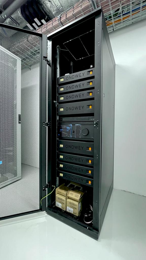

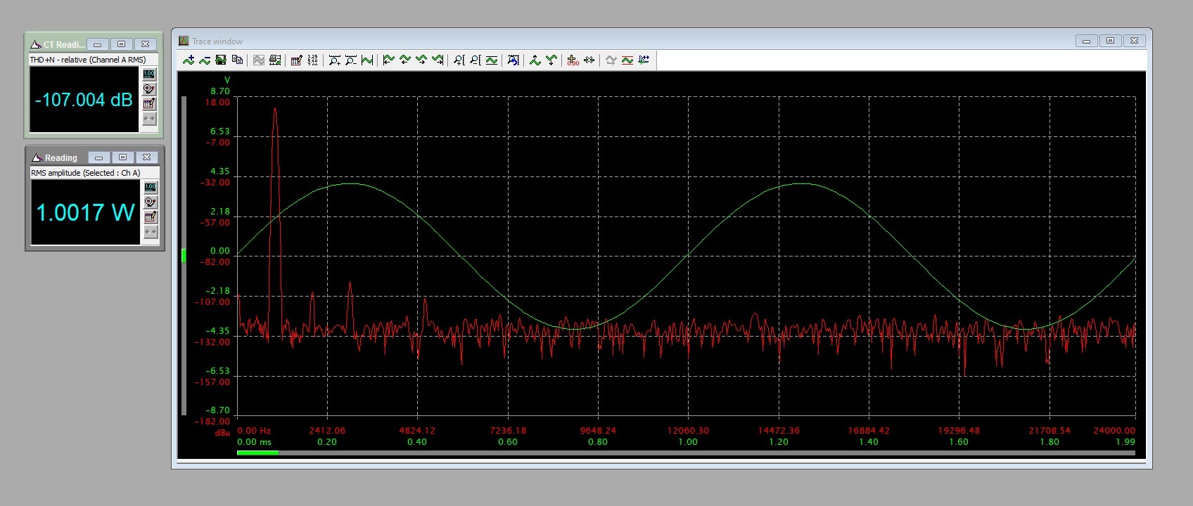

Awesome. We do similar things. I make DSP amp units with Ravenna AES67 inputs and Purifi amps. They build into the walls under the speakers. And I use fibre optic Ethernet from the new Ravenna options in the Trinnov or Storm Audio processors to the speakers. Rather than speaker wires. Here’s the full system 1w/1khz THD+N into 4R load. With a test tone sent from Roon. From there direct to the drivers over a couple ft of speaker cables. Can clock sync up to 128 amps on a 1g Ethernet network.Also very nice!

But this driver is designed for this. You can’t achieve the performance that this driver was designed to achieve in a volume bigger than 4L. Based on my modelling anyways. You end up bottoming out long before the voice coil starts to warm up.Course you do the QTC changes F3 changes whenever you change the sealed cabinet volume. You can compensate for it with EQ and drive it with more volts
And drive up the distortion.
Whether it’s appreciable or acceptable or not is a trade-off you decide on as a designer
Wow, that looks very good! perhaps we are doing the same thing! Could you also share some pics of the install? Are you using the same midwoofers as me? I had some info that they will work best in sealed enclosure of 12 liters, have you also tried or simulated bigger volumes? If 4 liters is enough, that is a great news. What is the F3 of the PTT6.5 in 4 liters? We can join forces sometimes! I am also looking for DSP alternatives with ethernet signal distribution and ethernet online controls.. Can i ask which DSP modules you are using? The Hypex DSP is cheap, and their amps are great value for money, but the HFD software is terrible to work with, and it stays terrible for all the 10 years that i am working with Hypex, no real progress or innovation in all those years. So far i have bought also some DSP samples with ethernet from Four Audio, those were the most expensive, but did not have time to test them. Also i am testing now some Powersoft DSP Lite modules with their power amp modules, and those are very promising, the Harmonia software is like from the future compared to Hypex Filter Design..Awesome. We do similar things. I make DSP amp units with Ravenna AES67 inputs and Purifi amps. They build into the walls under the speakers. And I use fibre optic Ethernet from the new Ravenna options in the Trinnov or Storm Audio processors to the speakers. Rather than speaker wires. Here’s the full system 1w/1khz THD+N into 4R load. With a test tone sent from Roon. From there direct to the drivers over a couple ft of speaker cables. Can clock sync up to 128 amps on a 1g Ethernet network.

My DSP/DAC system is an in house design. Can’t find this for sale. Several years in the works. I have no install pictures. I’ve just perfected the electronics, and just messing around with speakers.
According to simulations with the 6.5’s the F3 is 30hz with an SPL of 95dB per driver, or 100dB with an F3 of 40hz, to reach 12mm excursion. In a 4L sealed volume with the proper DSP boost. Then you can add the extra 6dB of free boost you get building in wall.
Ok, the inhouse DSP-DAC system sounds interesting! I was obviously asking about F3 without boost..My DSP/DAC system is an in house design. Can’t find this for sale. Several years in the works. I have no install pictures. I’ve just perfected the electronics, and just messing around with speakers.

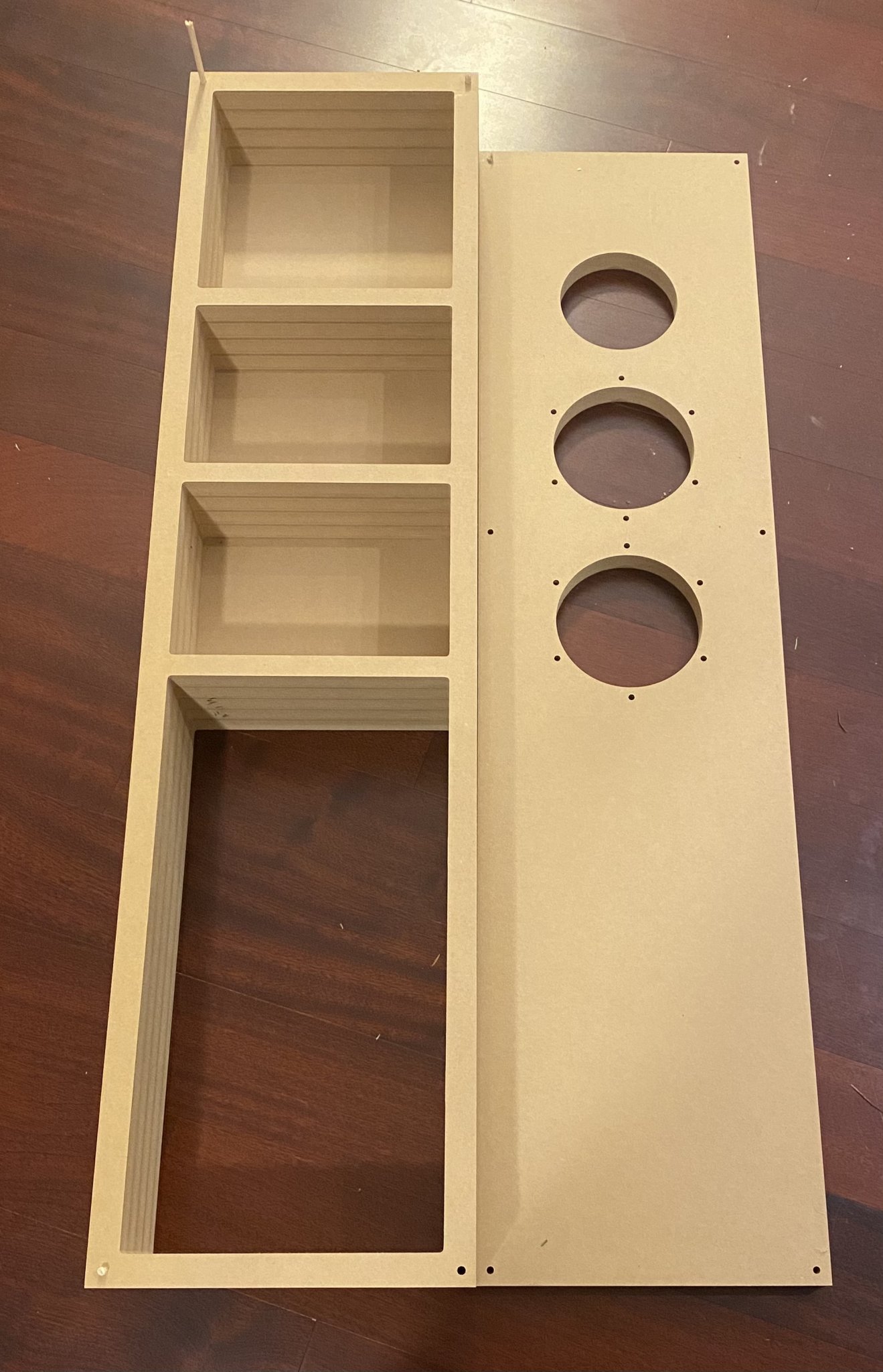

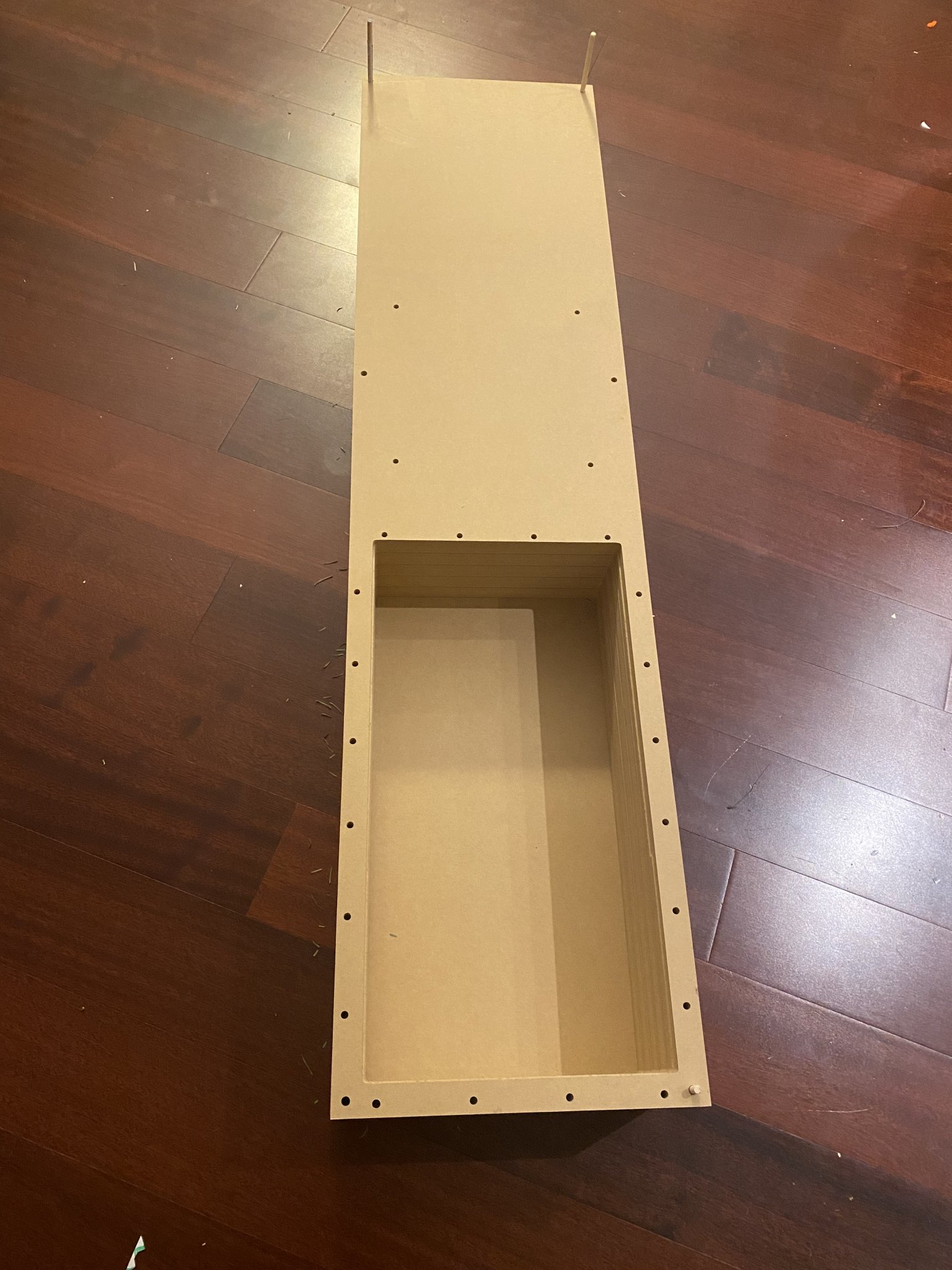

View from the front. The 1” stacked layers of MDF glue together with this viscoelastic damping adhesive:
