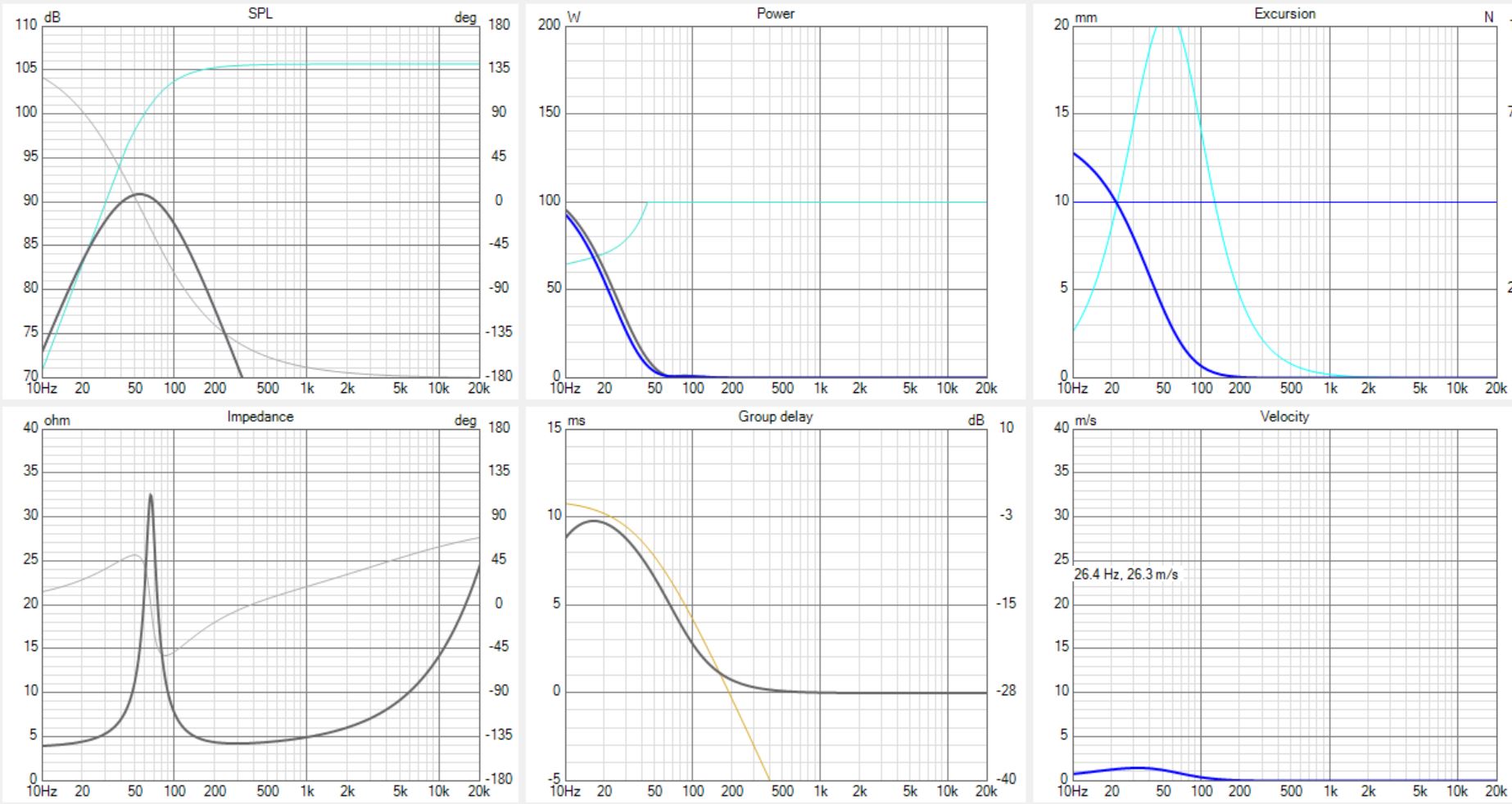

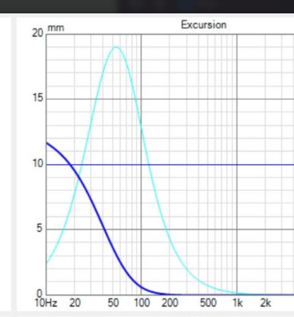

Ok now I see what you're saying. Even after I redid the 7L. I wasn't looking at the 30hz excursion. I was looking at 10hz. Which isn't realistic because not much music has frequencies that low. So yes at 30hz the excursion is lower with the bigger box sizes. So I suppose these drivers are capable of much more SPL yet with actual music before bottoming out.There is a difference in excursion between the 4L and 7L simulations that would favour the 4L in output terms.
If you look closely the 7L does not get to 12mm and at 30Hz the difference between the two is about 1mm extra excursion in the 4L box. 7L is 7mm as shown below, 4L is at 8mm.

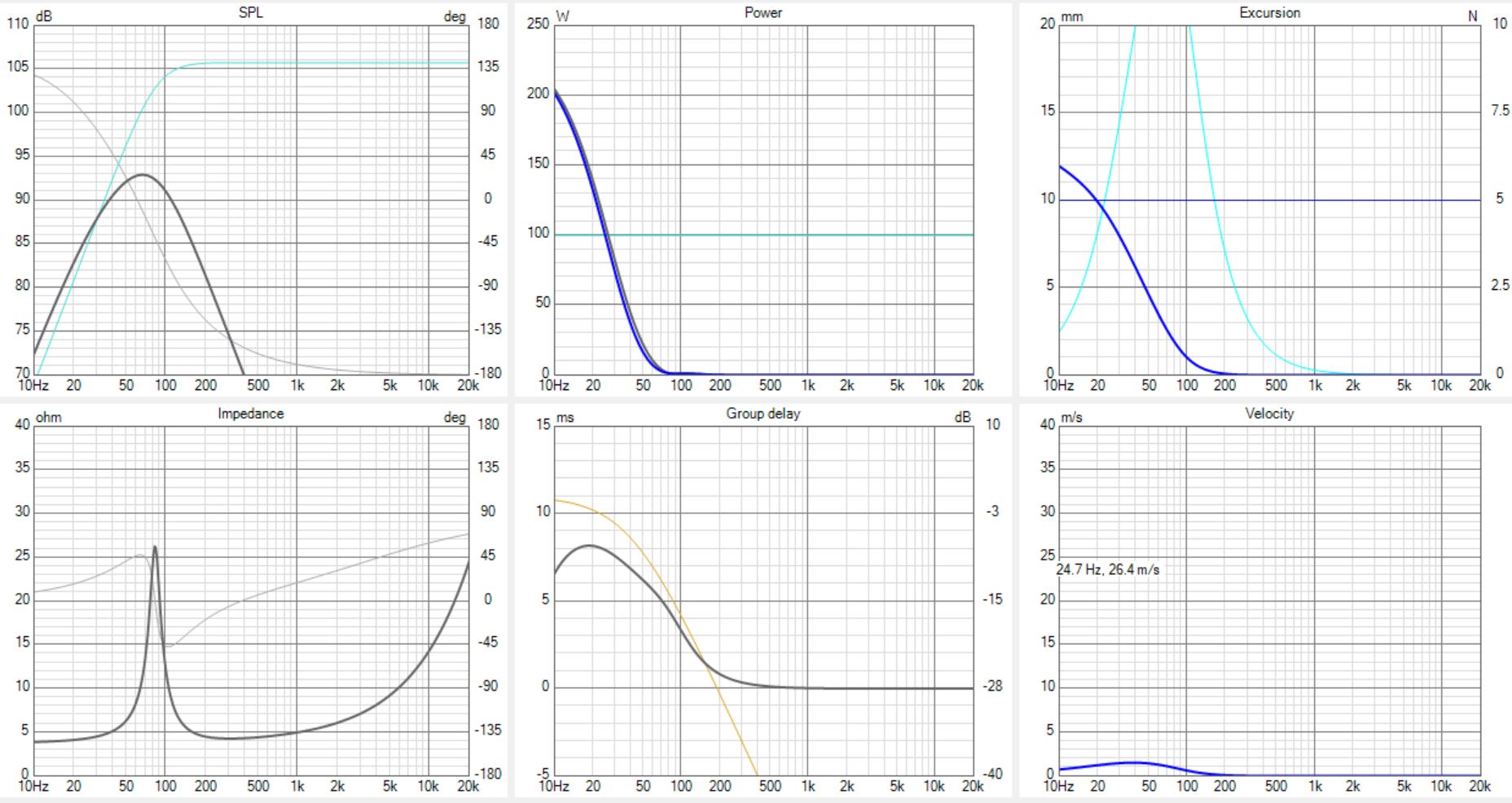

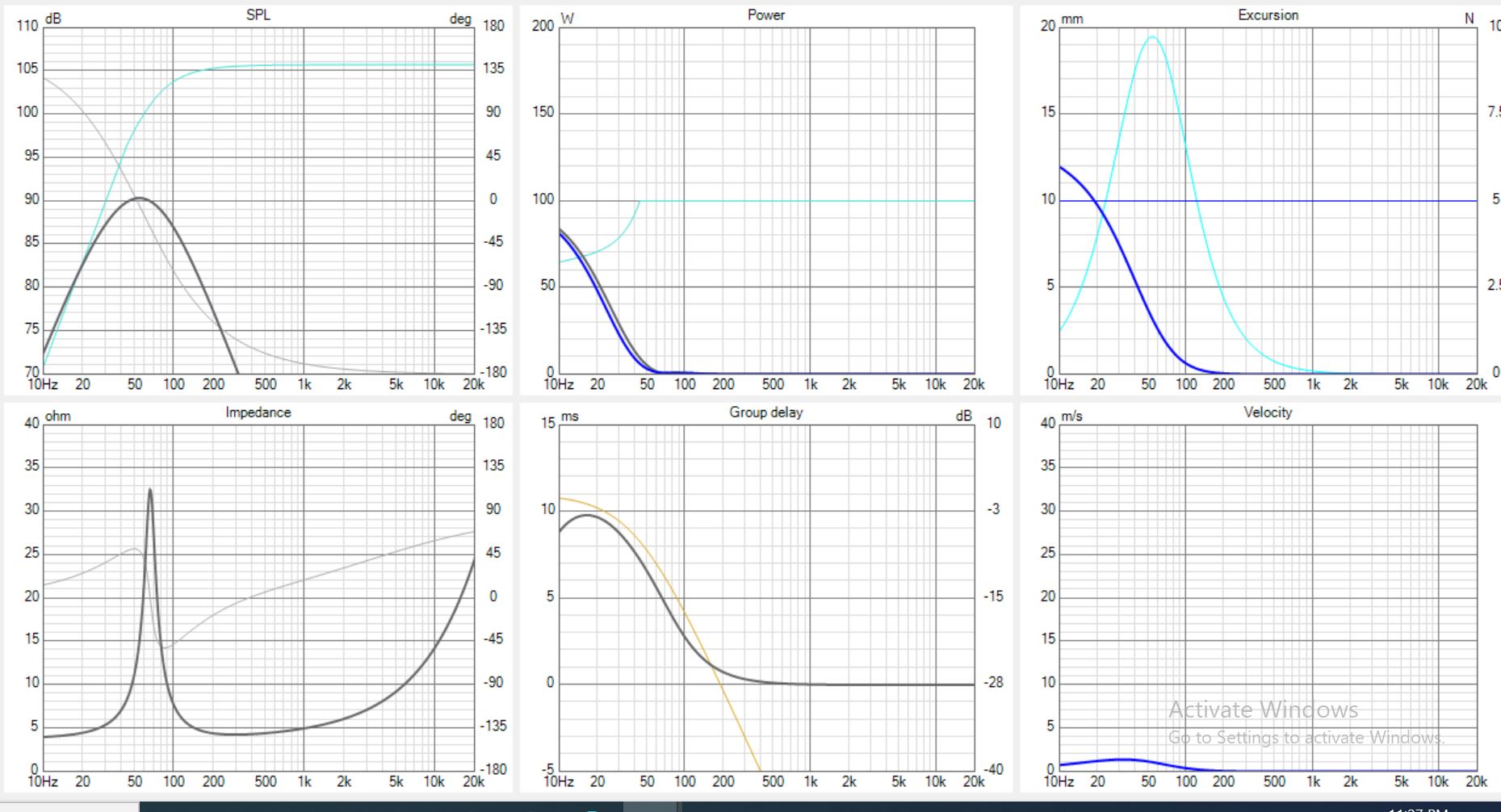

Ok so I redid the 7 and 12L simulations so all have 8mm excursion @ 30hz. And the SPL differences got smaller.
4L
7L
12L
4L
7L
12L
Odd that the difference at 30Hz was more like 1mm. The low frequency output of a driver in a sealed box is solely governed by Vd which is a property of the driver and not the box. You can trade box size and amplifier power but the max output is the same in both cases.That’s about 11.8mm and the 4l is 12mm. Would have made about a 0.2dB difference in spl if I added the tiny bit more power to hit 12mm.

In the sims above the group delay responses are different and so is the rolloff shape from the Q change, if those were equalized the level differences should go away too.
