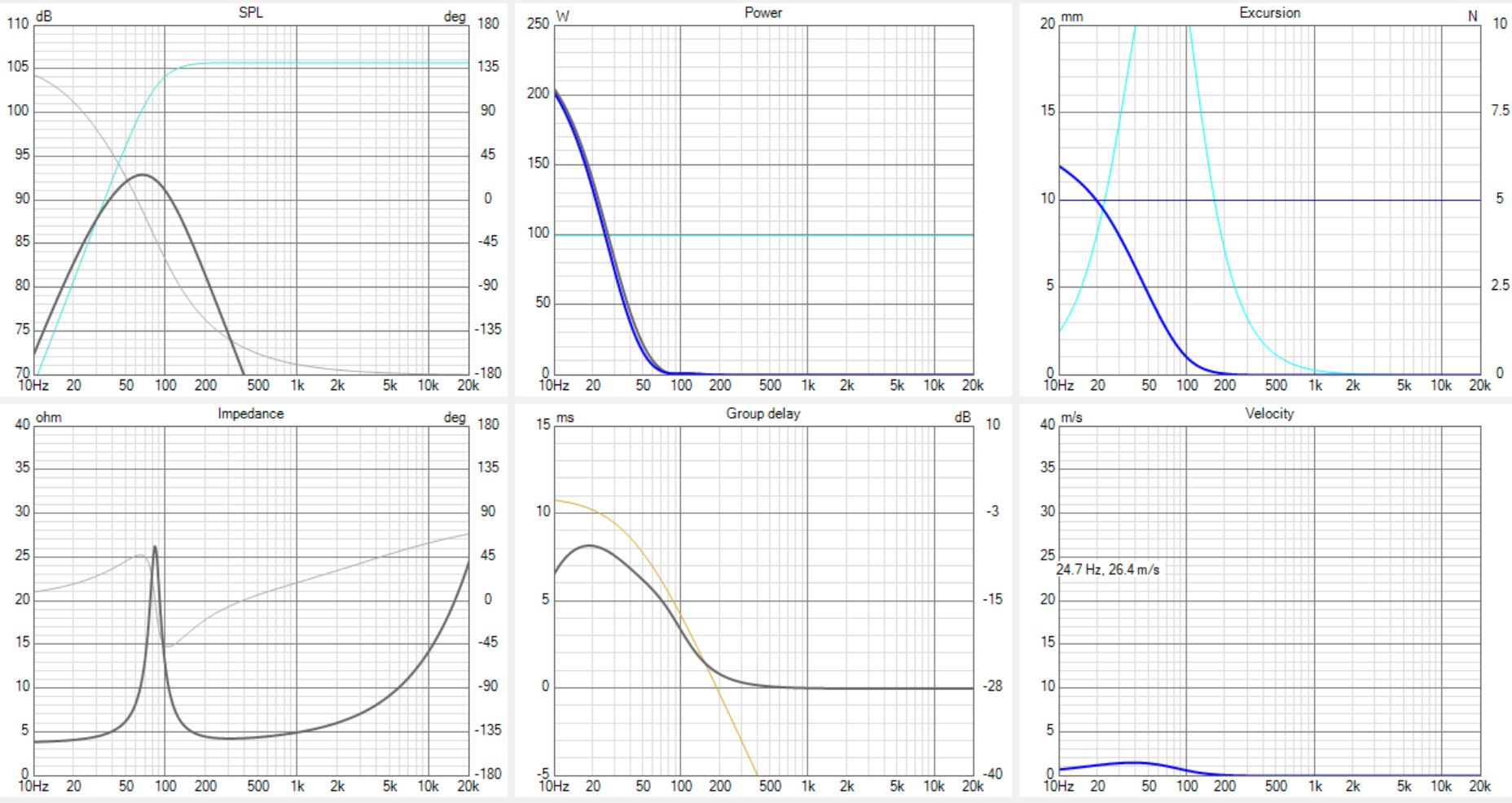

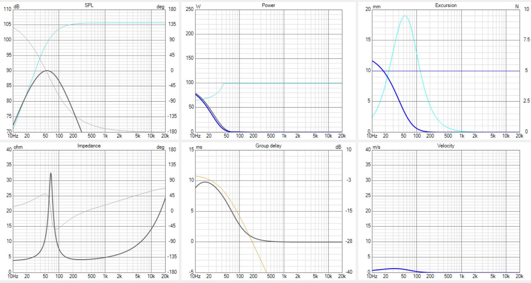

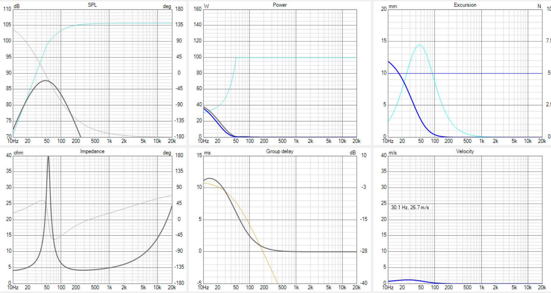

So I redid my modeling. And I was off on my previously quoted SPL figures. It must have been for the max excursion. Not 12mm. It was like a year ago so forgot. Anyways I did it again for an F3 of 30hz, at 12mm excursion, in a cabinet volume of 4L, 7L and 12L. Results for each below. Which volume allows us to get the most from that powerful motor system?
4L:
7L:
12L:
4L:
7L:
12L:

You do not get anymore maximum SPL from a larger sealed cabinet as long as the power limit isn't exceeded. In a sealed cabinet, the SPL is purely determined by the displacement of the driver. What you do get is greater bass efficiency from a larger cabinet. Using a smaller cabinet will get you a higher F3, but it can be compensated by DSP. In a 4L cabinet the Purifi woofer can hit its Xmax without exceeding its power limit. Therefore, the maximum SPL in a 4L cabinet is exactly the same as a 7L cabinet. It just takes more power and more DSP boost for the same SPL and F3.
Also, on an earlier post you mentioned you get free 6dB boost from an in wall install. This is incorrect as well. Most modelling software default to half space for simulations rather than full space. Therefore this is exactly the same results as an in wall. Compared to a stand mount speaker, which is radiating in full space, you still do not get 6dB boost in the low end from an in wall install. For low frequencies simply being near a wall is good enough to get close to the full 6dB coupling gain per boundary because it is within 1/4 wavelength distance of the boundary. The real efficiency gain from an in wall vs a stand mount is in the lower midrange, where a stand mount is not within 1/4 wavelength distance of the boundary walls and do not couple efficiently.
My above modelling shows that you hit 12mm excursion in the 7l cabinet with 3db less output than the 4L. So 3dB more SPL is possible from the 4l cabinet. And my simulation is set on full space not half space.

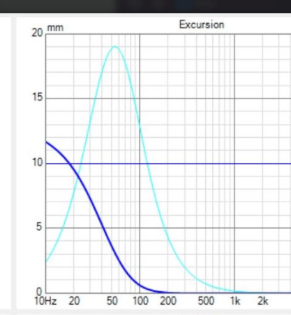

There is a difference in excursion between the 4L and 7L simulations that would favour the 4L in output terms.
If you look closely the 7L does not get to 12mm and at 30Hz the difference between the two is about 1mm extra excursion in the 4L box. 7L is 7mm as shown below, 4L is at 8mm.

That’s about 11.8mm and the 4l is 12mm. Would have made about a 0.2dB difference in spl if I added the tiny bit more power to hit 12mm.There is a difference in excursion between the 4L and 7L simulations that would favour the 4L in output terms.
