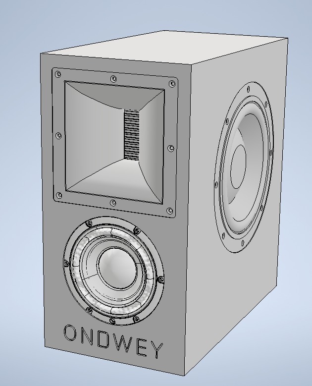

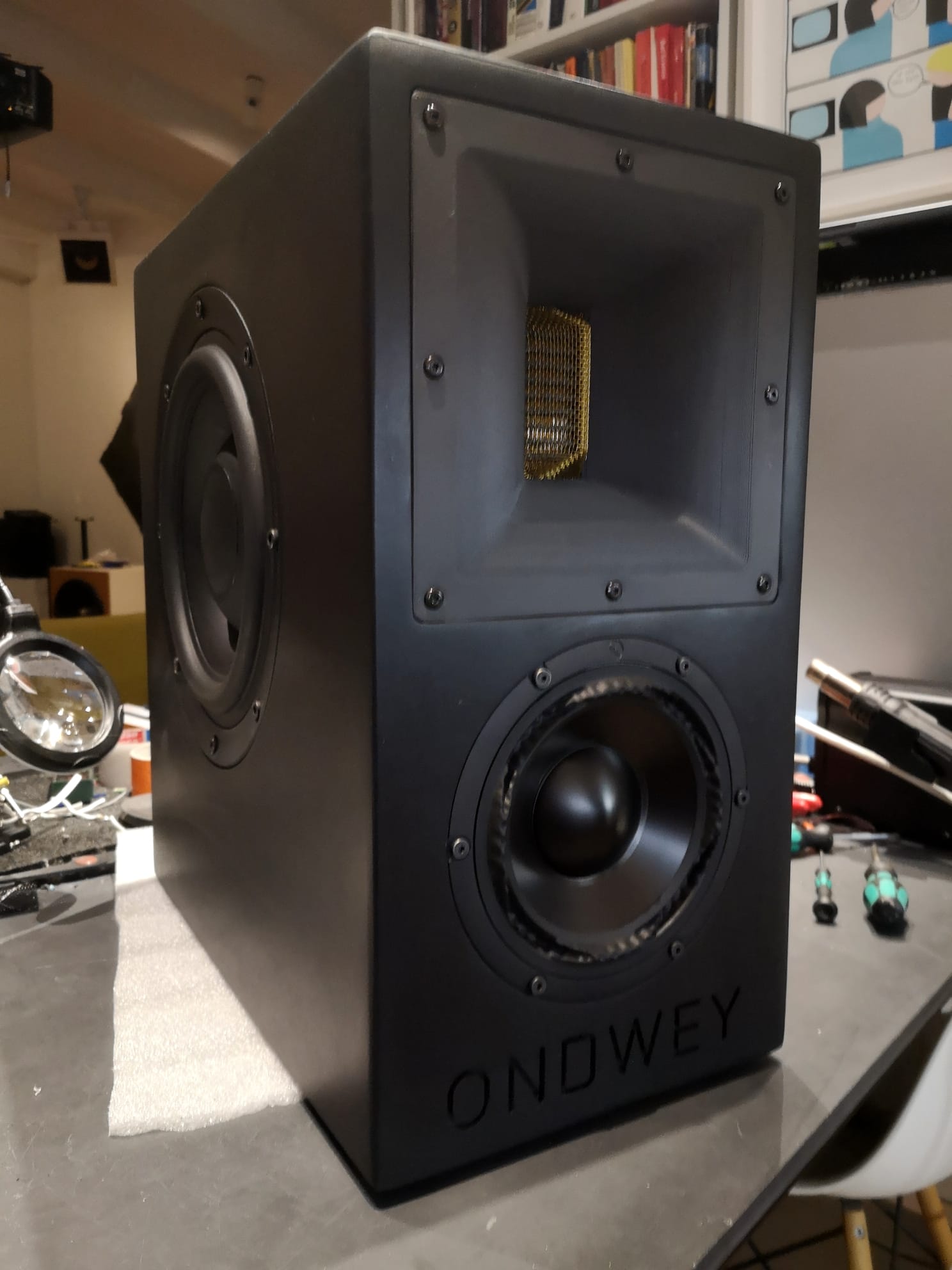

Hi guys, just wanted to add my grain of salt to the discussion about Purifi midwoofer in closed enclosure and show you my prototype in progress.
Actually the PTT6.5X04-NAA-08 is working flawlessly in sealed enclosure of 7 liters, and its frequency response and sound are top notch. Hi to @lrisbo and Purifi! <3

Nice work Adam! I did not know that the new woofers are not made of paper anymore? That looks like an aluminum cone witha dustcap. I almost that was a Beyma TPL150H, but it is not. Super looking compact speaker you have.
It is Mundorf AMT 25CS2.1-R in custom made waweguide.Which AMT is that?
Hi, this is the brand new woofer that i got from Purifi people for evaluation and testing in my prototypes, indeed the cone is aluminium, not paper.Nice work Adam! I did not know that the new woofers are not made of paper anymore? That looks like an aluminum cone witha dustcap. I almost that was a Beyma TPL150H, but it is not. Super looking compact speaker you have.

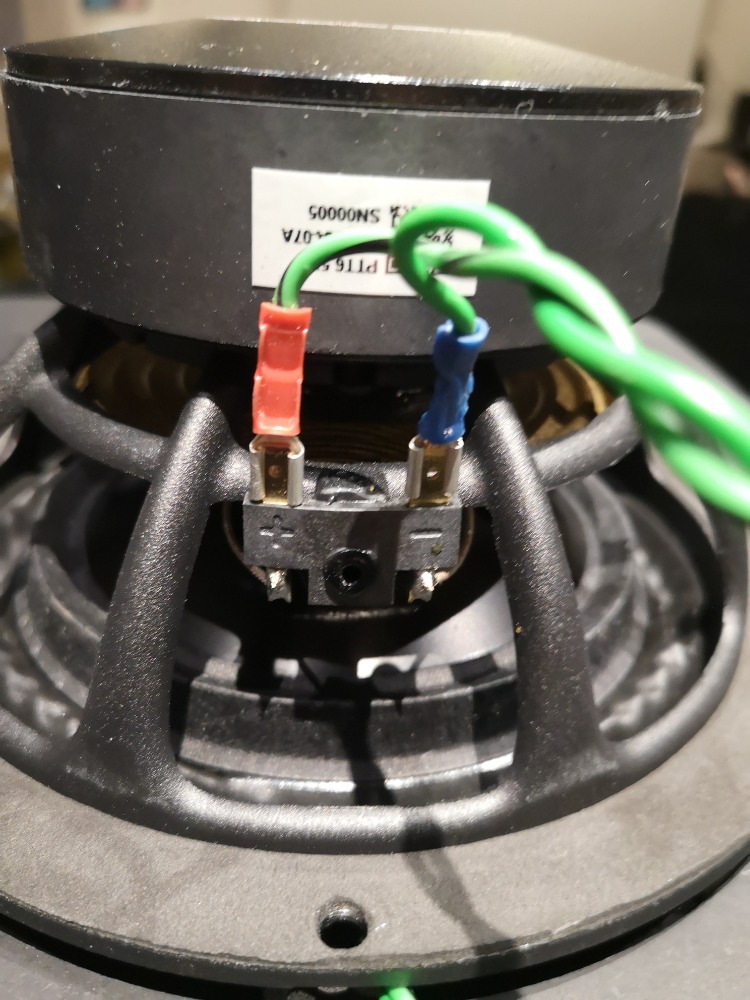

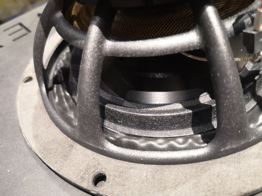

Could you make a picture of the backside of the new alu cone? Is it folded or supported/damped in any way like the paper cone of the 6.5"?

Hello Boden,Hello Adam,
of course i can, here you go, see for yourself:

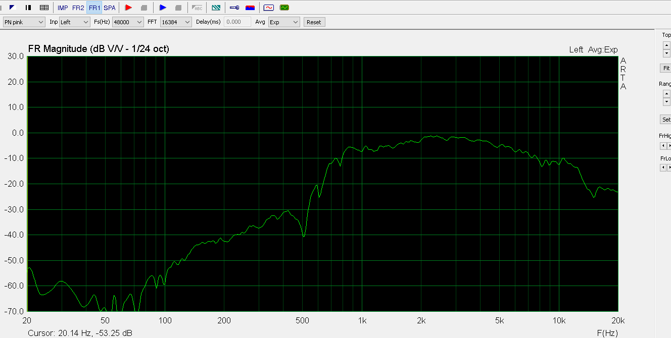

Very cool! Have you measured how the AMT performs in the waveguide?
Hi, thanks. Actually i did just a quick sweep in Arta to see that it is working. Proper on and off axis splice measurements will be done
next week, and i will post them if you like.

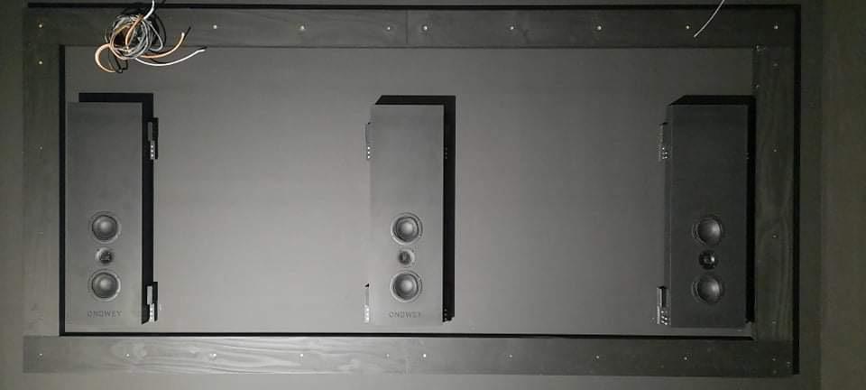

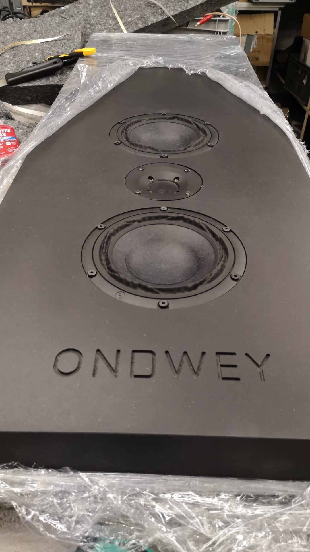

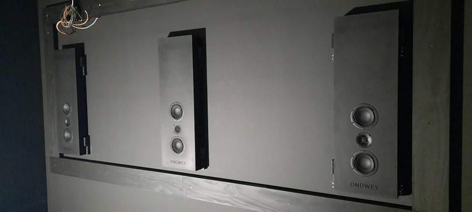

exactly, i have built a lot of vented (with passive radiators) and sealed prototypes using Purifi PTT 4 inch and 6.5 inch midwoofers, and i must say that they sure can take beating without a sweat, and i have not found slightest disadvantage with using them sealed, on the contrary. Of course they are demanding powerful amplification, but that is not a problem nowadays. FYI here is my build of flat Dolby Atmos mains in custom home cinema room, where i am using two PTT6.5X08-NFA-01 in 24 liters sealed enlosures behind acoustically transparent screens. Pics were taken before absorbers around them were installed.
