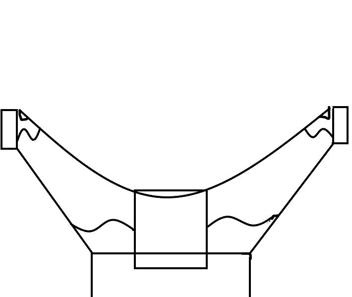

I'm aware of that what's known about this surround. My question was rather - why surround has same geometry despite different working conditions? Surround in midwoofer has to take around 3x bigger Xmax than that of Mid. Also I'm not so sure how such surround affects diffraction. When it comes to Mid surround I had quite a different idea of how to solve such problems 😉 (quick and dirty paint).

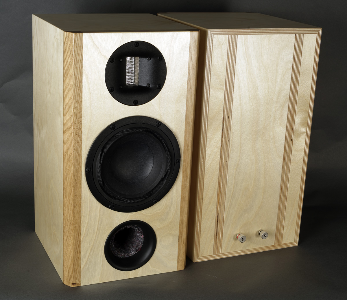

Well, look what I found Purifi-6R
Perfect resource for those who just want to own Purifi sooner rather than later and strawman for the keyboard warriors to take aim at. I'll start the latter by saying I am certain this design would sound better if it was a 4-way using any random 10" or 12" woofer and a 3" dome midrange that only presently exists on Russian hifi forums.
Confirmation bias demands I add this quote from Troels' text:
Playing this rare Musica Nude vinyl recording, which I played hundreds of times, immediately made it clear this mid-woofer is special. Resolution was the first superlative that came to mind. I also know that whenever we introduce a new driver, we'll always hear something we didn't hear before. But having a ruler flat mid- to lower-treble response made it clear it wasn't just a peak or whatever that might have brought some details to life, rather a genuine ability not to smear the signal it is fed.
Clarity and resolution all indicates low distortion. Accuton C173 also came to mind, but without its distinctive character to the sound. Now, the Purifi doesn't work alone, the clarity of the Viawave ribbon defines the timbre of any basic note. Without overtones we don't have the tonal characteristics of any instrument. So, what counts the most? We can't tell, but only conclude these two drivers make a great couple crossing over around 2.2 kHz thanks the wave-guided ribbon.
What I don't like about that design is the bypassing of the highpass capacitor in the network with a resistor. This leads to hot resistors being across the amplifier directly and makes the amp run hotter. It also leaves nothing but resistance ahead of the tweeter, and makes the tweeter play lower with possibly higher HD than necessary.
I've heard other builds that do this, and the tweeter is unfavorably unappreciative of the added stress. The protective rolloff has reduced efficiency, and therefore lets more through.
My 2c,
Wolf
Addendum for clarity: Having a parallel CR is not always detrimental as long as there is an additional highpass capacitor either upwind or downwind from the CR filter. This prevents the direct resistance across the amplifier in the lowest FR range and keeps the resistors and the tweeters happy.
@wolf_teeth Yes, that was really surprising to see. And as we know, the tweeter is transformer coupled, so it has close to 0 ohms at DC, meaning any DC from the amp will load the series resistors only. The same thing will happen with any low frequency content in the signal. In order to have any kind of function the resistors has to be relatively low resistance as well. This is a very unusual design choice.

Thank you your excellent question. I am currently working on dedicated mids with a narrower surround. The advantage of a narrower surround is that Mms goes down and Sd up which improves sensitivity. It can on the other hand be more challenging to handle the cone breakup. I am running massive computer optimisations in Comsol/Matlab and there is still some work before we can get it tooled and prototyped. The 6.5X took many years to develop and despite we have refined our toolbox then great things take time (have to remind my self of that occasionally)
Meanwhile, we released the current M versions of the 6.5 by reusing the geometry but modifying the motor (shorter coil, reoptimised shorting rings). The rubber composition has been changed to optimise the frequency response. This offers pristine midrange with improved sensitivity.
Diffraction: the surround is so small that it only affects the shorter wavelengths. The biggest issue with a mid is that the cone it self adds quite a bit of diffraction to the lower octaves of the tweeter sitting on top. This is an issue for all mids.

Thanks for your answer. I know very little about design processes so have no clue how long does it take, but I was kind of guessing that You just went short route and made softer surround with same pattern for mid without doing much more. Keep up the good work You're doing 🙂
