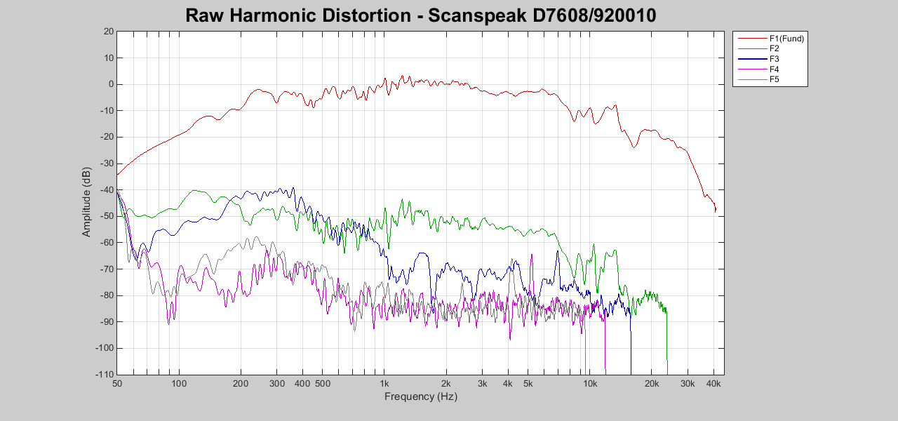

My impression is that the MDM55 is a very good midrange, especially for the price. But, I'm looking for an exceptionally good midrange and I'm willing to spend a fair amount on it. It seems, however, to be remarkably difficult to find a small driver with exceptional capabilities - especially HD - over the range of, say, 800 hz to 3Khz.
One would think, for example, that the Scan Speak 12M and 12MU would fit the bill, but if the data at HifiCompass is indicative, both are less than stellar in HD over that range. In fact, the SB15NBAC seems the best match to the PTT6.5.
I'll be quite happy if the PTT4.0 is as capable in the upper midrange as the PTT6.5 is below.

The old vifa/peerless/scan-speak dome is still pretty good: (..though it will require a higher order high-pass crossover for higher spl use.)
I use these above the purifi 6.5 , before the tweeters. They are impressive.
Do I think the etons are broken - Hell No.
Best jasdiy
Thanks for the suggestion - they do look very good. I wonder how the currently available 3-212 compares.

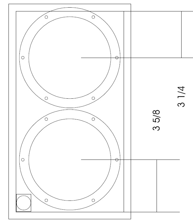

Can't wait to hear your review. Can you share where you place the radiators? Its amazing given the size of your cabinet.
There is a story behind the design of this speaker where the Purifi woofer and PR parameters meet the pandemic and Norman’s personality the moral being sometimes constraints are good for a design process. We’ll get into that later.
For now the answer to dewdrop’s question is the passive radiators cover essentially the entire back panel. The attached drawing shows the box rear view with PR’s cutout diameter, mounting screws locations, and frame OD. The dimensions (in inches) show where the centers of the cutouts are located off the top and bottom edges. They are pushed up a bit to allow the Speakon connector shown in the lower left hand corner to just fit.

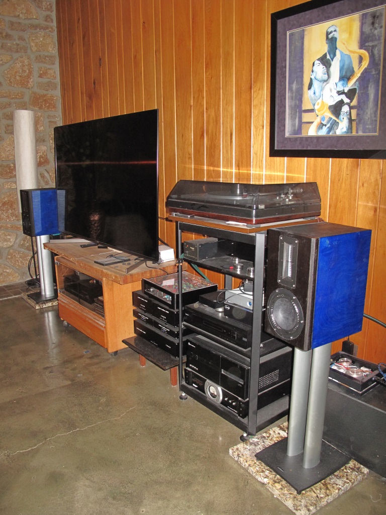

At 10:30 last night the last of the 22 screws mounting transducers in my first speaker design using Purifi transducers were tightened and I moved the speakers from shop to listening room. This is a report of the first listen to that system.
I call this design Fi16v1 (Purifi drivers in 16 liter enclosure version 1) it uses PTT6.5W04 woofers (one per speaker), PTT6.5PR passive radiators (two per speaker), and Fountek CD 2.0 ribbon tweeter. Crossover is external and should not even be considered a preliminary design. It is repurposed from my NT10 design as a stand in while drivers are measured and Fi16 crossovers (both passive and active) are designed. DSP in JRiver music player software was used to correct the 8.5 dB difference in sensitivity between woofer and tweeter.
