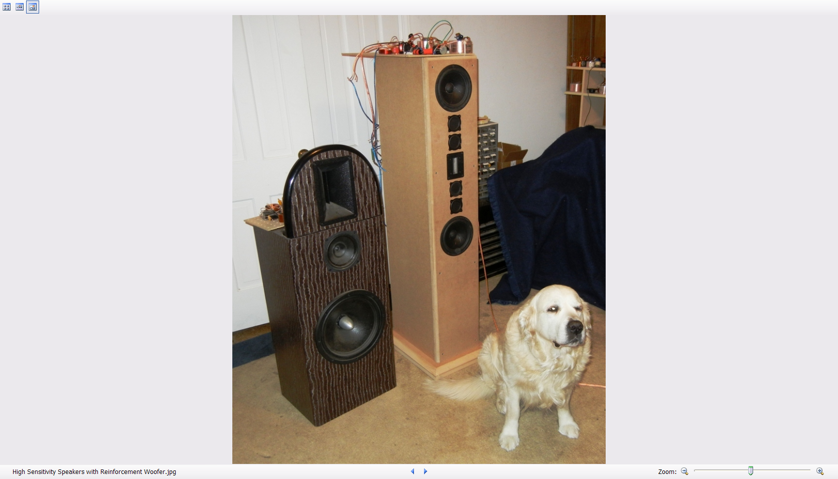

I can certainly vouch for the surprising quality of the BMR midrange despite it's entry-level pricing. I have a pair of the Purifi 6.5's coming, and they just happen to have almost the exact routing dimensions as the Scan 8545-01 woofer I use in the stock BMR monitor. I'm sure there will be a lot of raised eyebrows when I mate it with the $16 BMR mid, but I don't know of anything that works as well. I tried the Accuton mid, and although it measures flat as a pancake, I just couldn't get rid of a kind of smeared coloration, perhaps because I had to use a higher woof-mid crossover point with the Accuton. The one problem with the BMR (other than its, uh, unique appearance), is power handling. I'll just have to see whether the BMR unit can stand up to the output capabilities of the Purifi. Of course, there are ways to improve the BMR's power handling...........
I love the dog. Expression on the face same as my wife when I buy more speaker stuff. Haha. You won’t be disappointed with the purifi. Should be louder and cleaner than that woofer. I mean the Scan woofer!!

The dog has a very low opinion of me and my speakers. I'm new to the forum and while I've read through most of the posts, I can't find exactly which AMT is being referenced. Can you educate me? thanks

First off good looking pup in the picture, I like the 'quit messing with your stereo and get me a treat' expression captured.

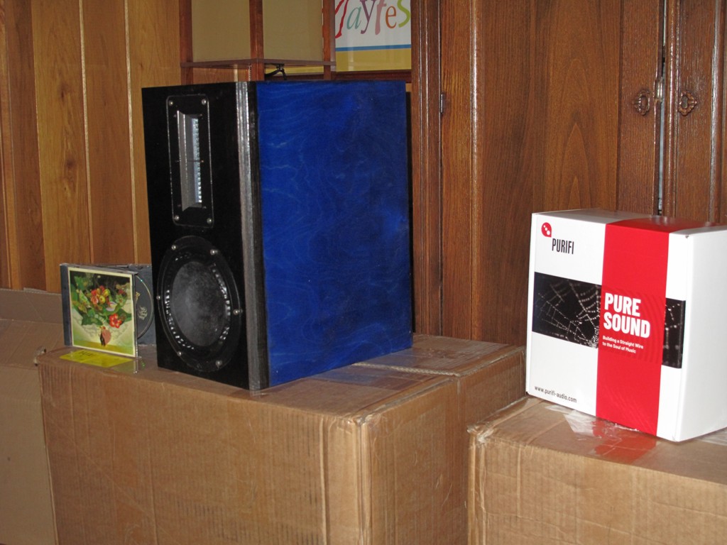

Back to PURIFI here is a preview of the system I am a few hours of drilling and wiring away from listening to. Features 16L/0.56 cu ft enclosure each with one PTT6.5W woofer and two PTT6.5PR passive radiators. Tweeter is a Fountek Neo CD2.0 ribbon.
More details soon, for now I need to concentrate on getting my group buy guys their transducers.
For extra credit who can identify the title of the CD used for size comparison?

Musicmagic by Return to Forever

"Like" 😀
We have a winner. James will receive +5 points on this semester's final.
