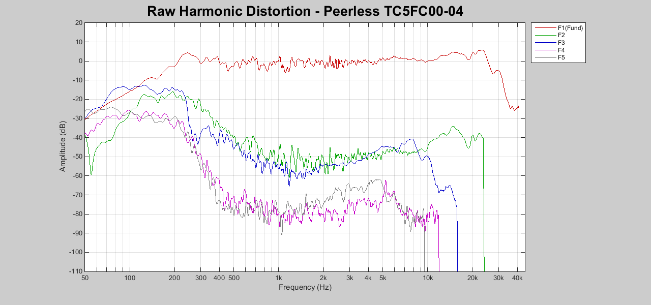

..done right, a small array of the Peerless TC5FC00-04 might do just what you are looking for. 😉
The array will of course generate even less non-linear distortion for a given output level.
Best overall from 800-4 kHz with a good crossover. Excellent from 800-2 kHz.
Inexpensive (even in an array) as well! 🙂
If you don't mind metal, the the Peerless TA6FC00-04 is even better above 1 kHz.

Tim's measurements, and remember: the array will result in lower non-linear through decreased excursion for a given input level. (..and of course crossover filters tend to lower higher order distortion within the operating pass-band.)

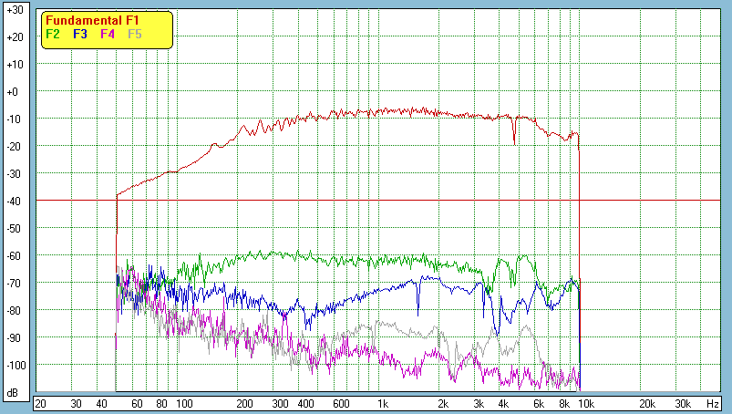

hifi compass has measured the Accuton C50 and the 2"BMR. There might be other independent measurements somewhere.
C50, 2nd and 3rd in the 800 - 4k under -55

BMR 2nd and 3rd is below 50 800-8k with a tiny blip above -50 around 2.5k, but still belwo -45. but check out the off aisx 30deg in the same frequency range.
Tectonic TEBM46C20N-4B | HiFiCompass

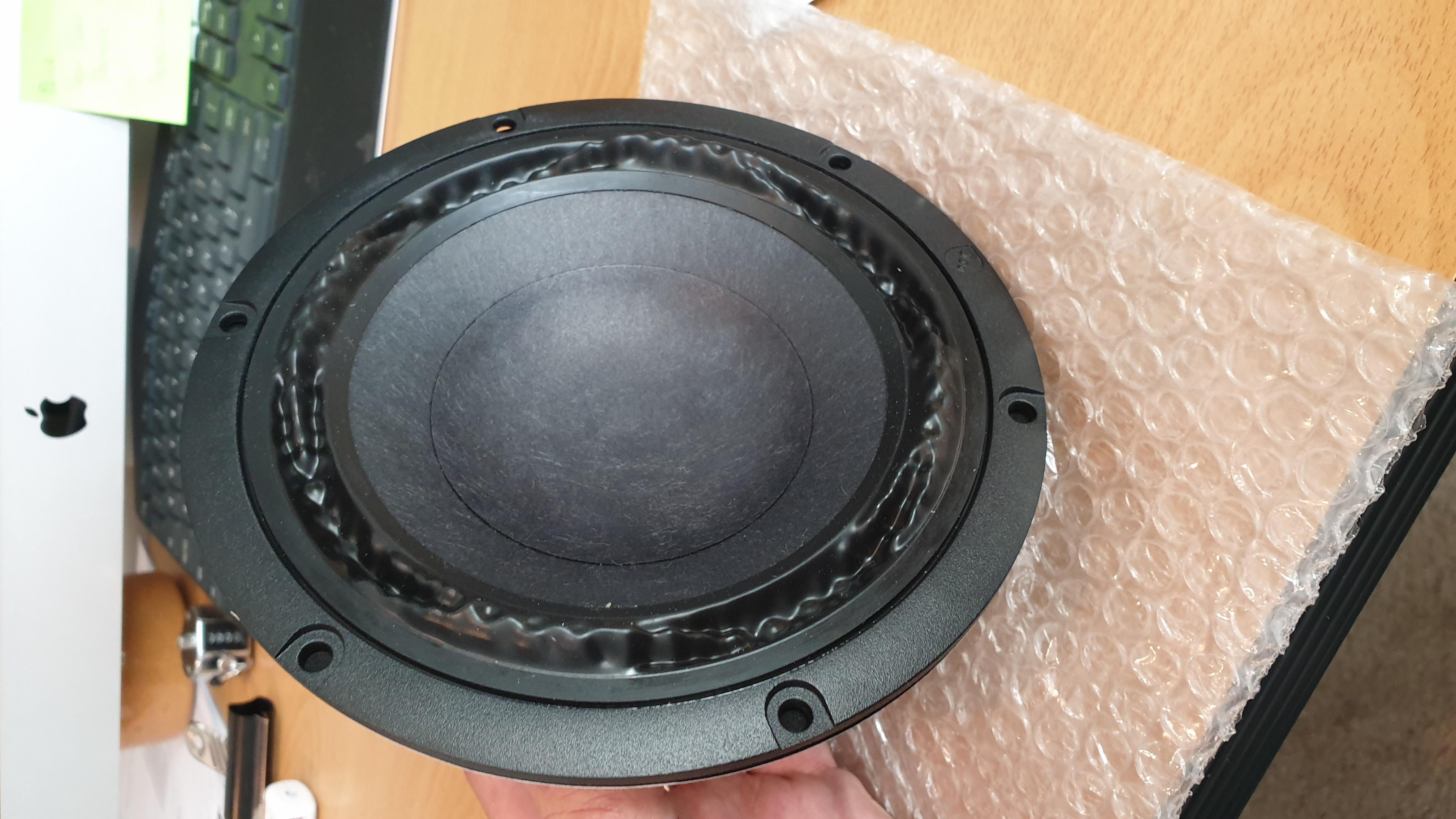

All the VC windings. I wonder if that is intended to be like a TC Sounds LMS design with variable winding density linearizing the BL curve.
Looks like a Bimax spider - the ones I've worked with have a tendency to change a great deal with extended break-in.
That surround is wacky. Surely that can't be the only way to idealize the behavior of a surround. It reminds me of the profile of the woofer surrounds in the new Technics high-end tower speakers.
