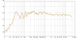

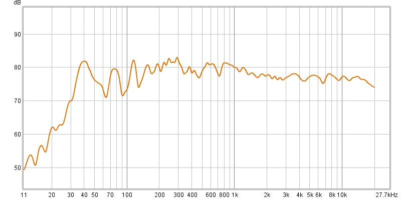

Here's my quick and dirty uncalibrated REW measurement. Woofer BW12db slope at 1550 and tweeter BW18db at 2500 - this is a work in progress.

Could you please write something about over all sound ? Do you like AMT or would you change it with something else ?
