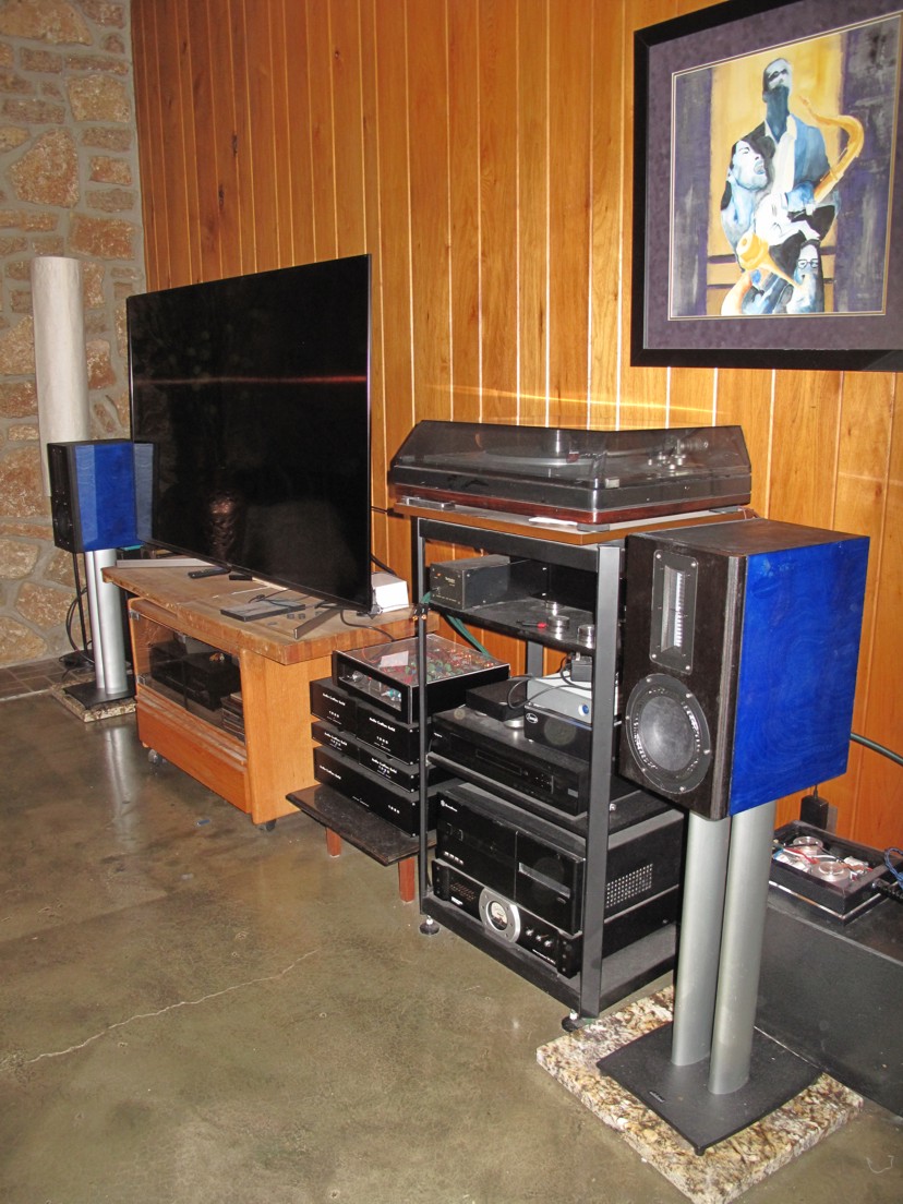

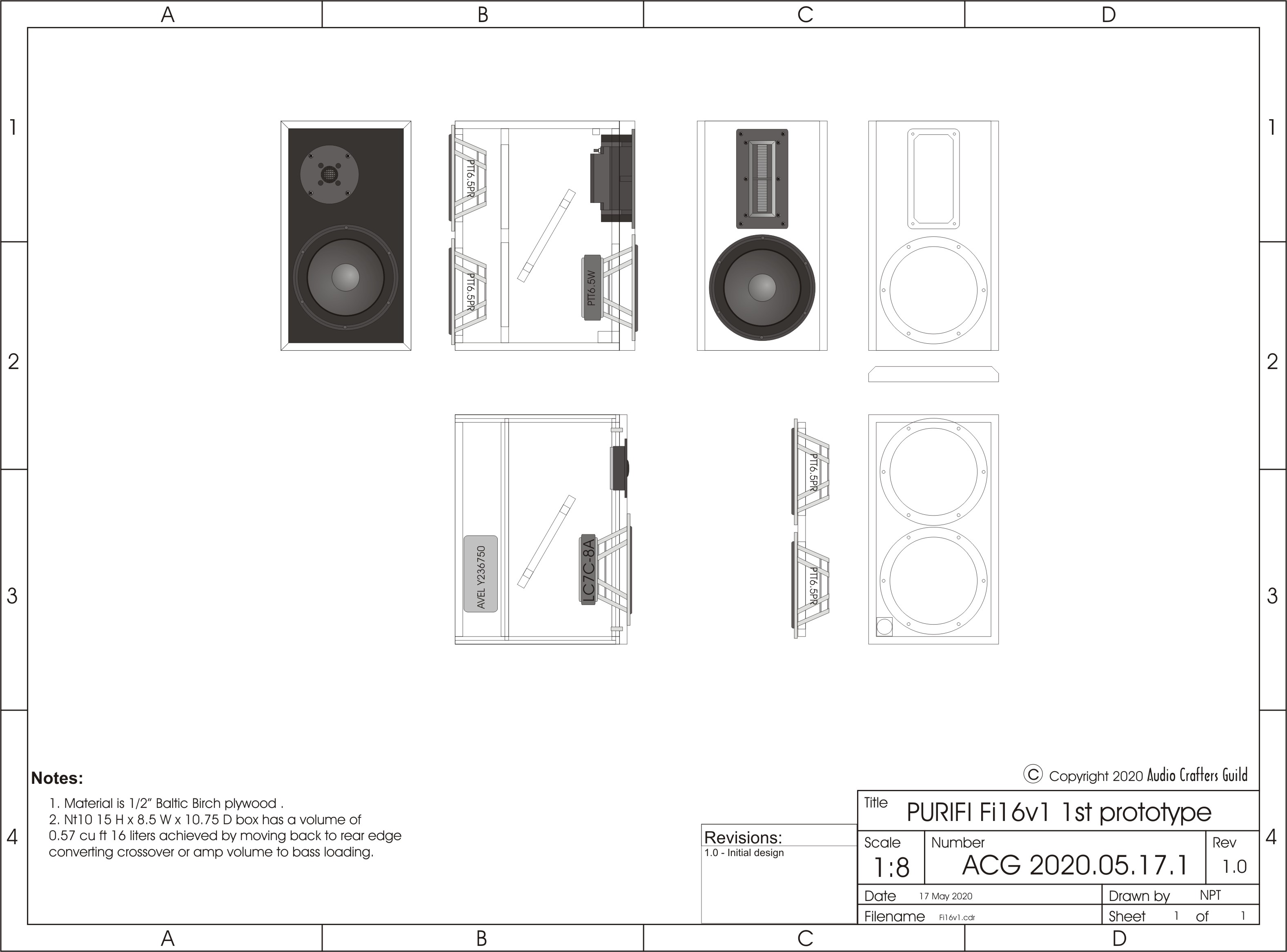

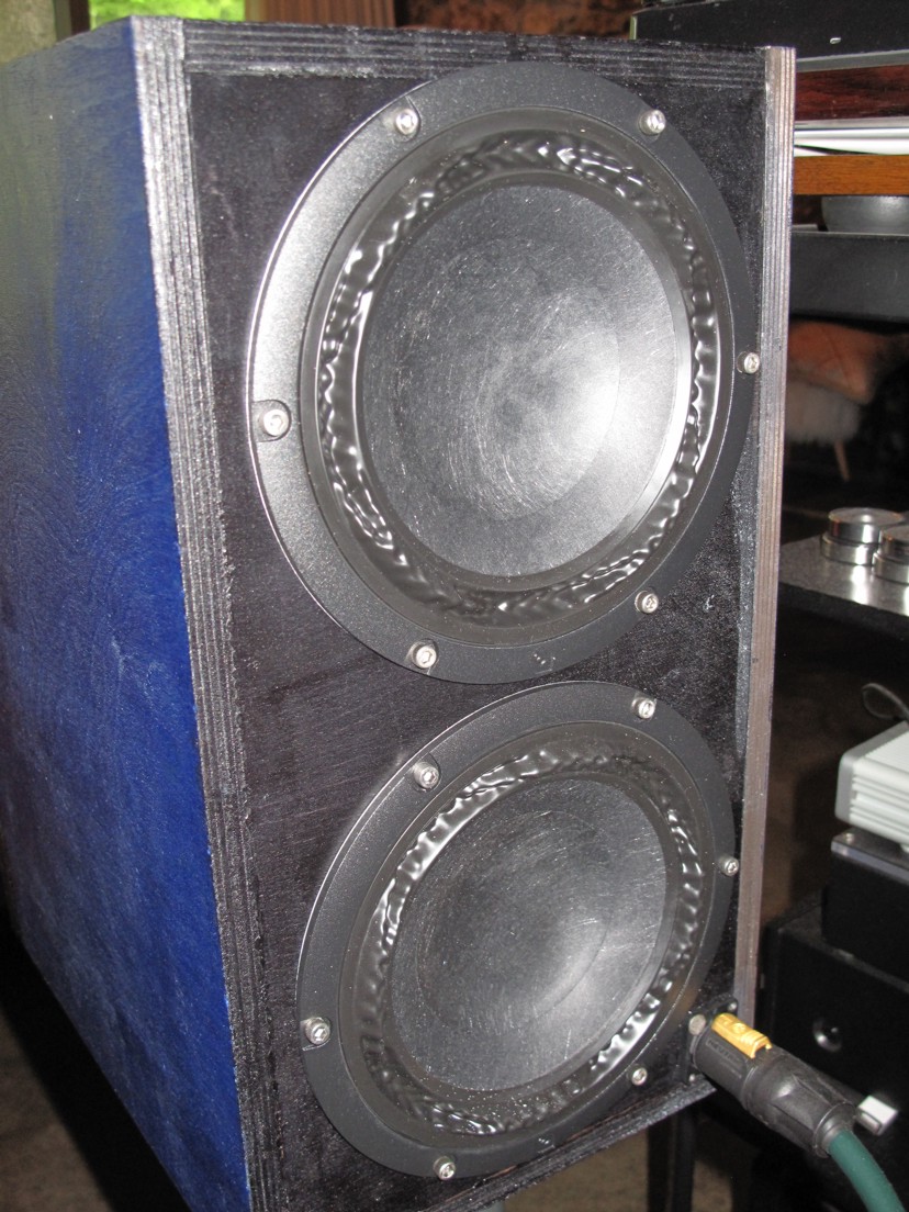

Pictures and a diagram of my first PURIFI design Fi16v1 (Purifi drivers in 16 liter enclosure version 1) it uses PTT6.5W04 woofers (one per speaker), PTT6.5PR passive radiators (two per speaker), and Fountek CD 2.0 ribbon tweeter. Crossover is external and should not even be considered a preliminary design. It is repurposed from my NT10 design as a stand in while drivers are measured and Fi16 crossovers (both passive and active) are designed. DSP in JRiver music player software was used to correct the 8.5 dB difference in sensitivity between woofer and tweeter. This is the speaker yielding the results for the listening report I will post next.

In the report of the first listen at late night background levels to my speaker system based on PURIFI PTT6.5W04 drivers I call Fi16v1 I promised “will post follow up listening notes with unconstrained volume levels”. Here is that report based on a week of listening.
At background, normal, and high listening levels it is constantly apparent that PURIFI have delivered on their goal of significantly reducing distortion and extending bandwidth of the 6.5 inch 165 mm class woofer/midrange. The improvements over the previous state of the art I am familiar with are plainly audible across the drivers’ entire bandwidth.
What I find thrilling and the fulfillment of PURIFI’s promise to have ‘cracked the long stroke code’ can be illustrated describing how they reproduce the cut “Morning Mist” from “Ahmad Jamal: Live in Marciac: August 5, 2014”. This track is largely a solo showcase for bassist Reginald Veal with pianist-composer Ahmad Jamal, drummer Herlin Riley and percussionist Manolo Badrena joining in with occasional flourishes and as an ensemble at the end. In hi-fi engineering we have a dilemma. The path to low distortion leads to chasing every resonance out of the system while paradoxically the sounds we wish to reproduce are full of, literally made using, resonance’s. Case in point is Veal’s bass. As he solos through “Morning Mist” he is playing sparsely, deliberately using decades of skill to coax the sounds he is weaving into music from his instrument. Too often with hi-fi by the time our speakers are tamed into low distortion and uncolored sound the music that emerges is homogenized and bleached. Those two adjectives are a bit excessive for what I am trying to describe. The Accuton woofers in the system I moved aside for the Fi16v1 are anything but ‘slow’ or ‘dull’. What PURIFI brings is that when Veal strokes or then in contrast firmly plucks a string the resonant nature of the device making the sounds is so wonderfully explicit. These speakers absolutely love bass players, here Veal begins simply plucking the melody out one note at a time, when his runs descend down the E string the power so effortlessly generated by a tuned resonant device is reproduced with unaccustomed clarity. Some reviewers call this ‘jump factor’ when the sound scales the dynamic range so easily the listener is startled. Also at play here is that the trailing side of sounds are tracked unusually well, the previous notes are reproduced then we have a quiet from which the next note emerges. Four minutes into the track and Veal is sprinting through the notes and the PURIFI’s skill at the pace, rhythm, and timing aspect of hi-fi is demonstrated. By six minutes in the solo is winding down, the appreciative audience applauding as Ahmad Jamal enters softly playing the melody. While the percussionists add little sparkles the solo becomes a duet between stand up bass and grand piano. The tonality of the instruments is reproduced with great delicacy and the duet+ at times seems a bit of a jazz duel as Veal and Jamal each add power and density to their playing. And then they expertly take it home the pace and intensity trailing off with the empty space between the notes finishing the story. With a final declarative note Jamal signals the band and audience its over. And then a quiet ‘thunk’ is heard, it’s the sound of the piano’s dampers releasing onto the strings. That sound has to be many 10s of dB’s down into the noise yet there it is.
Ok, enough of this tonal beauty, delicacy, and filigreed finesse, what about big bass? Ok, as an ardent fan of progressive rock like Yes, ELP, Genesis, Jethro Tull first stop is of course Pink Floyd DSOTM the faded up heartbeat on ‘Speak To Me’. The depth of the manipulated bass sound is there in full and as the music transitions into the following cuts many times the extreme deep bass underpinning the work is fully present and accounted for. Its 1970s stadium rock so of course we also have plenty of guitar leads soaring over the proceedings. The PURIFI’s party trick on Floyd or a Philharmonic is how they simultaneously reproduce subwoofer deep bass along with very clean and clear midrange. Skipping forward a quarter century the audio show fav ‘Indus’ off Dead Can Dance’s Spiritchaser allows the PURIFI’s to show how they cope with really deep synth bass. Here let’s just say ‘wow’. The woofers and passive radiators were really dancing on this track. Given the levels of energy this woofer is capable of putting into both the room and reaction forces into the enclosure system I am considering ways to fasten them to the stands and in later designs incorporate extreme measures like sand filled damping chambers.
The most impressive track for hearing the PURIFI’s bass capability is…..every track, movie, and TV program. Rather than look for the hi-fi demo piece cranked up just go about your regular listening at normal levels. The first thing you’ll notice, and quickly get used to, is how easy it is to hear all manner of detail about what’s going on in the bass and mid-bass. And then every so often along comes something in the deep bass and its another ‘wow’ moment.
The above paragraphs read like I’m reviewing a subwoofer, bass this and bass that and bass bass bass. The bass is what leaps out as different and better than the norm when first listening to PURIFI transducers. But the bass is not even half the story. All the measures to reduce distortion and compression effects are also immediately audible and all for the good. Over my decades as an audiophile (sigh…so dang old) one of the characteristics I have learned to listen for while judging hi-fi is how apparent and revealed are the fine details of the textures of the musical instruments and voices used to create the work being played back. Across its full range the PURIFI transducers deliver an overflowing abundance of such nuances and filigreed tonal textures. But its not the delicate wispy detail of a electrostat because here that detail is riding along a dynamic capability and ease one usually hears from large format horn speakers. I suspect the lowering of distortion and ringing combined with dynamics unleashed due to previously unidentified hysteresis effects here addressed sum to this great effect. Then those details and dynamics combine with the openness and low coloration the mini-monitor architecture is so well known for. Result is pure musical bliss.

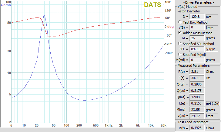

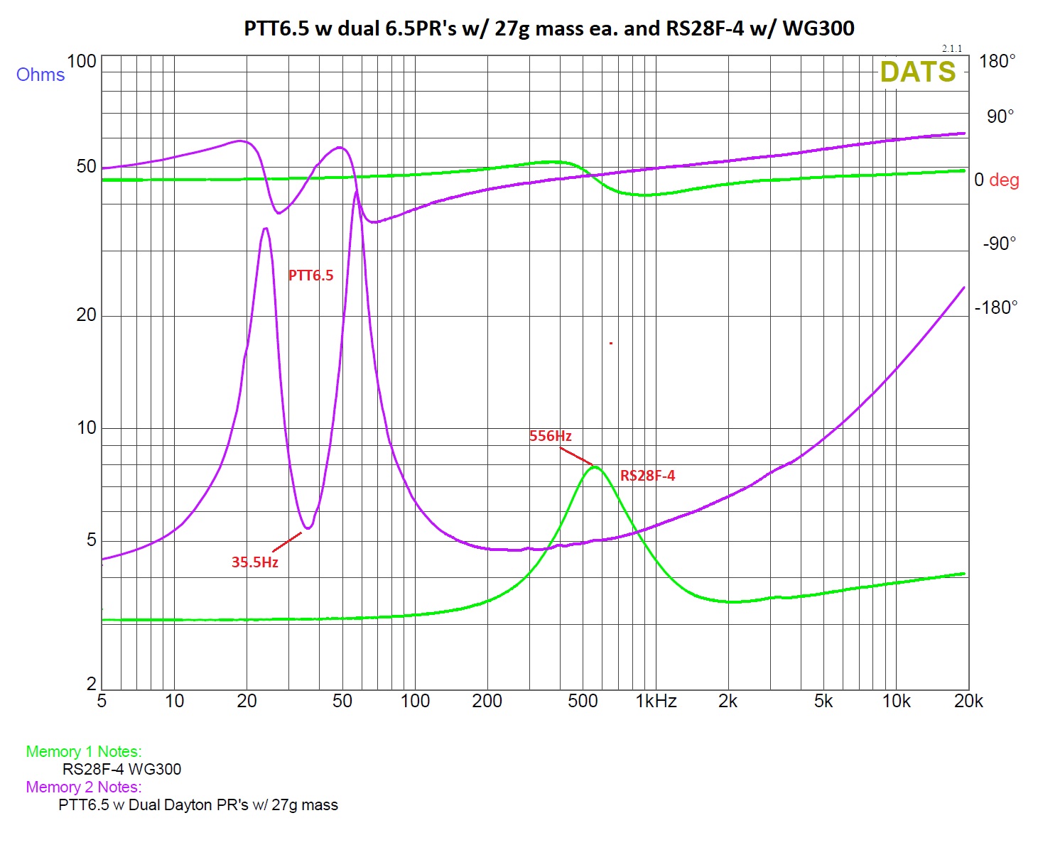

Here is how my box with dual Dayton PR's loaded with 27g ea measures. I am getting 35.5Hz tuning frequency, which should be sufficient for a compact 2 way. Looking forward to hear how it sounds once I make a first cut at a crossover. Also included is the impedance sweep of the Dayton RS28F-4 in a Visaton WG300 waveguide. It has a resonance down at 552Hz. If I cross at 1700Hz or so, this should work well.
Well, I now have the ZMA files. On to measuring the FRD's next. Then some doodling in Xsim to make a XO.

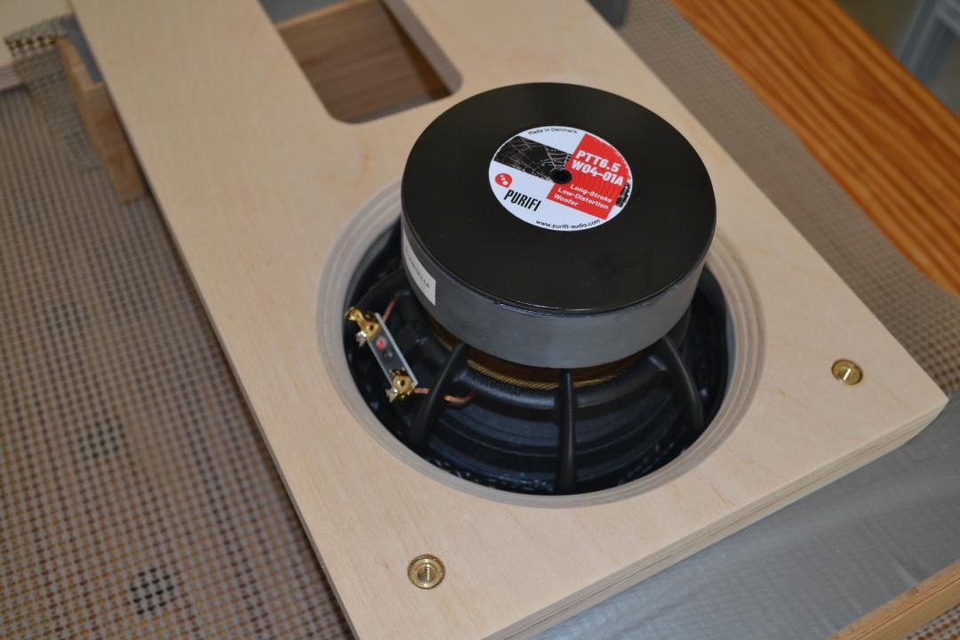

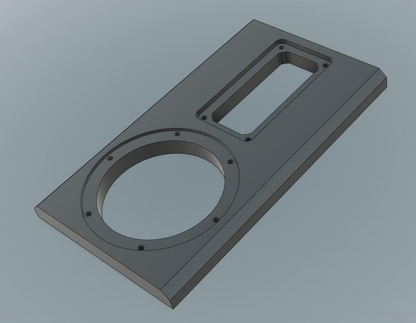

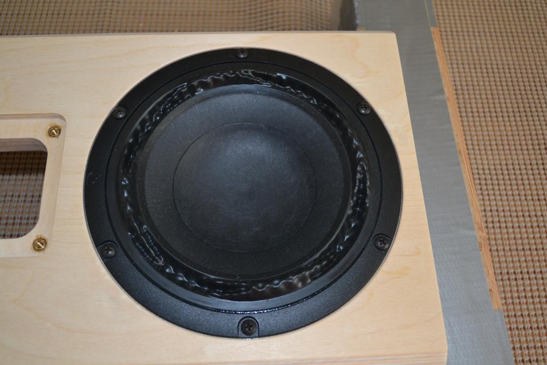

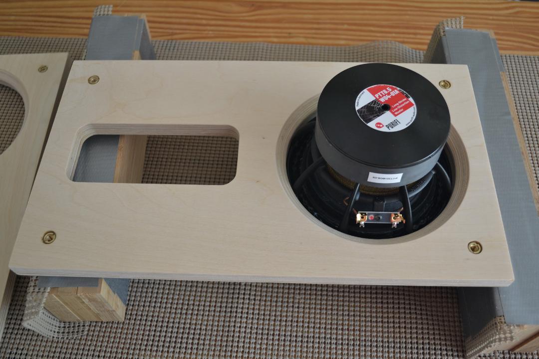

Based on my 2D drawings Steve Manning programmed and cut the front baffles for my Fi16v1, shown here before being stained black and sealed. Steve has other client's projects that use PURIFI drivers so he has the dimensions dialed in. I had him install the threaded inserts and they were perfectly positioned (because, calibrated CNC + operator skill). Given the cost of these woofers installing with 8-32 socket head screws is the way to go IMHO. I specified my preferred baltic birch ply, Steve also works in MDF, hardwoods, and (my next temptation) bamboo ply.

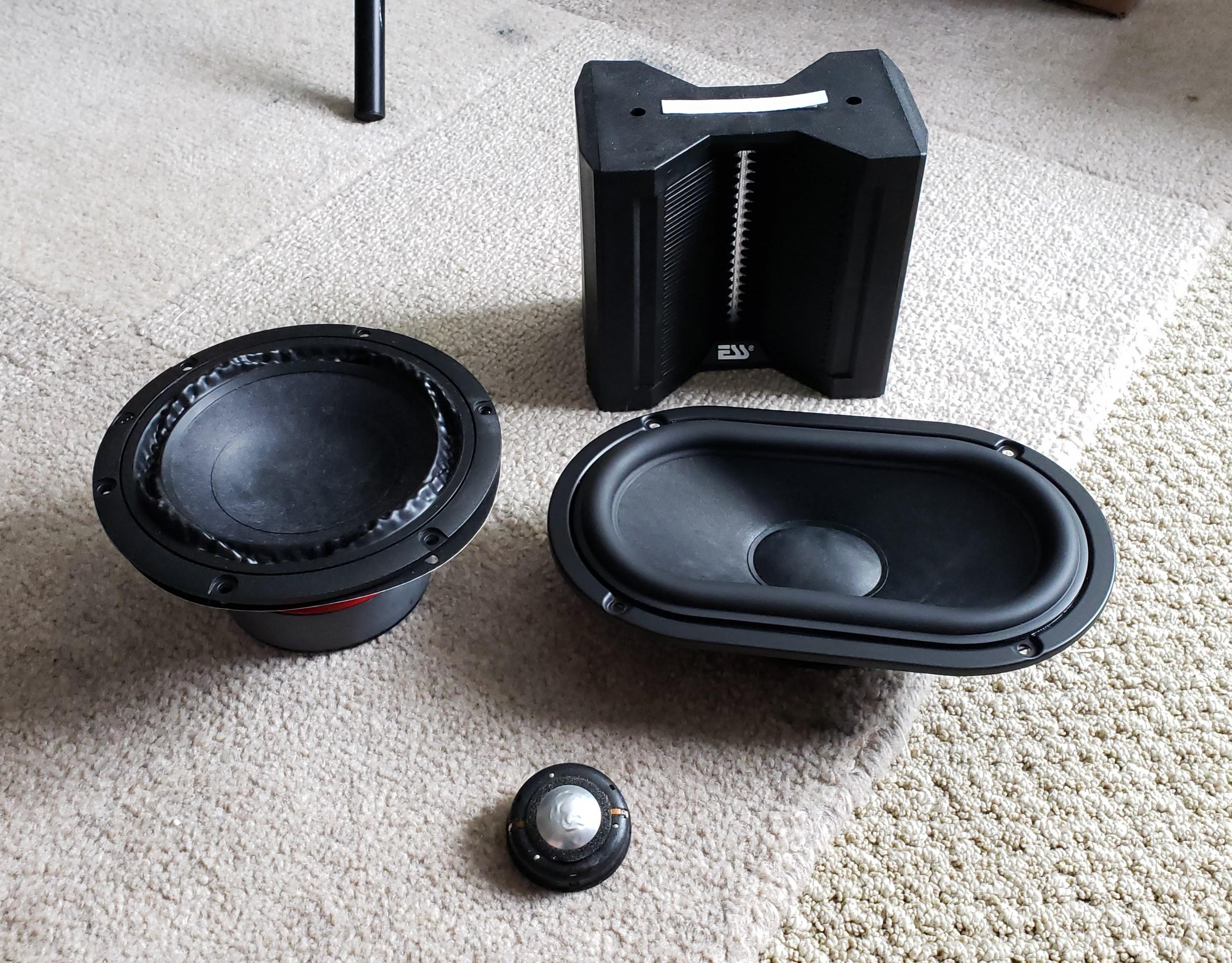

Here is my plan. For LF, I ordered a pair of the SB Acoustics PR to try out. They don't have enough xmax unfortunately but I don't plan to listen too loud so they should be OK. I do regret not getting the Purifi ones.
For HF, I have 2 options. I got a pair of Heil AMT as well a couple of B&W Nautilus tweeters from my friend's speakers. The AMT is OK, but has issues above 10kHz. The B&W tweeters can go down to 2.5kHz but not much more. These are what I have available for now. meanwhile I will do some research for a better pair.

jmpsmash I was also close to pulling the trigger on that PR. Please post your impressions when you get it all together! I am also wishing I'd got the purifi PRs but they are spenny for PRs.
As was suggested at the beginning of this thread the sb26adc is a nice entry level (ish) tweeter that will get you down to 2khz easy enough, all while sounding pretty good too and has the ability to keep up with the woofer output.
