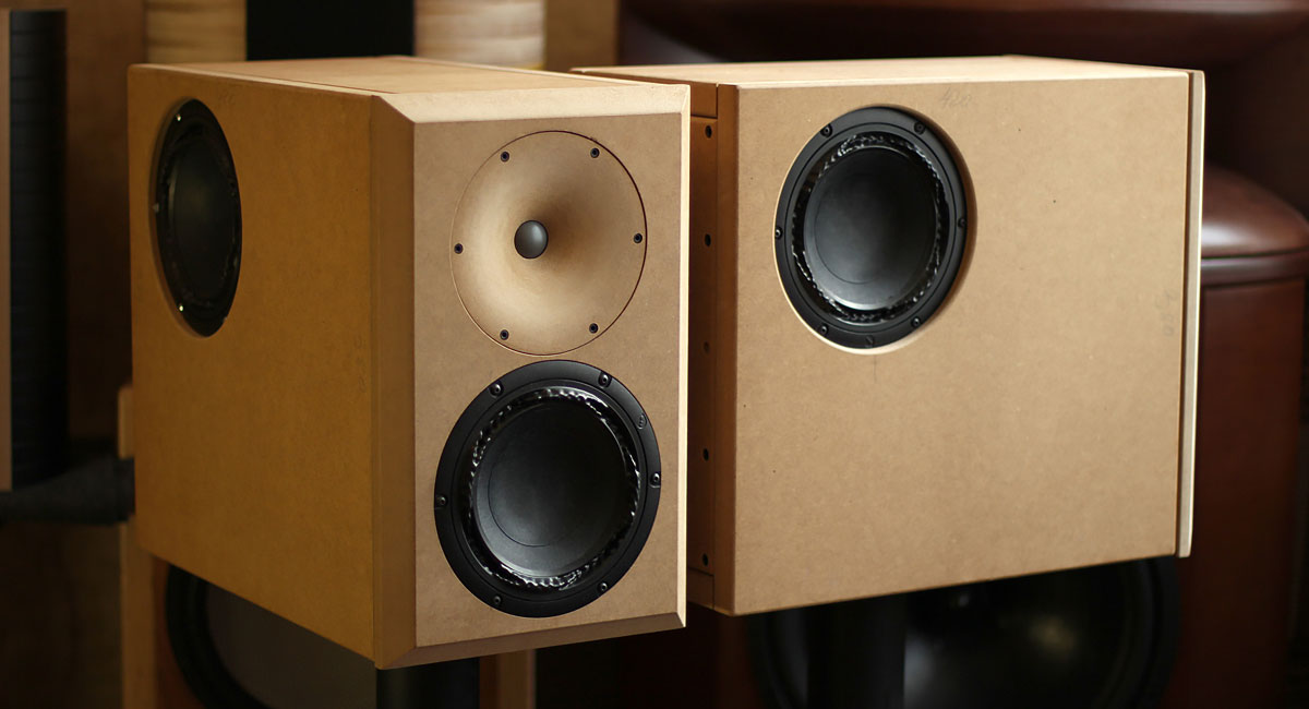

Are there downside on putting them on opposite sides? any phase issue?
I thought that too but it doesnt seem to bother HiFiCompass latest build ;) (thats a PR on each opposing side of his cabinets)

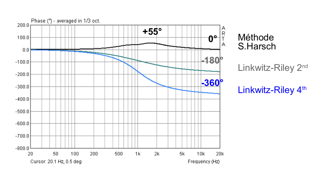

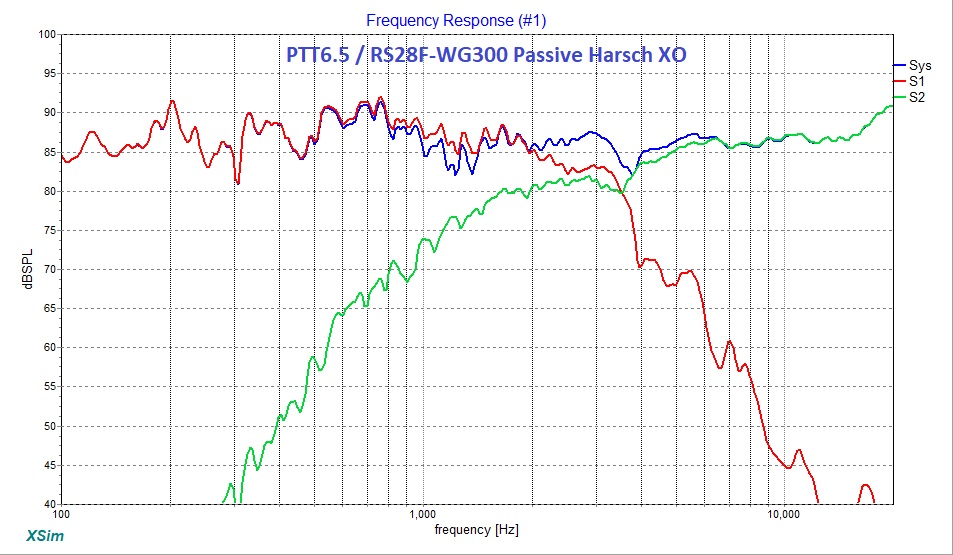

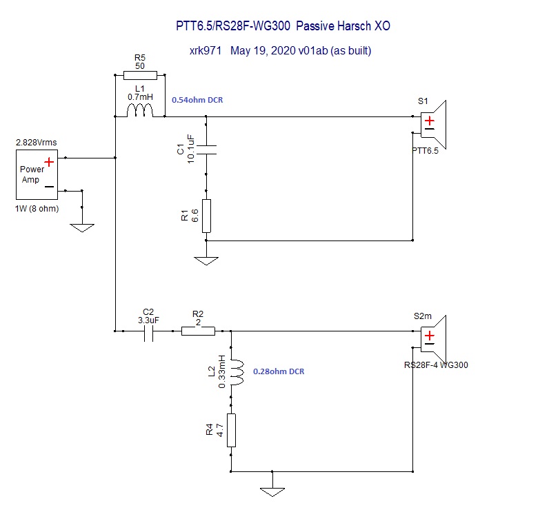

It's not well in phase. Try to reduce R4 and to increase C1 / L1.
If you look at the measured acoustical phase, it has the hallmarks of almost flat with the characteristic 55deg rise near the XO. This is as good as a Harsch XO gets. You won't see any LR2 or LR4 XO with inverted tweeter look anything like this.
845674d1589958585-simple-passive-harsch-xo-using-ptt6-5-rs28f-waveguide-09-ptt6-5-rs28f-wg-harsch-xo-phase-jpg
This type of acoustic phase response gives this step response:
845675d1589958585-simple-passive-harsch-xo-using-ptt6-5-rs28f-waveguide-10-ptt6-5-rs28f-wg-harsch-xo-impulse-jpg
@mainframe - more on the Harsch XO here: S. Harsch XO
It aims for quasi-transient perfect (correct absolute polarity of woofer and tweeter, time and phase aligned, capable of a right triangle shaped step response). It is normally only used in DSP as the delays require either a woofer with very high bandwidth to reach a high XO point in order to keep the physical delays small. In DSP, this is not an issue as several milliseconds of delay are possible.
Basicss of Harsch XO:
1. Set the low pass filter for the woofer as a 4th order Butterworth at central frequency, fc for the XO centerpoint.
2. Set the high pass filter for the tweeter as a 2nd order Bessel at fc.
3. Set the delay of the tweeter equal to 1/2 of the period of one cycle at fc.
4. Use all positive phase on woofer and tweeter.

@hallcon: I was also going to try the PTT6.5 in a FAST with with a 10F/8424 - but it has such an amazing mid range, that seems like a waste. I will try it nonetheless.
If it means anything, I am listening to both the 10F/RS225 with 1st order transient perfect XO and the PTT6.5/RS28F with Harsch XO. The voicing is eerily similar despite one having a XO at 900Hz and the other at 3.6kHz. This means that the PTT6.5 has very low distortion in the midrange where the 10F really shines.
Listening to this speaker a lot more today and I really like it. I think putting it in a tapered PMC like TL and keeping the WG dome tweeter will make this into a very impressive speaker. I am going to start designing a new TL in Akabak from scratch. First get the approximate folding on a sketch.
