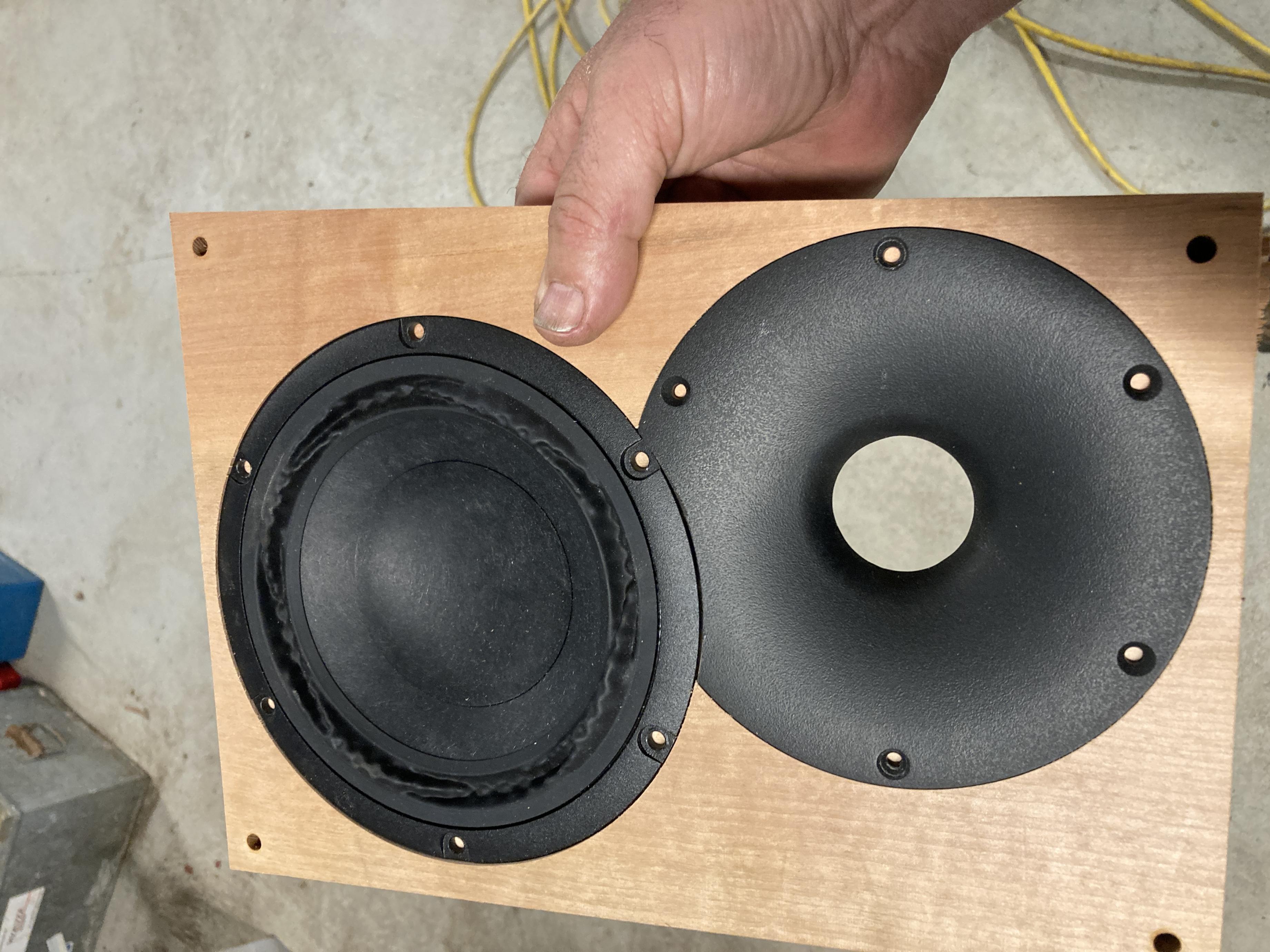

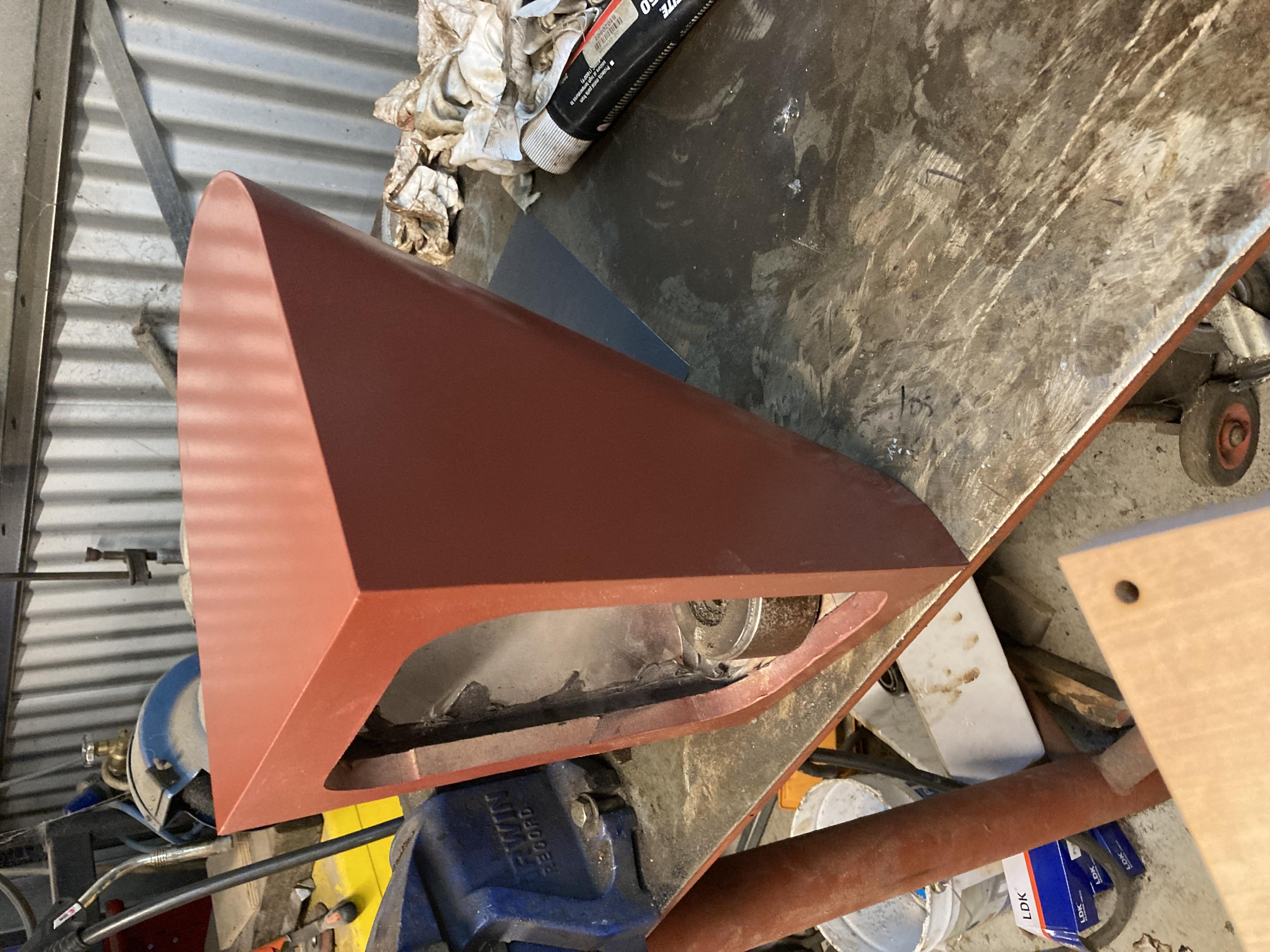

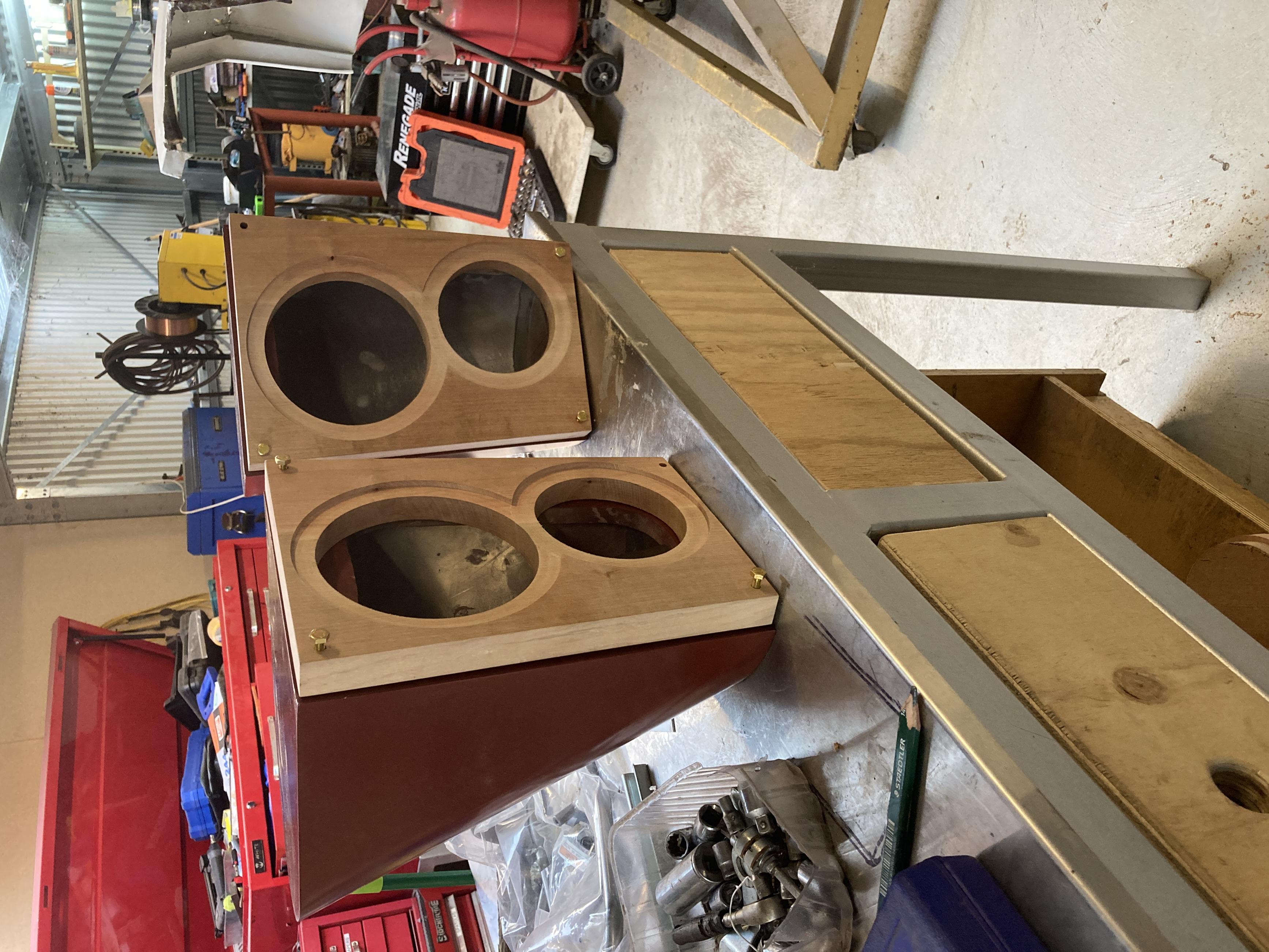

Thanks Norman, There is still a lot of tweaking.
I made them in a way I can bolt on various baffles as I have several tweeters to try. As the image shows my first baffles were not even asymmetric left and right as I was too lazy to draw two files and itching to try them so routed two lefts (I am lucky enough to have a CNC router so can easily nock up another iteration).
I also am fairly convinced that sealed subs will integrate better than my current ported subs. I am researching suitable drivers now and will build a similar rolled aluminium housing for them. Suggestions?
As you rightly say I am throwing away one of the highly valuable traits of this driver (its incredible extension) and I am not certain that I should not take it lower in a larger enclosure. However the ported experiments I first did resulted in certainly deeper bass, but nothing like the clean and tight sound I get in this small sealed enclosure.
Has anyone done any detailed modelling or experiments of various sealed volumes for these drivers?

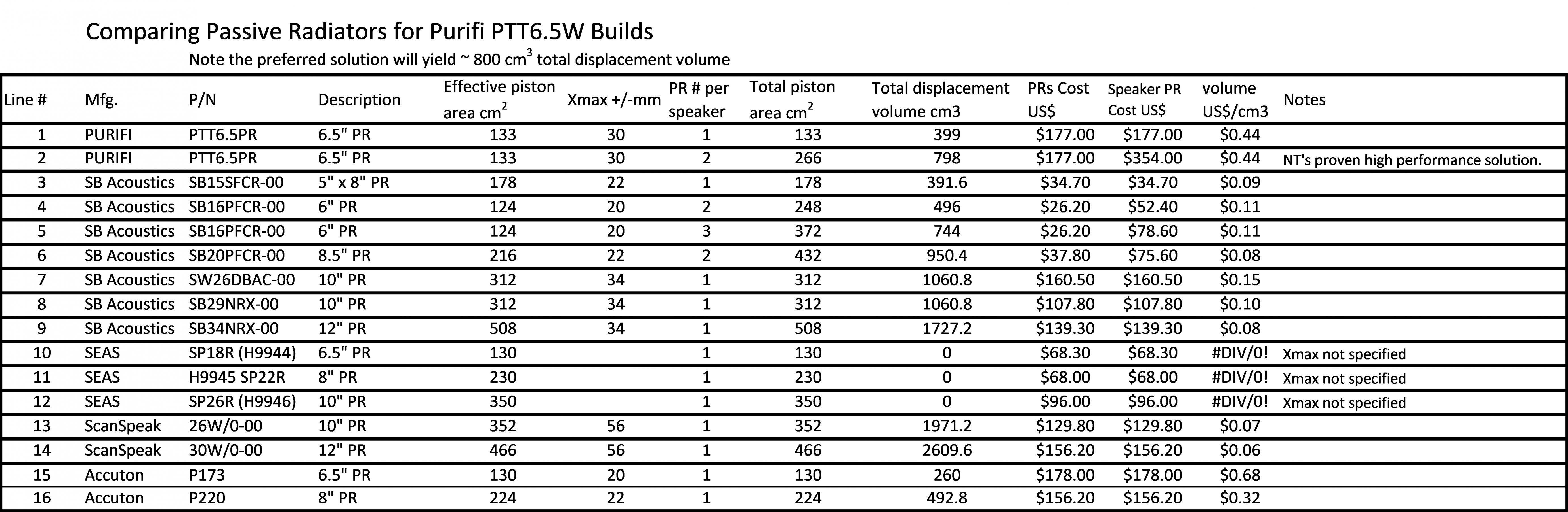

On PRs
just wonder why most people are thinking single passive radiator instead of using dual (e.gSB Acoustics SB16PFCR-00 ) ? is dual harder to implement when weight is taking into account ?
I think most ppl are actually using 2 PRs.
For my designs it comes down to cost vs. performance tradeoff with some styling and enclosure architecture considerations folded in.
The short answer is I believe for ultimate performance the revolutionary constant area surround and highly engineered soft parts make the PTT6.5PR worth the cost. Ideally a pair of them. In the Fi16v3 I am exploring a lower cost speaker featuring the PTT6.5W and therefore specified the SB 5” x 8” PR. A lesson in sometimes one has to build and listen because while the 5x8 is considerably down on displacement capability in the real world it is providing very satisfactory performance.
That summary should suffice, but then I went all spread sheet as seen in the attached image. These are the likely candidates from Madisound’s present stock. By considering the piston area and Xmax and number of PRs in a given box one sees the total displacement volume a given solution offers. All specs are manufacturers’ ratings. This reminds the maths (please think ‘maths’ with an English accent) count so larger Xmax helps and diameter increases really help thanks to radius getting squared in the area equation.
In the chart line 2 is my Fi16v1 and line 3 the Fi16v3. The 10x cost delta shows going all Purifi certainly exemplifies how in high-end HiFi the cost benefits curves can go exponential. Lines 4 & 5 show it takes 2 or 3 of the SB 6” to keep up. I find the solution on line 6 rather interesting, two of the SB 8.5” getting a lot of displacement for only $75.
Disclaimer – This spreadsheet focuses on achieving the desired displacement volume and the costs to get there. No effort made at this time to analyze the T/S parameters of PRs lines 4 – 16 to determine if they are suitable for use with Purifi PTT6.5W. That exercise, as professors like to say, is left to the student.
@Norman Tracy,
Continuing with professorial sayings. "That's a handy lemma you have there." Handy spread sheet that is.
One thing I'm not quite picking up is the significance of the PR XMAX. To my mind the max displacement of a PR, or multiple PRs can only equal that of the driver. With our PTT6.5 concerns, if we double the surface area, i.e. dual Purifi PRs, or a single 8" or 10", the PR cone travel will necessarily be reduced in proportion to the increased PR surface area. In other words, dual Purifi PRs will have their throw reduced by half. A balloon analogy comes to mind; take one filled balloon of a given size and force it to displace into a Tee connecting two empty balloons of the same size. Ensuring that the PRs XMAX can handle the unusual throw of the PTT6.5 makes sense to me. What you describe sounds more like PRs amounting to a larger surface area actually travelling the same distance as the driver. Or am I misinterpreting?
@mainframe99, thanks for the updated specs. I'll add them-
Haze Head commented “not quite picking up is the significance of the PR XMAX. To my mind the max displacement of a PR, or multiple PRs can only equal that of the driver”. This is not so much “misinterpreting” as not taking the analysis far enough.
The balloon analogy is correct at or near DC steady state case. The woofer + enclosure +PR or vent (when present) system operates as an AC system subjected to changing frequencies and amplitudes. As Thiele and Small led us to understand the dynamic behavior of our speaker’s bass system can be explored by analyzing the physical and electrical characteristics when subjected to a range of frequencies and amplitudes. Among those physical properties we find weights and springs. Weights of the cone assemblies and air in the enclosure. Springs including the cone assemblies’ surround and spider and air compressing in the enclosure. Such mass + spring systems exhibit a characteristic known as ‘reactance’ where they store energy at one point in time then release it at another. When the system is at a point the reactive store – release cycle happens very efficiently because the masses and springs involved are in greatest sympathy that is the resonance frequency (Fs) we so often refer to in woofer + enclosure system design. Recall that at Fs the spring forces (compressing air in enclosure + PRs or air mass in vent tube) are high and holding the woofer very tightly. Or more accurately exerting maximum force on the woofer opposing its movement. Also at Fs the reactive energy exchange is very efficient at pushing energy into the vent or PR(s). That is why at Fs the woofer’s cone is barely moving while the PR(s) are pumping in and out like mad or the air in the vent tube is rushing in/out at its maximum velocity. In the balloon analogy it’s a linear system with 1:1 ratio between balloons, with reactive effects in play the ratio becomes something like 1:2 at the worst case point of Fs. Thus the design guideline PR displacement ideally approximately twice that of woofer’s capability if one wants maximum output.
In my spreadsheet I calculated displacement (cone area x Xmax) to account for the actual mechanism doing the work. It is tempting to focus on just the cone area of the woofer vs PR but how much air each can move is related to both cone area and stroke. Look at various PR data sheets for long and one sees just like woofers they vary in Xmax quantity (and quality, harder to see in a data sheet) so a more complete analysis accounts for both.
Thank you for that elaboration, it makes sense. With audio related stuff I've learned to not be surprised about the complexities involved 😀
So it's something like a spring with an almost stored hysteresis like energy acting on it. The fact that a PR system is sealed puts me, incorrectly, into a hydraulic system mindset. However, air being so compressible/vacuable??? is basically allowing for the PR to act as if punched with greater energy than the basic displacement would have done. Not sure if that is quite inline with the phenomenon you describe, but at the very least I can see reasons for the PR being more energetic. And come to think of it, the few PRs I've seen in action did really boogie.

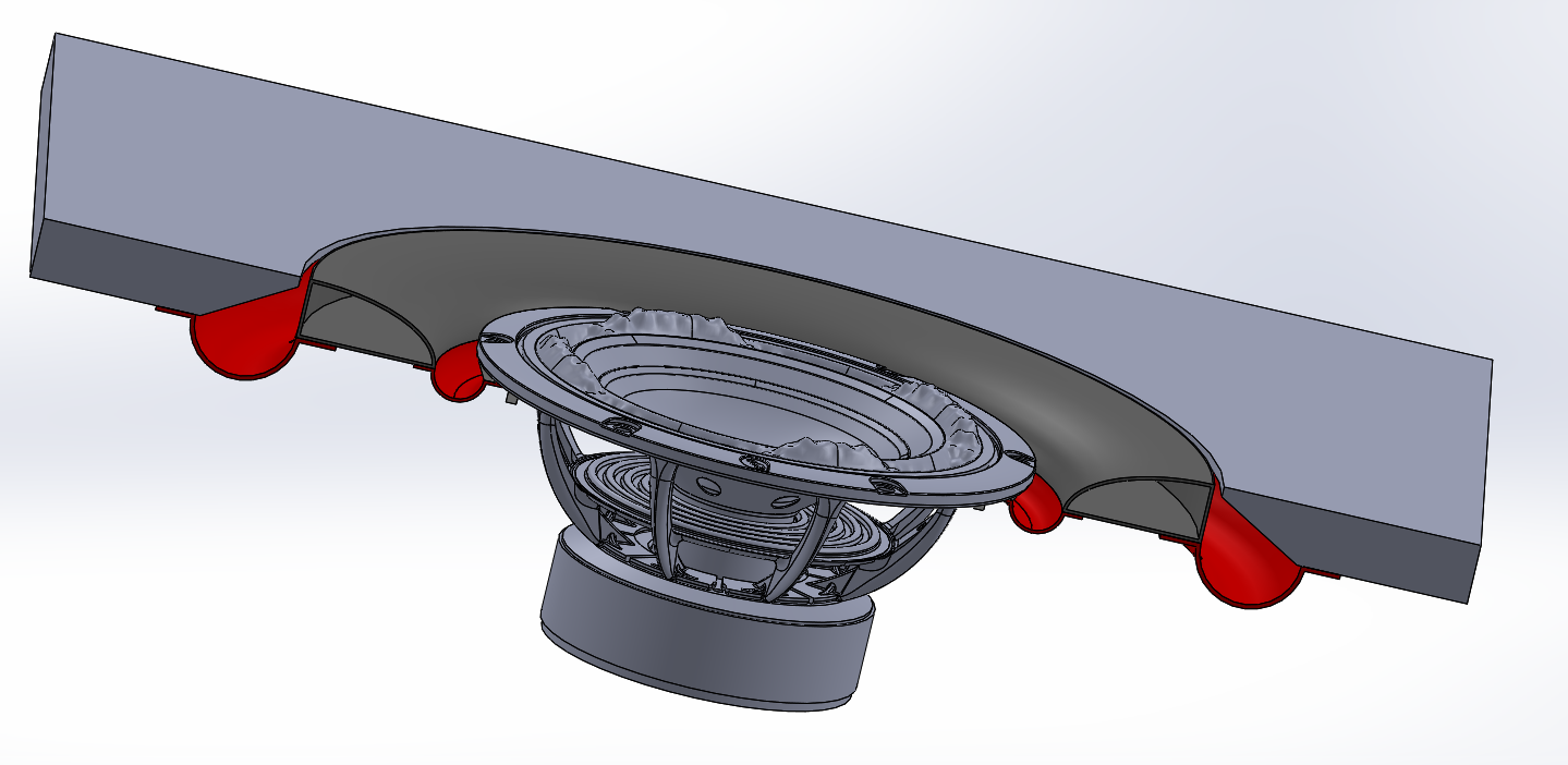

I had been contemplating doing a custom PR fabrication that would integrate with the rear panel. More in depth PR discussions on this thread inspired further ideas about a front baffle PR; of course now I can see that the XMAX variable may create some problems for the concept. Back to the o'l drawing computer--but trying stuff is half the fun anyway-
Concentric PR Concept
Here's the idea I was playing around with. The driver is actually suspended via a basket to the baffle, similar to how the speaker's own basket looks. I left that out for a simpler view of what I want to do. There are probably a number of reasons against such a configuration, but there also appear, at least on the surface, to be solutions for most issues I'm aware of. Admittedly there is more that I am unaware of than aware of. The driver can be internally baffled if that is required. Spider suspension can be employed if that matters, and so on. The surrounds could be flipped upright and because I'm considering polyethyl, it should be diffraction friendly. The mass is highly controllable, anywhere from very light to what ever mass is preferred. Then again, I've not seen this done so maybe there is some unwritten rule about why....

Wow Haze Head, that is a truly different idea.
I feel the same as Norman, part see's it as 'simply going to waste a heap of the drivers energy' and part 'this could be really effective'. The physics are a bit above my knowledge so I will be following others thoughts and your experiments with interest.
I also wonder if you should have some IP protection quickly just in case you've cracked the 'long driver mounting stroke code'.
Now comes that moment of confession that I didn't model the PTT driver lol! You can download it from Purifi, fyi. I'm both happily and painfully aware of this as I'd already spent many an hour modeling that surround and even have it available for download on the software forum. Solidworks and in the case of organic shapes a plugin called Powersurfacing are the modeling tools and I render in Keyshot.
Facing your prognosis of a concentric PR build, I'll have to weigh some options about how to proceed. One thing I really liked is the ability to stay very compact without a rear firing PR, and hence no wall proximity issues. Also, having learned of your out of phase/distance trouble, it seemed reasonable that direct alignment would be the most uniform position as far as how direct the suspension is loaded.
The Magico A1 is a reference for where I want to get in terms of build execution, so I have done a fair amount of modeling and comparing of that piece.
As to the patent.... nah, It's now safely in the world of prior art for us open sourcers 😉 If only it would do what's intended of it, but that's a whole different deal. It may be the perfect frisbee?
EDIT: I also added the original version with flat PR cone and upward facing surround for a sense of the many ways this can be configured.
Thanks, Onslo! No worries, it's officially prior art now and I deem it to be open source for diy.
It sounds like you are thinking that the Purifi is sort of free floating, hence loosing energy. But it is actually attached to the baffle that bridges across the PR ring, so it stays in position as any typical driver would. In theory lol.
Ahhh now I understand.
Yes I see that working. Is cancellation more of an issue with 'short circuiting' occurring or I suppose the dampening will minimise that to a certain frequency too?
I love to see some out of the box thinking.
I reckon it can be internally baffled as any other build would. The Driver can be in its own walled off tube until it reaches the rear and reflects back. The box is so narrow that you can maybe squeeze in one more reflection off the front again, and back before physically reaching the radiator. But I don't understand much of the sonic 'dark arts' and am more of a builder. In this case a concentric PR solves a lot of problems for me, like being compact, tidy, novel, etc. Making it worthy sound wise is rather a shot in the dark from my purview.
