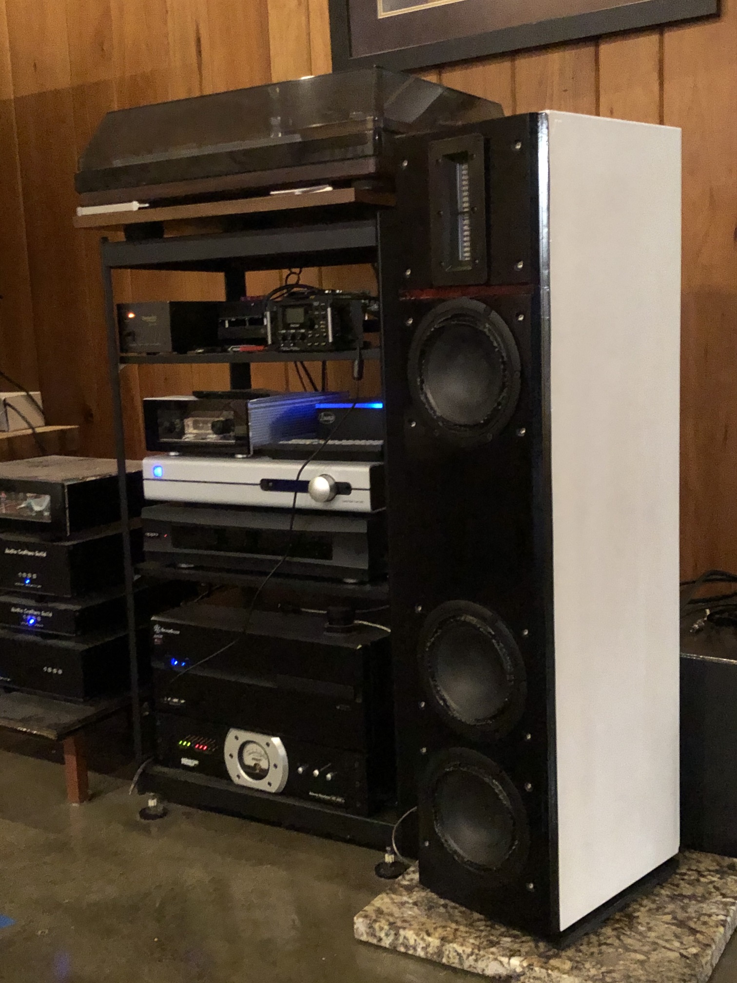

Fi25v1 Enclosure Build

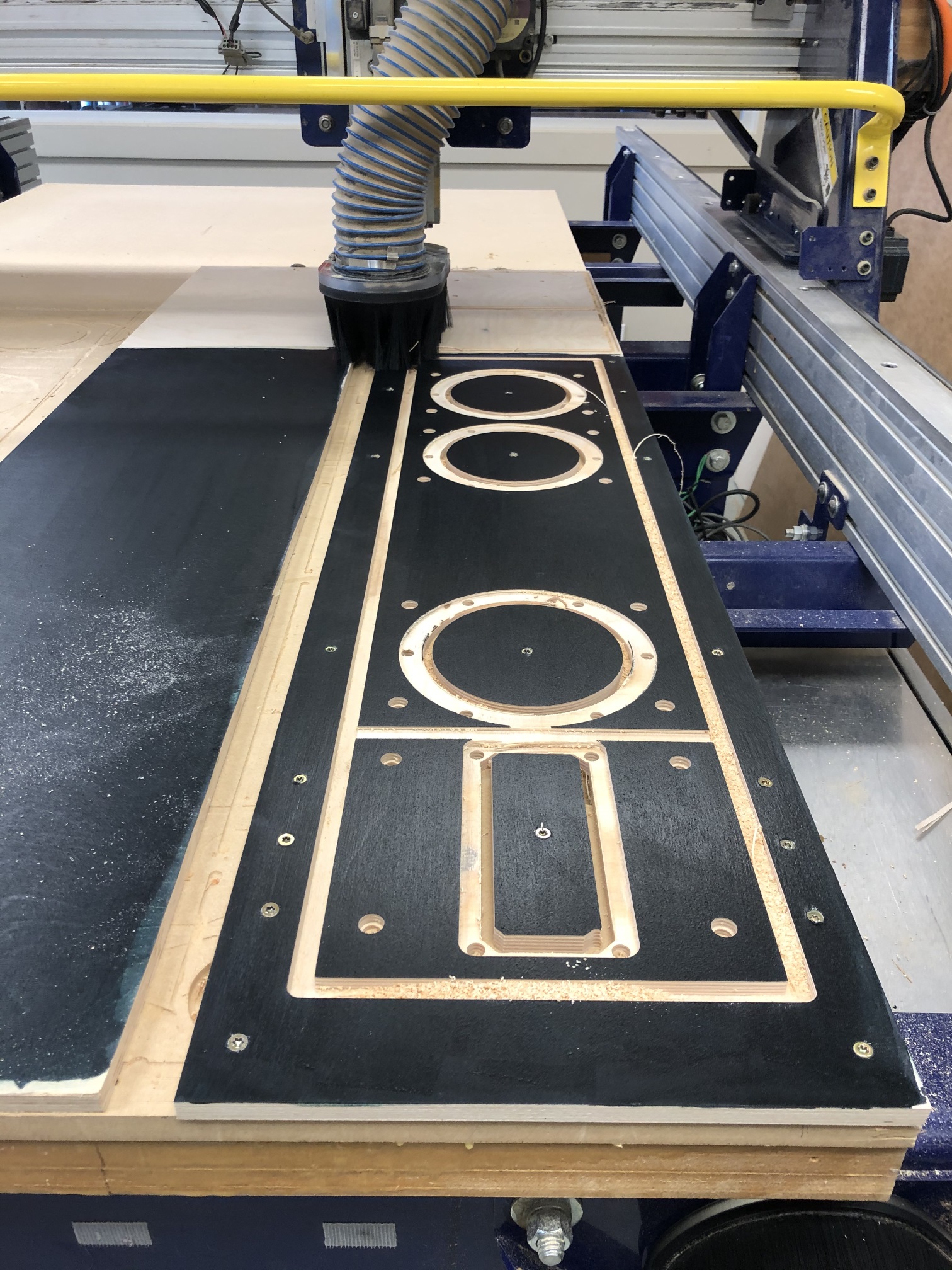

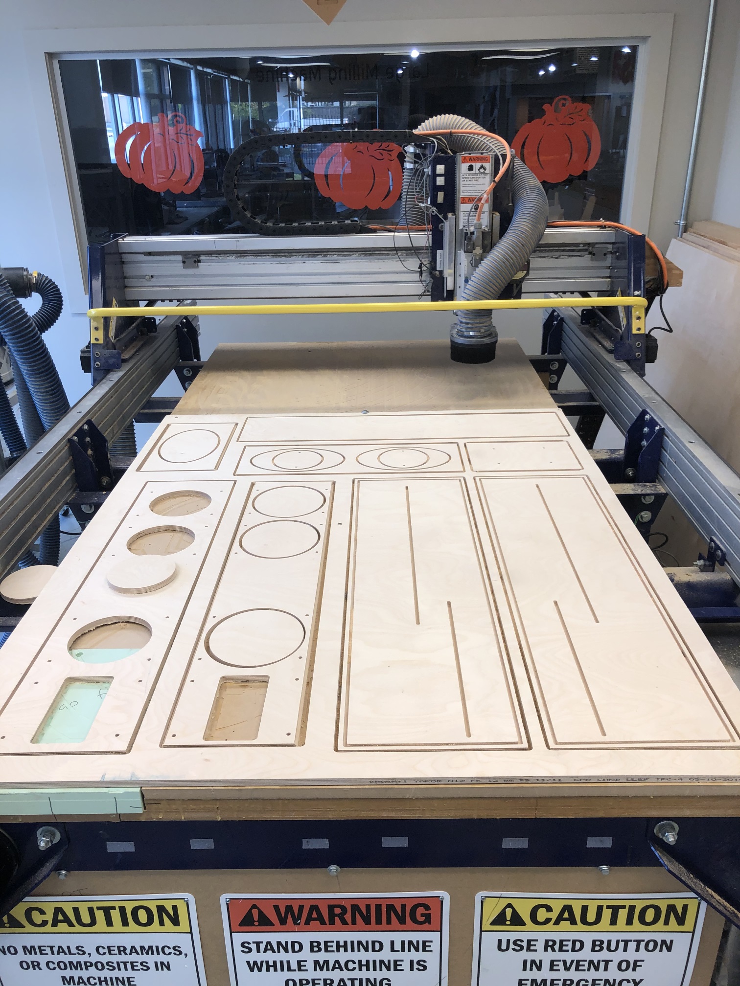

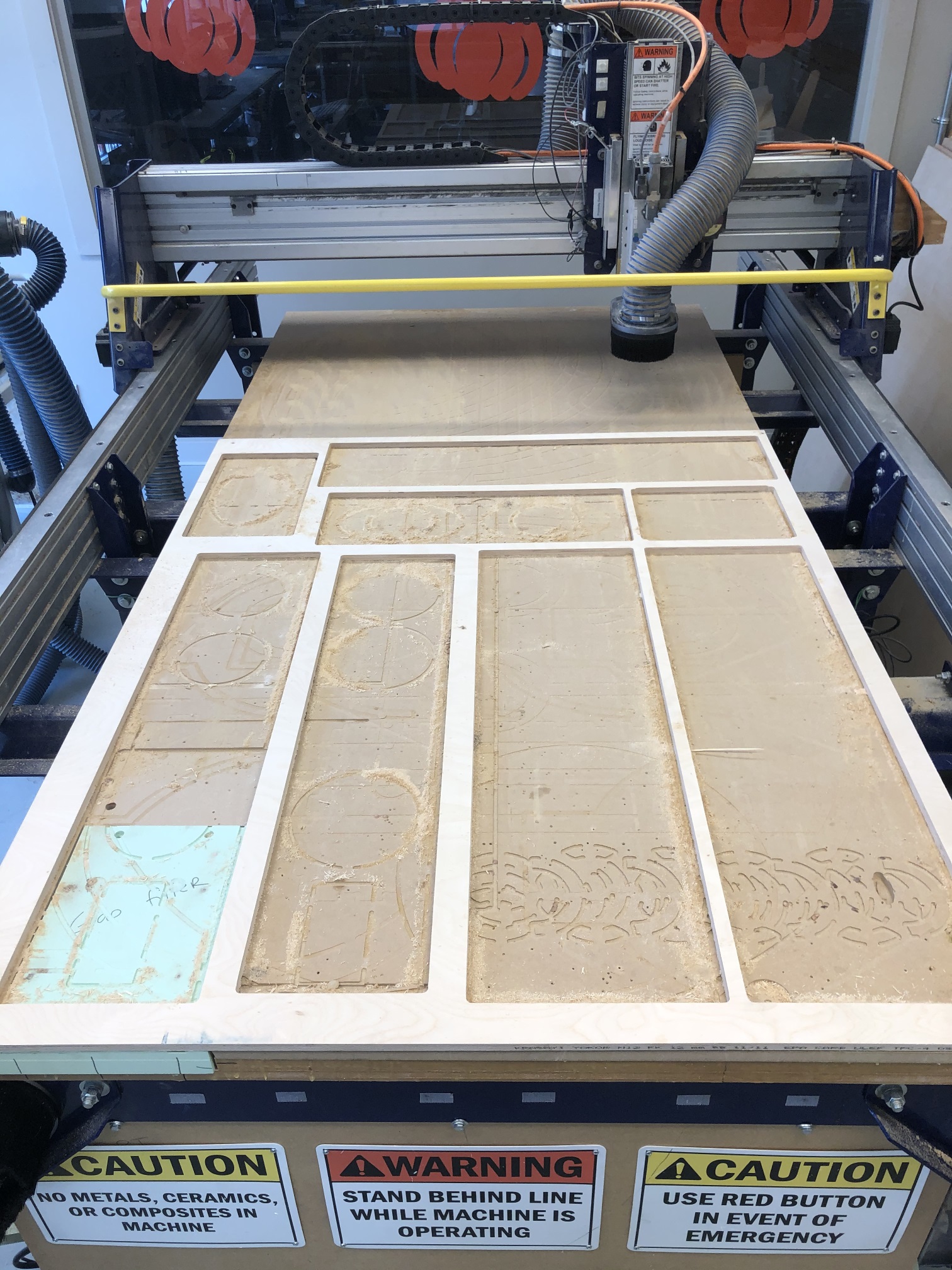

Panels’ CAD design was optimized for tongue and groove construction and CNC machining. Panels cut on Tulsa FabLab’s ShopBot.
Box and base components.
Careful dimension selections and layout yields low scrap costs.

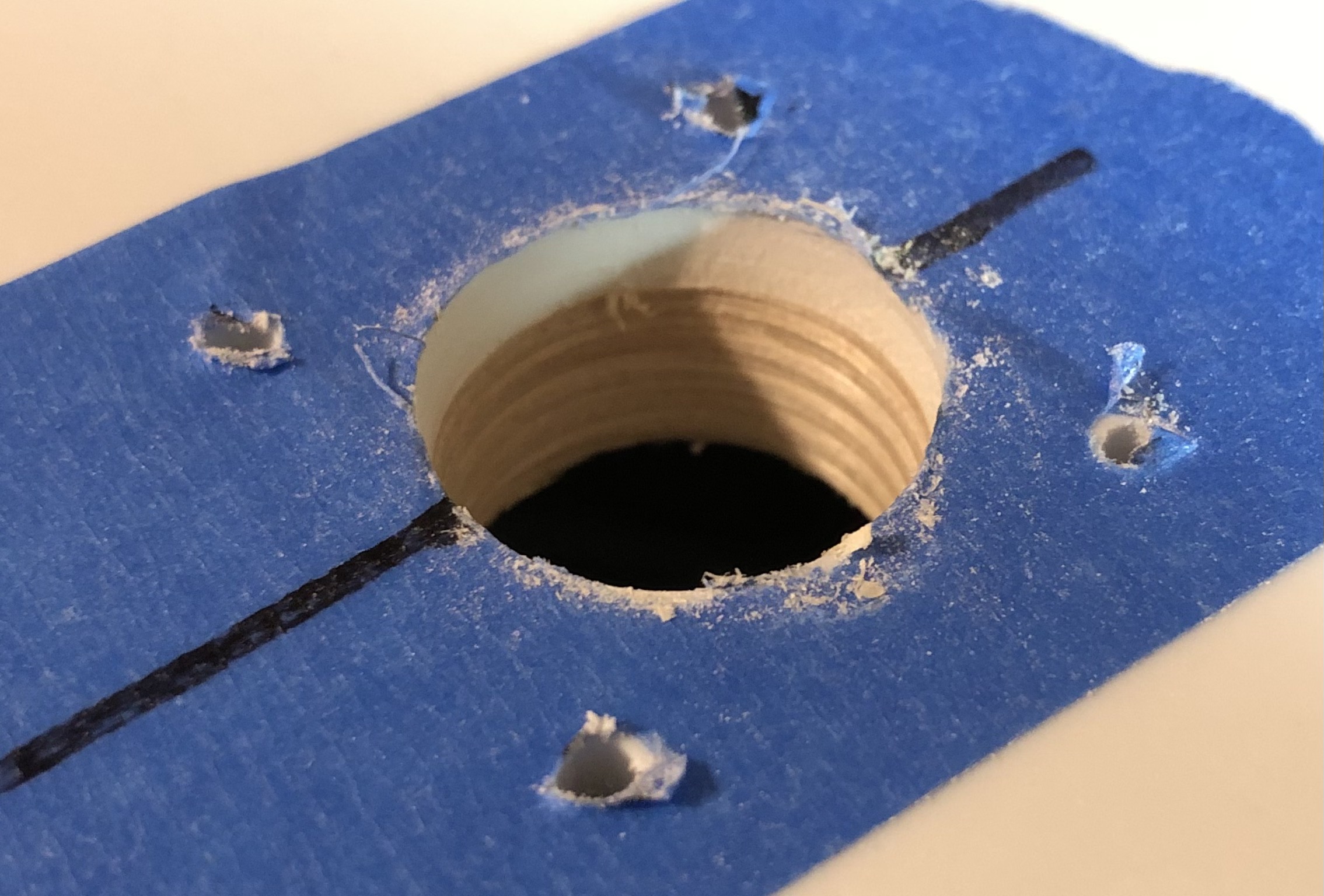

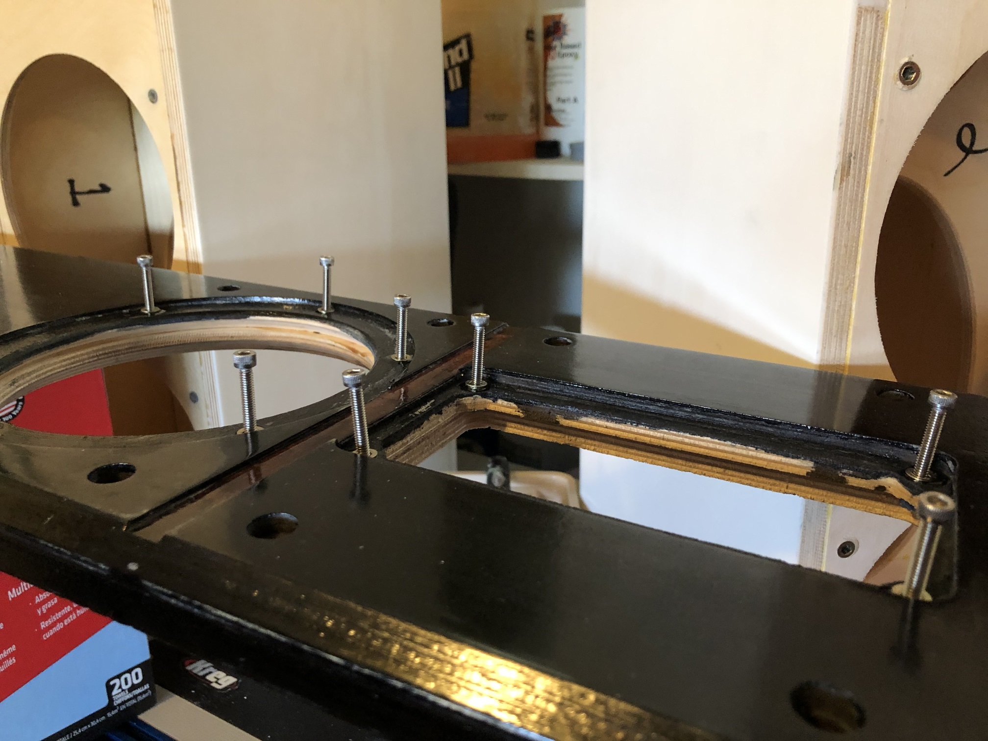

Double layer thick front baffle. Pre painted and sealed panel experiment looking to minimize tear out.
This close-up of the baffle also shows the 38 holes used for the driver and baffle mounting screws. All mounting screws are stainless Allen head machine screws into brass inserts.
Detail of tongue and groove via CNC.

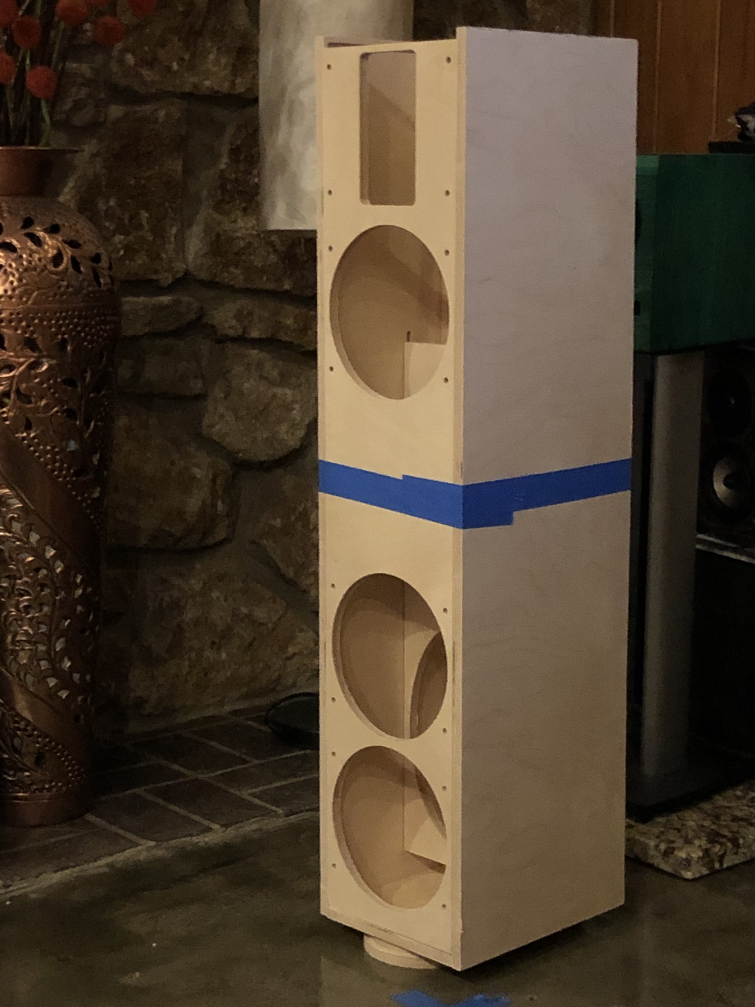

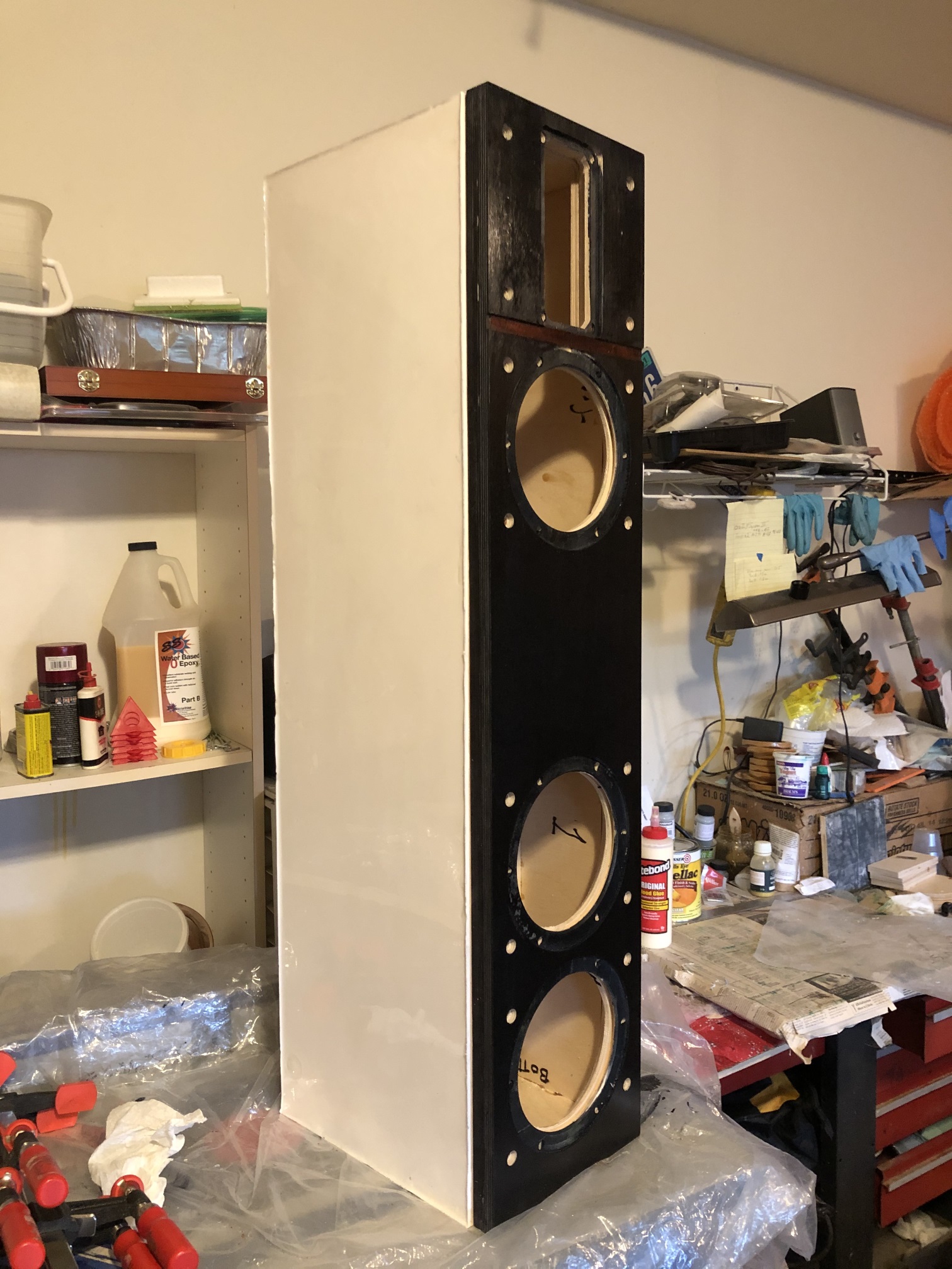

Thanks to tongue and groove build a little masking tape holds the box together for a first look at proportions in the listening room. Top and front baffle not yet cut at this point.
Fi25v1 Enclosure Finishing
The finishing turned into one of those rabbit holes so deep once fallen into (or after jumping headfirst) one can enjoy a nice long existential philosophical conversation with Alice and The Rabbit as we fall and fall and fall. Years of experiments in epoxy finishing led to using pourable epoxy dyed white to cover the sides, top, bottom, and back in a layer up to ¼” thick. Quoting Dickens’ literary classic applied to finishing rather than revolutions, “it was best of times, it was the worst of times”.
Detail of Speakon connector hole showing epoxy over Birchply construction.
Poured epoxy is a time consuming process, with the epoxy I was using each pour requiring 12-24 hours curing time. After the enclosures’ wood build steps are finished a series of epoxy pours are conduced. Six different pours were planned to epoxy the sides, top, bottom, and backs of the two boxes, front baffles to receive a more conventional finish. This grew to more like ten pours as sides required added build thickness, and for one side a cure failure disaster recovery. Each pour started with the box on a level worktable the edges taped with blue masking tape to form a dam to contain the epoxy. It is important the tape be well adhered or epoxy will leak. Also critical to be very level or the finish will vary in thickness. Should I to ever return to this technique I would add clamped dams backing up the tape and means to better gauge epoxy depth. The uncured epoxy has the viscosity of pancake syrup so it wants to leak and if not thick enough due ti insufficient quantity poured will fail to self-level. If there is interest we can go into more detail in other posts. Once all sides are cured using a router table and flush trim pattern following bit the edges are trimmed. The best part of this finish is how it machines as seen in the photo below. Then a 500 grit disk on random orbit sander took it to exactly the matt finish I had in mind.
Fi25v1 enclosure with epoxy prior to trimming and sanding.
Test fitting baffle to enclosure after epoxy pours are completed. At this stage the enclosure is encased in epoxy. Next steps edge trimming pours and finish sanding remain.

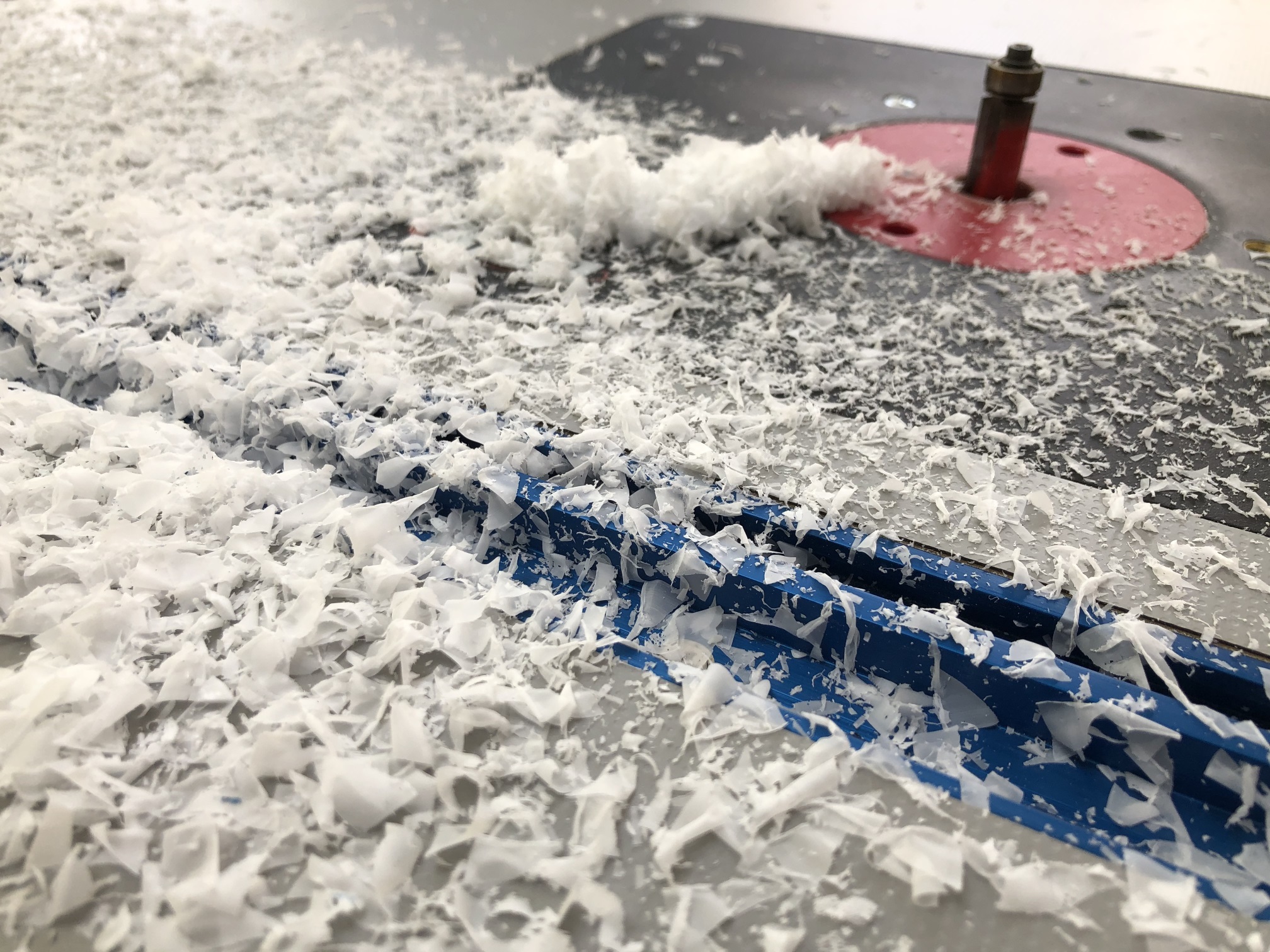

Making chips during the trim and sanding phase.
Pattern following router bit used to trim and flatten panels after which sanding further refine surface and defines the matte finish.
Installing driver threaded inserts, waxed bolts used to keep epoxy off threads.
Fi25v1 completed and ready to audition.

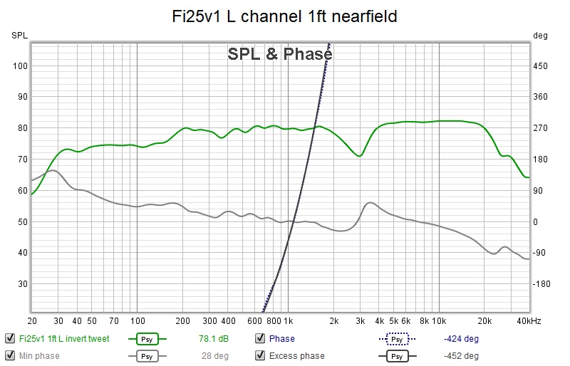

Fi25v1 Measurements

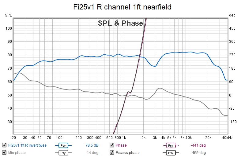

Measurements were made with B&K 4004 microphones, E-MU 0404 ADC @ 96k/24bits, and REW software running on WIN10. As a relatively new REW user I mistakenly left all the phase displays turned on in the following graphs on. The amplitude vs. frequency graphs is in each case the top trace.
The first two graphs show near field responses taken 1 foot in front of each Fi25v1 speaker with microphone at tweeter height. The simple 24dB/octive electronic crossover at 3k Hz needs some work as evidenced by the dip at 3k. Above that the NEO CD2.0 tweeter is so smooth. Below crossover the PTT6.5 woofer is also smooth extends to 30 Hz. I wonder if the step down below 200 Hz is the extended bass shelf response or just a measurement artifact?

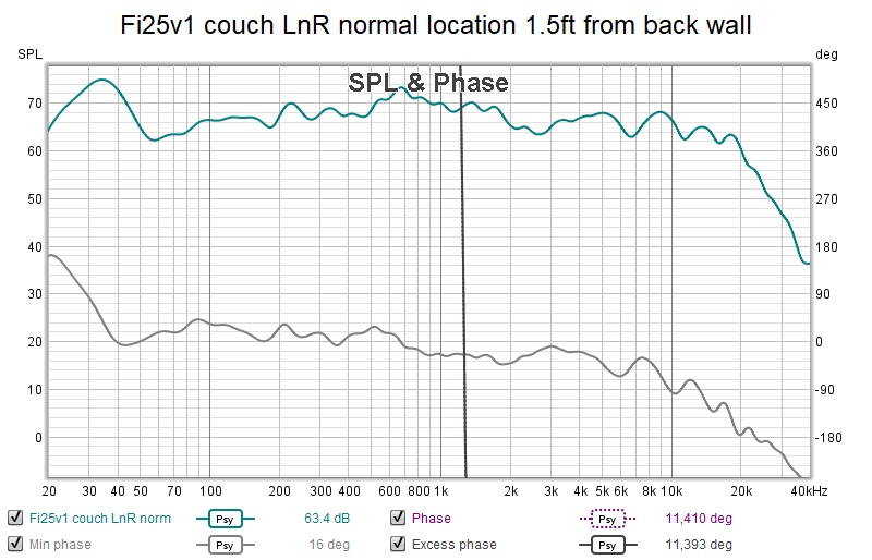

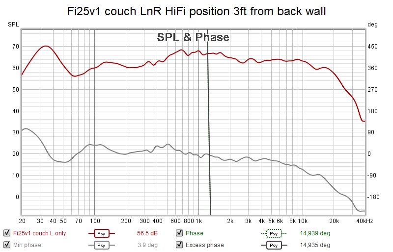

The two ‘couch’ response graphs are room response graphs taken at the listening position a couch which sites the listener 3 feet from the back wall and 15 feet from the speakers. With room gain and modes included its apparent how much energy the PTT6.5 woofer and passive radiators can pump into my room.
Fi25v1 Listening
The audible success of the Fi16v1 led to the commitment of resources into the Fi25v1 tower build. As the saying goes the proof of the pudding is in the eating, our corollary here the proof of the speaker the listening. By that criteria Fi25 is a success. As of writing this project report many 10s even 100s of hours of listening by myself and friends yielded unanimous praise. The audible transparency Purifi brings to the game is now a given in my listening room, this holds for both the 16L and 25L configurations. Like the Fi16 the Fi25s reset bass performance yielding in these décor friendly compact sizes the effortless slam and extension one normally associates with 12” or 15” drivers in refrigerator sized enclosures. I will be honest with my friends here on diyaudio.com that any hoped for ‘awsome’ stepwise decent into massive subbass did not materialize. Comparing the 16 liter vs. 25 liter enclosures one is hard pressed to notice the larger enclosure as presently configured adding to the already state of the art bass depth, low distortion, dynamic linearity and ‘startle factor’ Purifi brings to the party.
Testing with sine waves also reveals a liability the 25L tower enclosure brings the 16L boxes avoid. At 20 Hz the dual passive radiators go out of phase with each other. It is rather alarming watching as one is clearing moving forward and the other backwards each with several mm amplitude. Of course power handling plummets as the active driver finds itself unloaded by the enclosure system. Physics can be a bitch. Despite massive market popularity of slender tower enclosures they do behave like organ pipes. At 20 Hz the wavelength is 17 METERS(!) vs the 95 cm of this box. So rather than a fully developed wave (which does not fit in the box) one gets pressure pulses rolling down from the active driver to the pair of passive radiators. These pressure pulses encounter the radiators at different times so at some frequencies they can go out of phase. Loop back to the conceptual phase of my design and placing the active driver and radiators all on the front of the baffle was part of the industrial design process. If one is spending the bucks on these units have them on show is the thinking. And personally for causal listening in my room the speakers are moved closer to the back wall so all active drivers on the front seemed like a good idea.
The interesting, at least to me its interesting, finding is with music as source with purely subjective listening this liability is not noticed. Only when stepping or sweeping through pure sine waves does it become suddenly quite apparent.
The present conclusion is when using PTT6.5W with 2 each PTT6.5PR passive radiators I will suggest sticking with enclosure sizes in the 15-16L range. The 25L experiment / journey tended to confirm smaller in this case is better, a Fi16v3 variant is completed and ready to share shortly. I may well return to the 25L box replacing the PRs with ports to explore if one port avoids the position effects the dual PRs suffered as pressure pulses traverse a tower shaped box. Any Fi25v2 is queued up behind several other projects that in my judgement offer better chances for moving the HiFi performance and musical enjoyment obtained with Purifi drivers to an even higher state of the art. The other good news is while exploring these sometimes esoteric paths the basic 15 to 16 liter two way remains so fracking good.

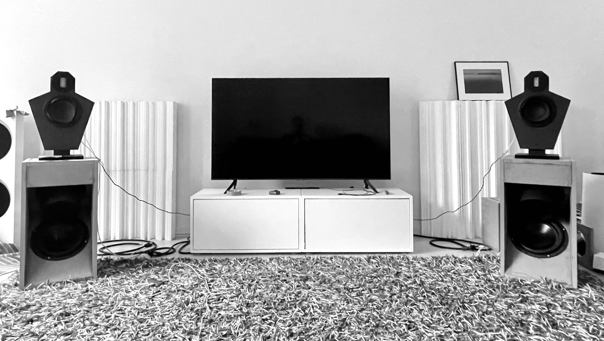

Purifi - The Bat Open Baffle Edition
During my build process of Purifi SPK5 using the excellent Viawave GRT145 ribbon tweeter I had to try the Purifi 6.5" and Viawave tweeter in an open baffle together with the Linkwitz LXsub (for my LX521.4 build...)
Crossover is LR24 @2.0kHz.
Reactions: 1 user
