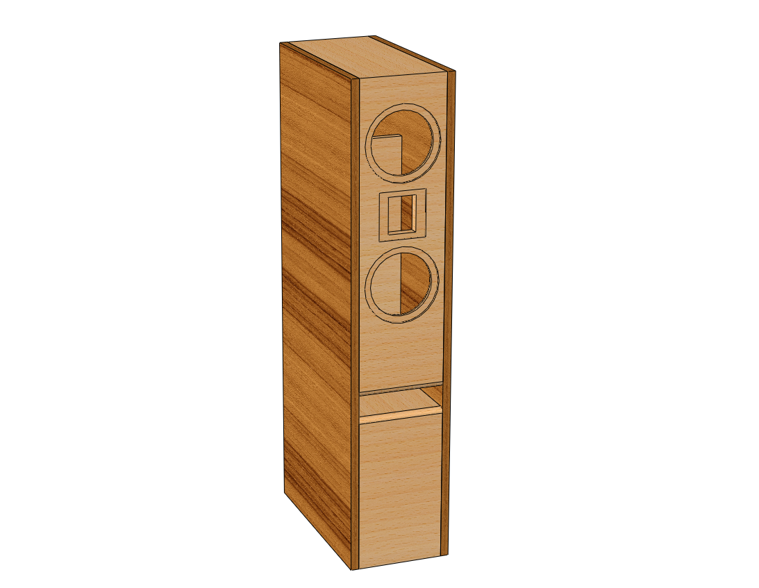

I used to think the same thing and used a sealed 24L box for my 10F/RS225-8 quasi-transient perfect 2-way for years. I then explored the PMC style tapered TL with Akabak modeling that accounted for variable damping placement. The addition of proper damping in the modeling allows one to optimize the bass extension AND the group delay. A sealed woofer has about 4ms of GD at 50Hz (important kick drum frequency). A lightly stuffed TL or simple 4th order bass reflex or passive radiator alignment has about 15ms of GD at 50Hz. This is the so called “sloppy bass” timing we all know well. But when a tapered TL is properly stuffed and damping foam is applied in the right areas, the GD of the TL approaches the GD of a sealed cabinet. This was explored in my PMC style inspired TL in this thread. From that result, I explored making a TL version of the 10F/RS225 speaker and the result was breathtaking. The tightness of the kick drum bass was still there and the bass extension was deepened. Now I don’t even use a separate subwoofer anymore as it reaches below 30Hz. The other advantage seems to be an openness and higher level of mid bass clarity afforded by letting the woofer breathe easily rather than deal with all that compression of a sealed alignment. I compared the sealed and the TL side by side. The TL still has the tight bass.
Here is the sealed and TL version of the same speaker:
Here is an example of the wall lining and stuffing used to achieve the right balance of bass extension and lower GD:

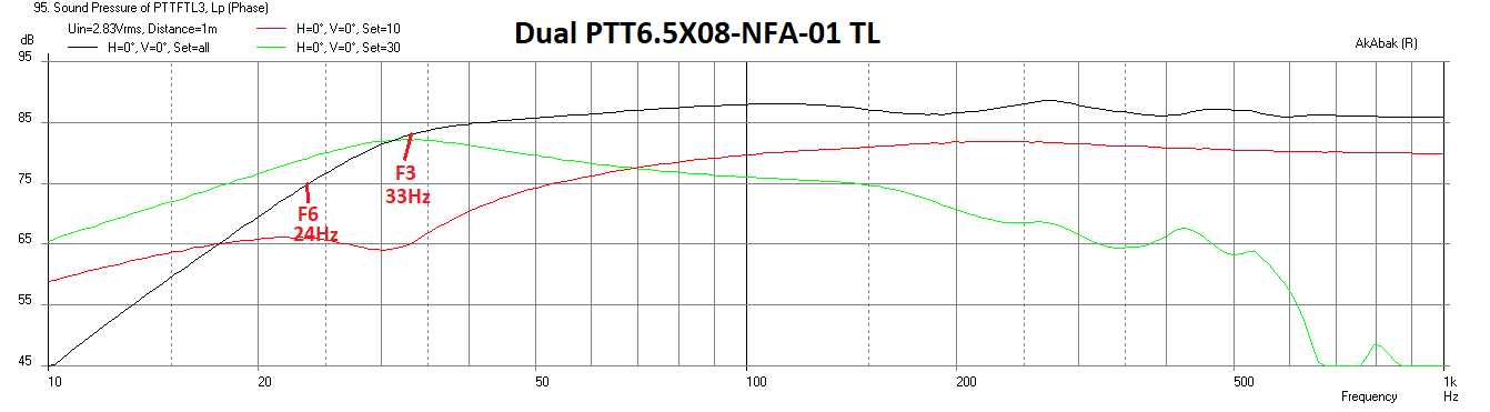

Take for example, the design of a WTW double driver TL design I just recently developed. With the “W” variant, I was getting 86dB sensitivity and 36Hz F3, 28Hz F6. Simply putting the “X” variety into the simulation, I got 33Hz F3 and 24Hz F6. Still 86dB and the same nice flat bandwidth. That’s a big difference.
Here is the sim results die the frequency response:

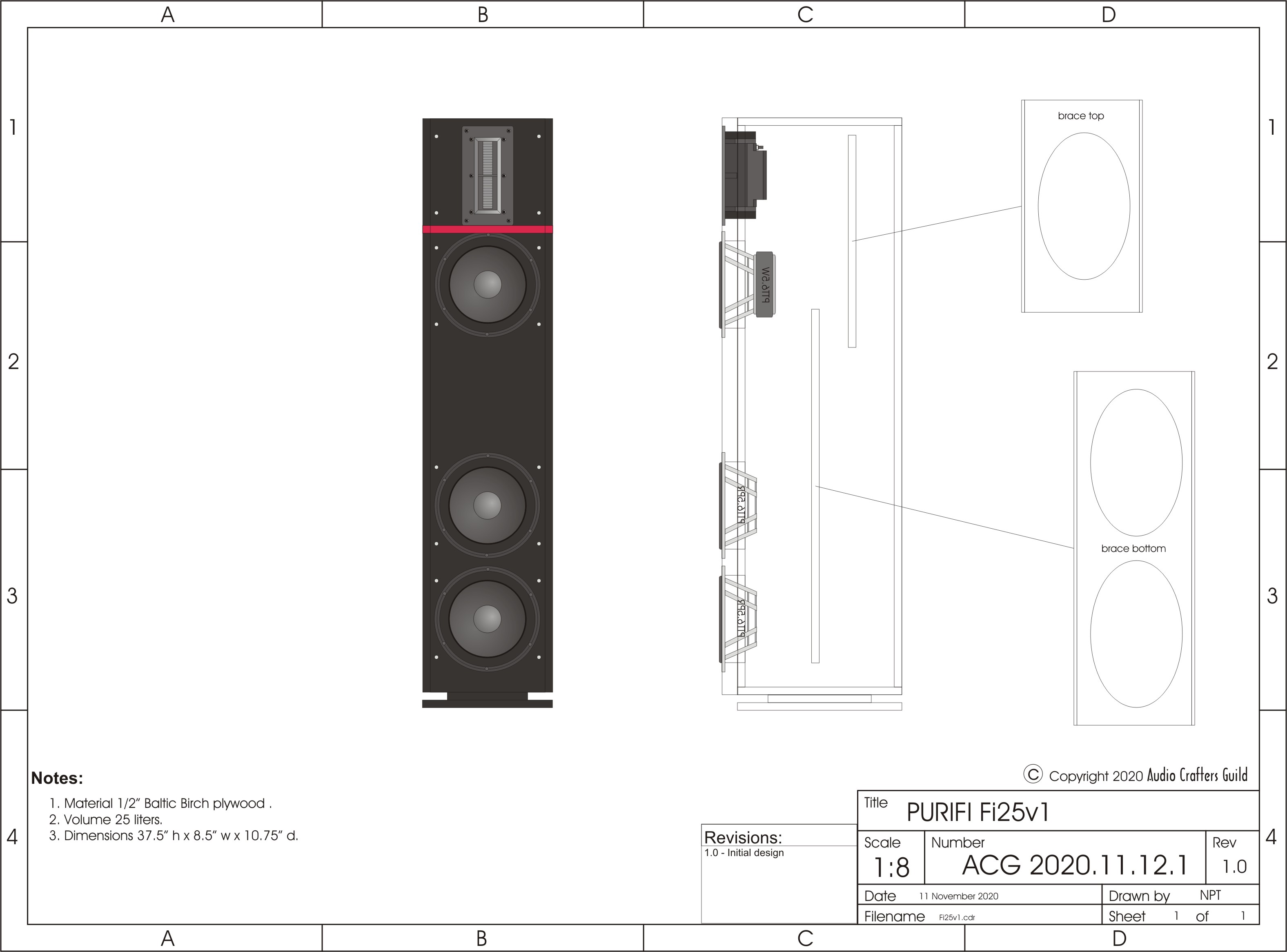

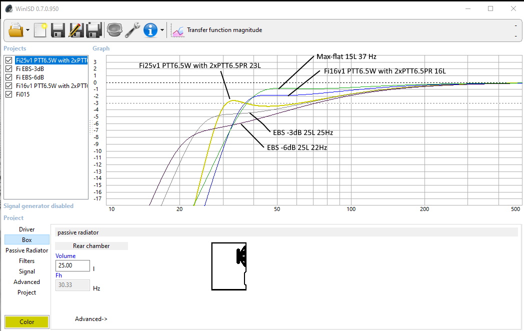

Fi25v1 CAD simulations
Fi16v1 is a stand mounted monitor so the next logical step seemed to be exploring the floor standing option. Pleased with the proportions of Fi16v1 I explored the oft cited “replace the stand with more speaker box” option. Thus retaining the 8.5 inch width and 10.75 inch width and height extended to 37.5 inches yields an enclosure volume of approximately 25 liters. Yes, in American design we constantly mix imperial and metric units, in centimeters that’s 21.6 cm W x 27.3 D x 95.25 tall. With the 25L volume in mind woofer/box alignment simulations in WinISD explore how the PTT6.5W reacts to various enclosure volumes, something to look into before the sawdust starts to fly. The following graph shows five possibilities.
The green curve labeled ‘Max flat 15L 37 Hz’ is I believe essentially the Purifi SPK5 application note design (Tech. - PURIFI). As the label notes this is a 15L box tuned to 37 Hz via a port tube these numbers yielding the so called maximally flat alignment with response to –3dB at about 37 Hz.
Next the blue curve labeled ‘Fi16v1 PTT6.5W with 2xPTT6.5PR 16L’ shows added enclosure volume and lowering tuning Hz does not get more flat amplitude bass extension. The added liter of volume and lowering tuning from 37 Hz to 19 Hz lowers the 40 Hz to 80 Hz response by ~1 dB with only inconsequential change in the -3 dB point. Note in this and subsequent designs using PTT6.5PR passive radiators the 19 Hz tuning is the default of these PR’s thus becoming a given in the design. More typical of PRs in this size class is a default tuning in the 30s with option to lower with added weights. To date Purifi has been silent on why they chose 19 Hz as a default, these design experiences lead me to believe they know what they are doing. This 16L/19Hz alignment is a benchmark as I have many weeks enjoying this design in my system. An experience leading to the opinion the 1 dB drop in response CAD predicted when buried in room gain is overshowed by aspects like the PTT6.5W’s resetting of distortion standards. Now onto the larger enclosure volume alignments.
The two purple and grey curves labeled ‘EBS -3dB 25L 25Hz’ and ‘EBS -3dB 25L 22Hz’ are default alignments that can be selected in WinISD. These Extended Bass Shelf alignments look to reach deeper cutoffs using larger enclosure volumes and lower Hz port/PR tunings. For this low bass extension one trades off response flatness and power handling.
And finally the yellow curve ‘Fi25v1 PTT6.5W with 2xPTT6.5PR 23L’ illustrates what happens in CAD when the 16 liter box is increased to 23 liters. Not as much ‘shelf’ as the EBS alignments rather we see extra output in the 30 to 35 Hz band at the expense of another dB loss between 50 to 100 Hz. This curve certainly illustrates that when the drivers (and here passive radiators) T/S parameters remain fixed more enclosure volume over the max flat optimum yields questionable or shall we say interesting results.
An interesting question I set out to answer curious how those response changes would interact with room acoustics’ low frequency gain. And no doubt slanted by really wanting a slim Euro style floor stander with Purifi drive units. Detailed out the design looked like the drawing.
With its 25 liter enclosed volume this design was named F25v1. Like the stand mount Fi16v1 the woofer is a Purifi PTT6.5W-04, 2 each PT6.5W passive radiators and the tweeter a Fountek NeoCD2.0. The crossover is at line level based on Marchand Electronics PCBs with bi-amping power from ACG 1000 series amplifiers. Moving crossover to more conventional power level Ls and Cs awaits the basic design proving itself.
